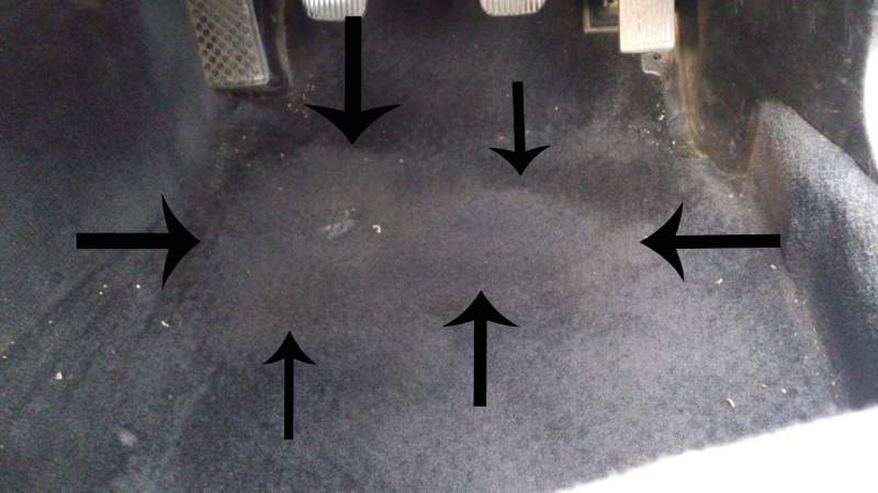

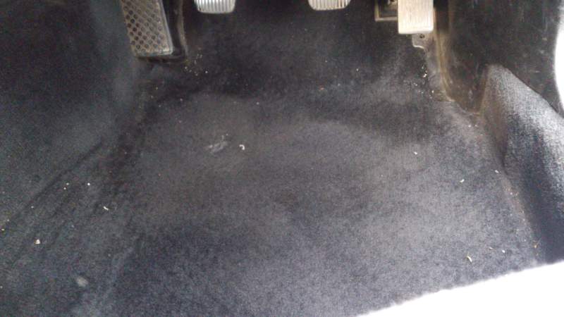

been meaning to post this for a few days now. i lost my phone in the z and couldnt find so after a stuggle and search i took the matts out and on the driver side i felt that carpet was damp. it wasnt soaking with water and there wasn't any order. but when i rubbed my hand into it did have a funky smell but ive never noticed it. i dont understand who what where when why and how its gotten damp. i havent spilt anything. it hasn't rained hard. but the sun was out when i noticed it. i did have the under carriage washed on the 20th of last month. im thinking maybe that is the reason. but from then till now still damp? i dont drive it when it rains and really only had it on the road mainly last week when the sun was strong enough for me to get my tan on! and the amount of heat that comes into the cabin surely if it did get through shouldnt it have dried up?
wonder if anyone else had or has this problem? i didnt notice any holes or cracks when the car was on the ramp. any ideas fells?

perhaps silly question, so the heater core bypass does that mean no more heating? matrix? im not going to find morpheous offering me a blue and red pill under the carpet am i? loll i haven't the slightest clue what and where to begin. a link to a how to check would be appreciated. ill be doing my reaserch also.
and most importantly is it something that could possibly wait maybe? i dont know the extent of the repair nor time it will take to fix etc but i am planing on coming down to japfest with my z and i dont want to have to leave her behind, heres a pic
gracias amigos!!
if it smells funny, its likely to be antifreeze, which points to heater matrix.
if it's the matrix you will be losing coolant from your rad.
and correct.. no matrix.. no heat in cabin... Ok in summer but in winter you will know about it!!!
the bypass is done by either capping or joining the two pipes at the back (top) of the engine together..
the bypass cant' wait... but the matrix replacement can....
HOWEVER firstly make sure that is what it is!!!!!

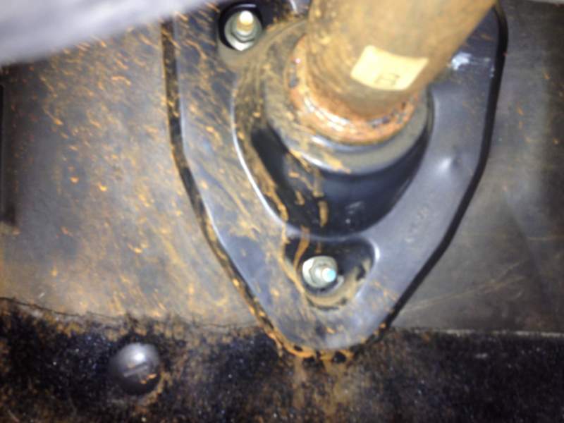

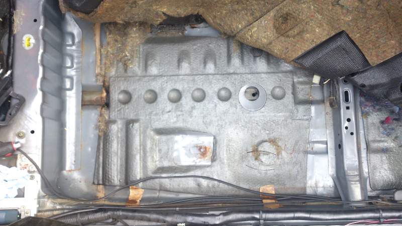

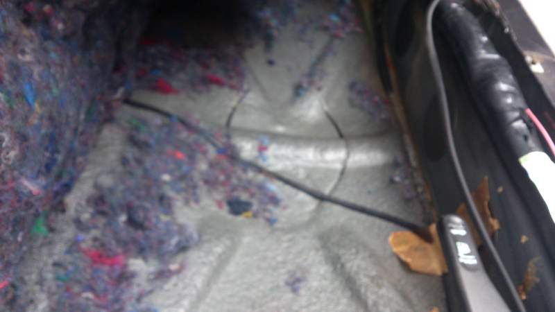

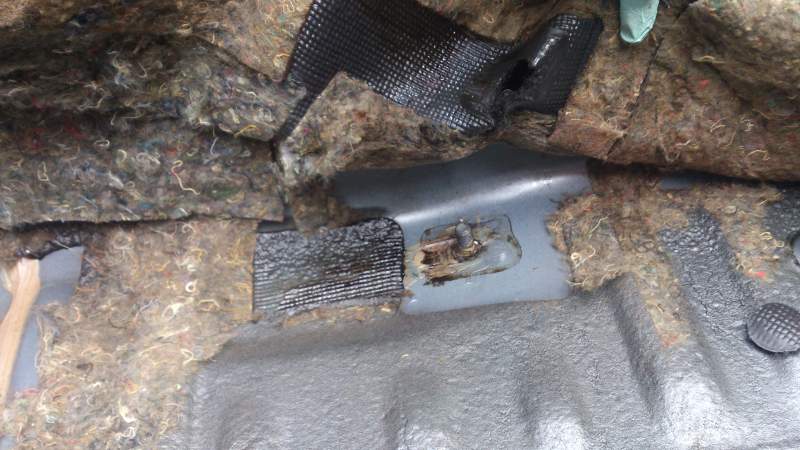

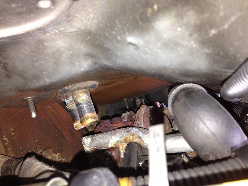

right seat out, carpet up. had a look and apart from finding a small amount of what looked like oil on the screw that hold the seat frame down i didn't see anything too concerning thankfully no rot or rust! yay! but as i looked at the firewall, the cover that sits over it at the bottom was damp which i believe is the where the fluid/water etc is coming from. the round rubber seal more to the right didn't have any corrosion or signs of liquids so it cant be coming from there didnt find any other cracks or holes .
found the fly under the carpet!!
so is your steering column cover and sleeve sitting correctly? water might be coming up off the road and in though there..
check that the fluid isn't break or clutch fluid, one of them might be leaking... how are the levels?
havent toppped off any fluids since got the car back but levels are good. power steering fluid is literally just at the max indicator, brake fluid is the same, radiator fluid is full. engine oil is running low from the leak. apart from that i dont know of any other fluids that need checking if there is any? transmission fluid?
only in the box... i.e. no tank...
did you check the steering column fixings to the bulkhead/firewall ?
you are making this very difficult.. lol... try and narrow down where it's coming from... it will lead you to the culprit.
