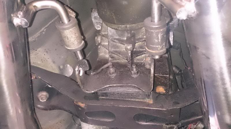

Also the decat section does not go onto the original hanger mounts?
I am starting to get the feeling I have either ordered the wrong part or have made a major balls up somewhere!

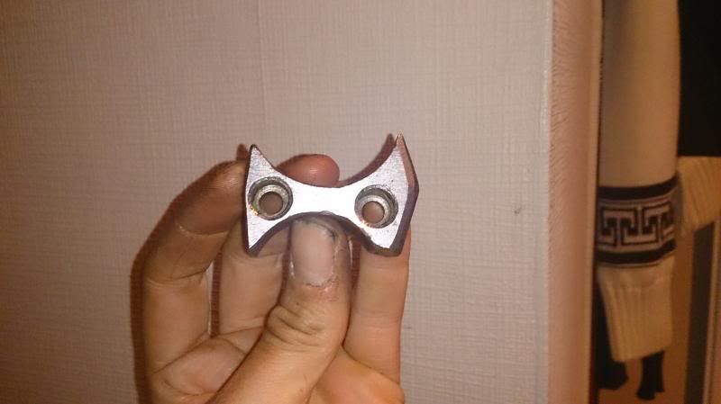

The above part is the divorce section to stop the gasses mixing from the waste gate. It will work better with it, but I doubt it will cause issues without.
As for the fitment mines the same it only just catches on the gearbox mounting bracket. Japspeeds by any chance?
Ok no probs thats good, no mine came from the z centre,
I was not aware of that, I did read somewhere about the japspeed being sold by 2fast2cool.
I had the same problem with mine, I had to bend the mounting points upwards by about 20 degrees so as to miss the bracket and yet still fit the clamp.
