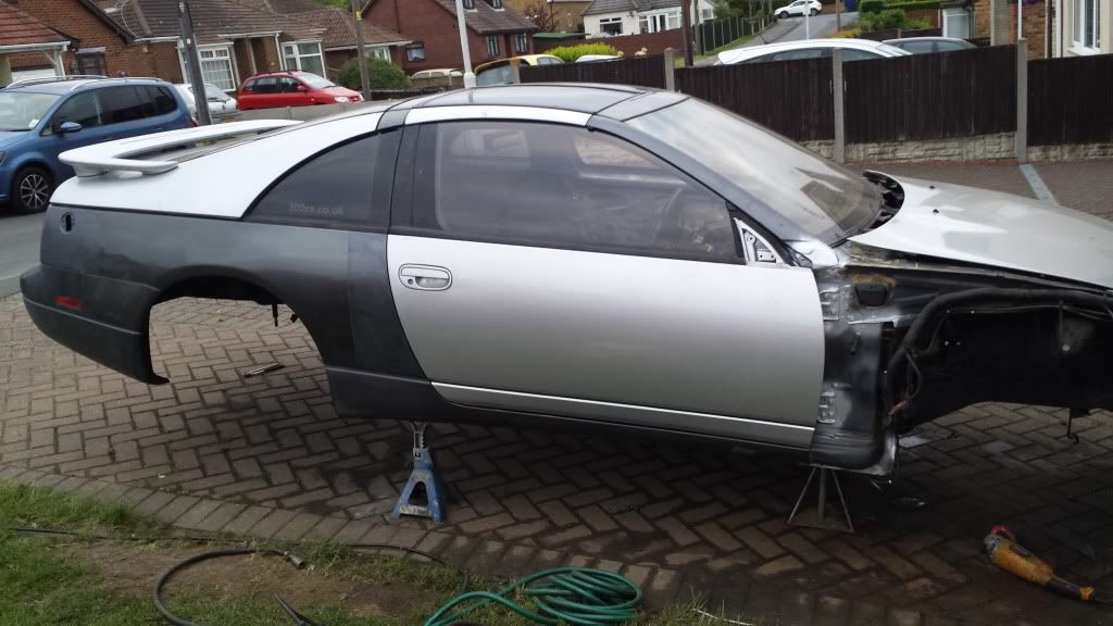

My new shell came today, from sussex stu.
so got on a mission, took the doors, bonnet, wings, tailgate off.
swapped them with my ones.

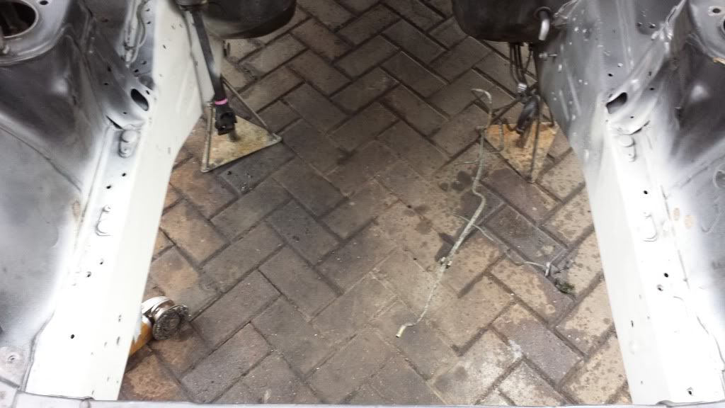

stripped the engine bay, got to jet wash it tomorrow.

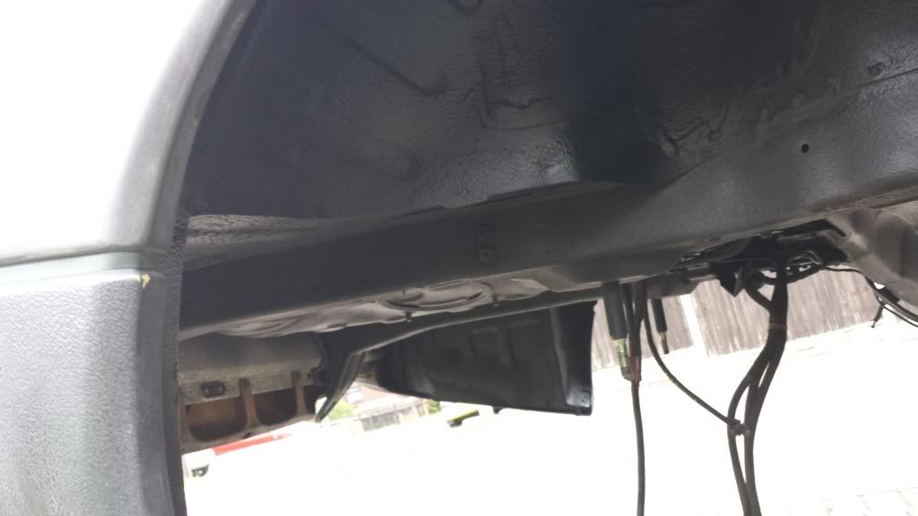

Removed rear diff, subframe, got to remove front cross member in the morning thrn stonechip arches and underneath the whole car.
one of the sills were dented, from a jack and I've sorted that.
Heres a couple of pics, I'll put some more up tomorrow.

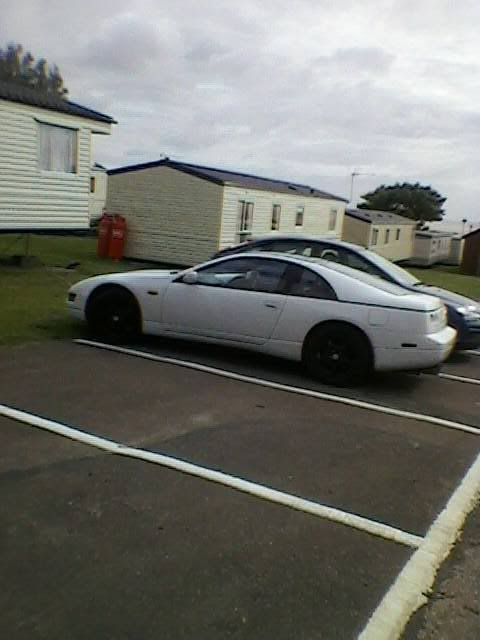

Hopefully couple weeks it will look like this again..

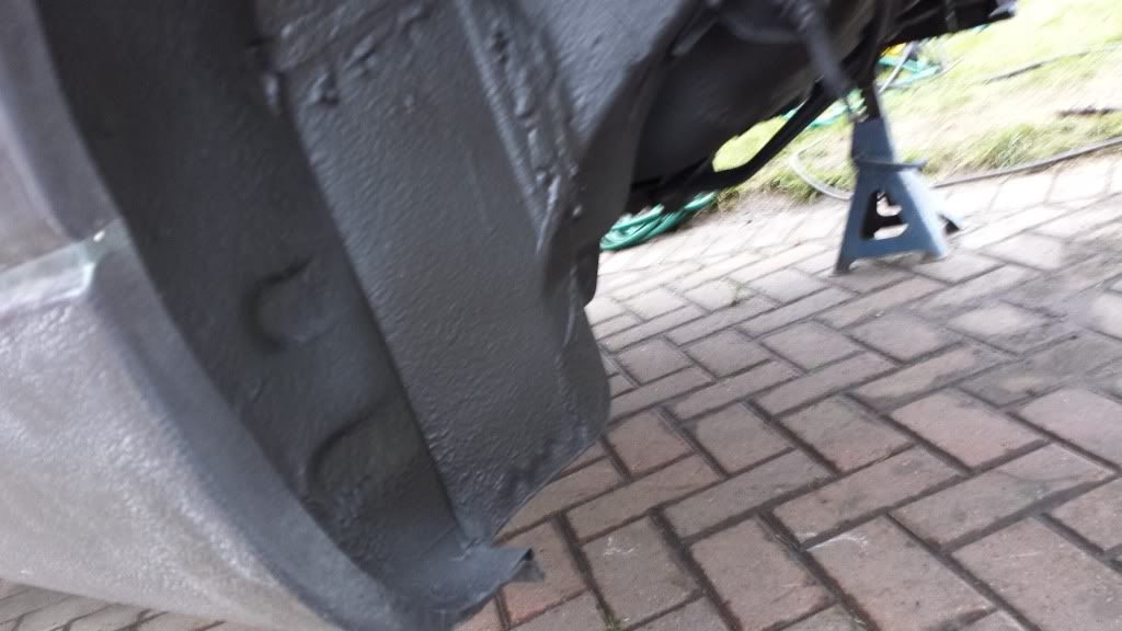

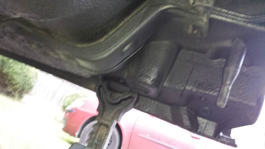

Few more bits done, Weather was crap...

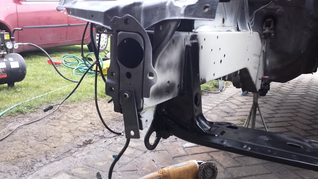

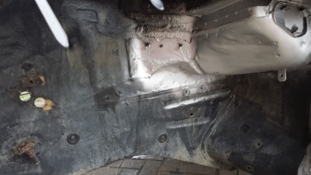

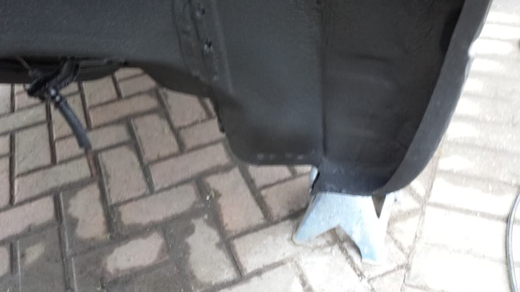

managed to strip the rest of the suspension off, remove fuel tank.
jet washed the engine bay and the underneath of car plus the arches.

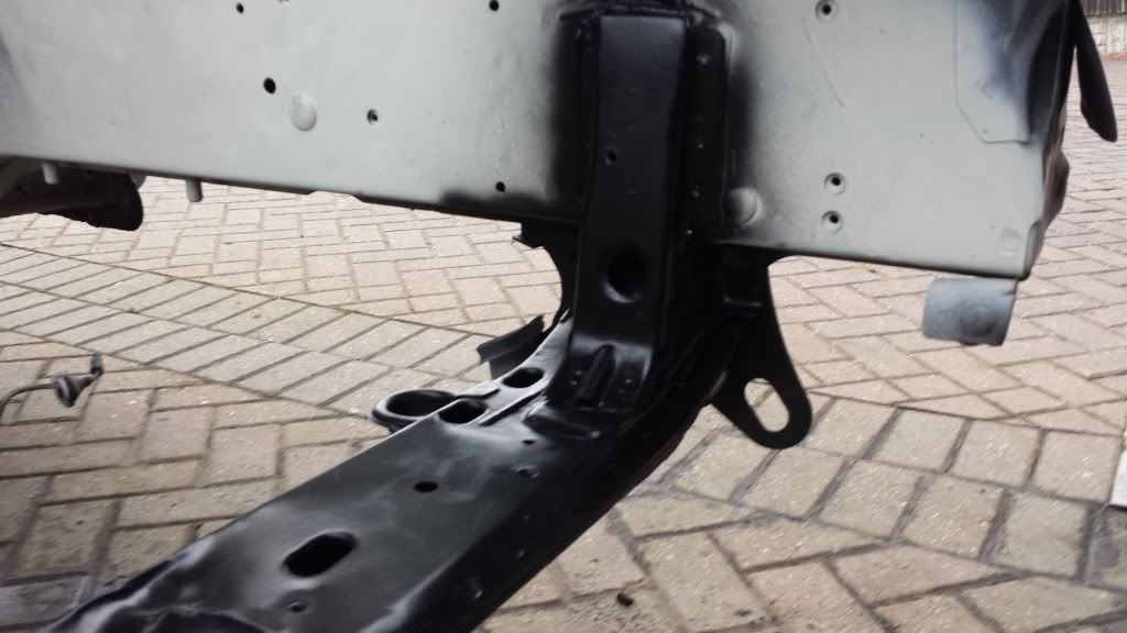

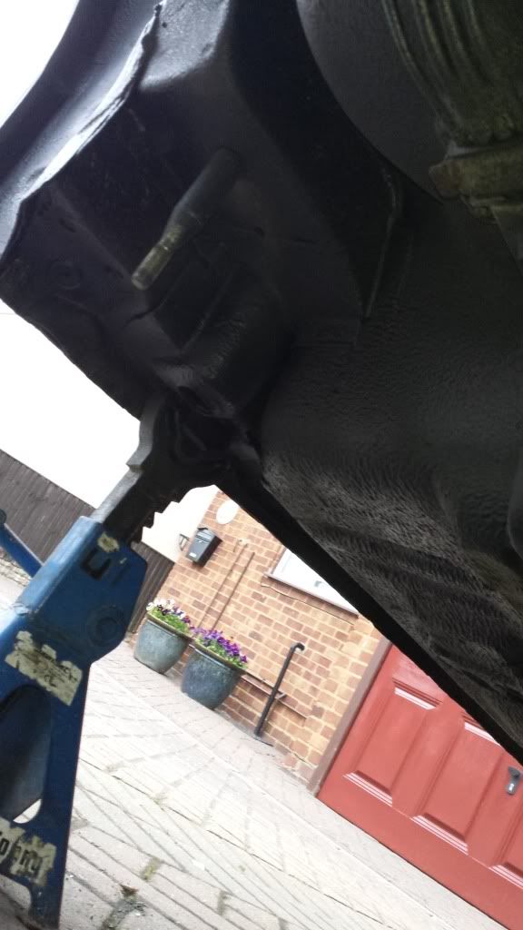

wire brush on a grinder and got rid of all the surface rust in the areas I was gonna stonechip, then etch primered.
Below the battery tray is the worse area theres actually a few little holes, gonna get bro in law round to put a tiny plate in.
so couldn't stonechip front arch today.

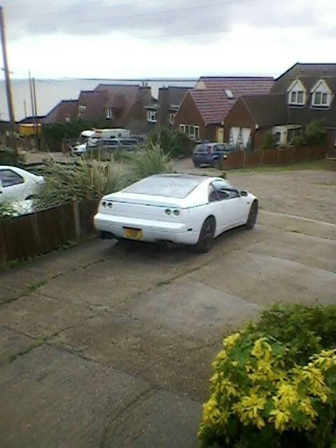

How my car looked before I wrecked its last shell....
The horrible led lights I had in it for about a day.
another crazy expensive waste of money lol.
:glare: say what :angry:
:biggrin:
:biggrin:
yeah but they look good on yours, and jasons the beast.
but u have filled the panel in and got the tailgate lip.
They looked plain on mine lol...99 spec for me...

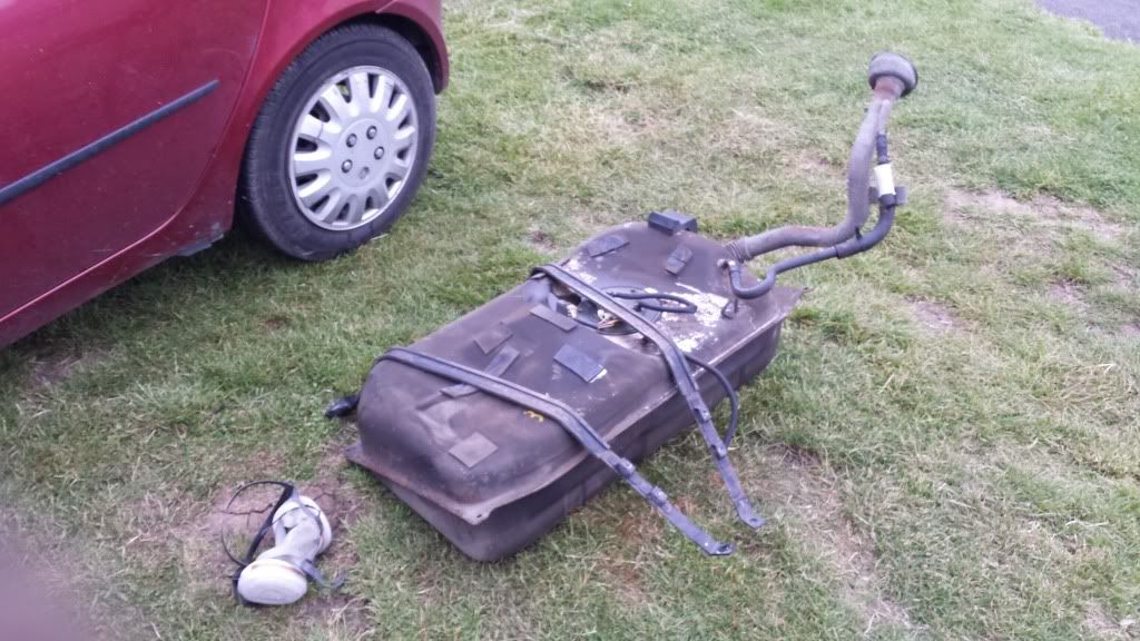

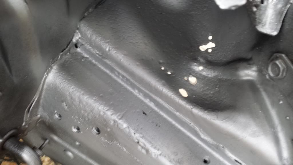

Hi guys,
Managed to get fuel tank back to metal, primered it then sprayed it satin black...
