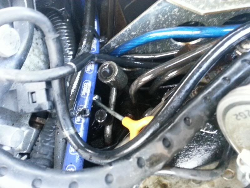

No the dip stick has not blown out, but then it is sort of held in place by the hoses.

Its a classic symptom of piston ring land failure,check the breather elbow has not come off on the n/s rocker cover,if its in place do a compression test.the oil is pushed out he dipstick tube by boost pressure entering the crank case.
