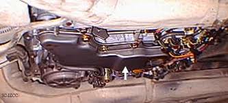

Ok the noise is the fluid pump complaining, the lack of drive is the drive pump been unable to supply line pressure, the cause is the pick up strainer in the sump is blocked, when you switch the engine off the fluid drains back clearing the strainer briefly so you have drive back for a short time.

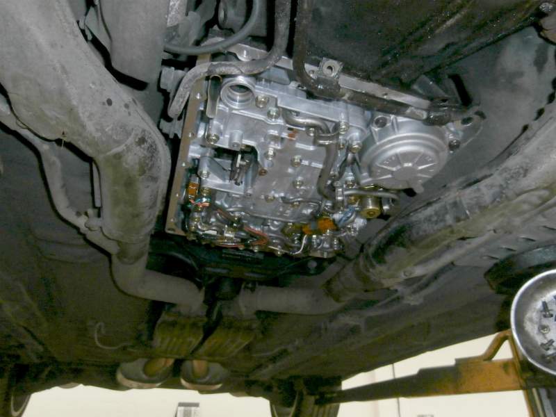

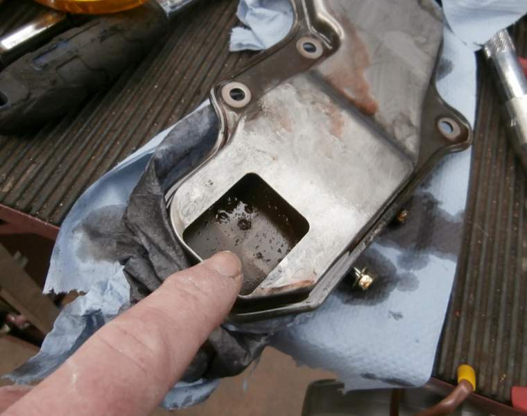

So the plan is to drain the box, then remove the sump pan be aware it will still contain about 1 litre of fluid in the sump pan so can get messy (be prepared) the strainer is very obvious and can be removed by undoing 3 x 10 mm holding bolts.

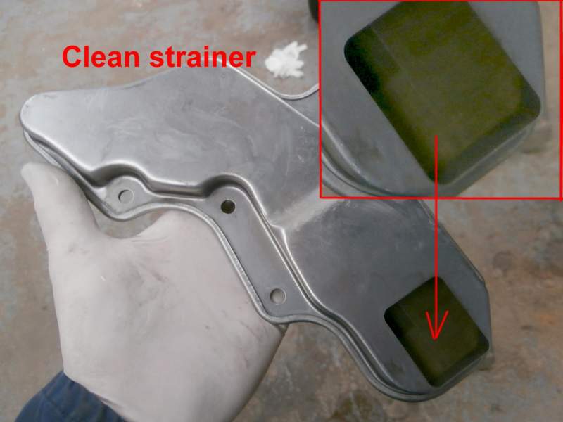

Once removed give it a really good clean out with some brake or carb cleaner, take a closer look at the particals that have blocked the strainer, they will be either fibre, metal or a combination, if just fibre its a good chance a clean out and new fluid will be all you need to do and drive should be returned. Of course if there are any metal particals in there it may point to bigger problems but its worth a try and should not cost too much, get 5 litre of dexron 3 if you can a sump gasket, if not be careful and you can reuse the old one with a little sealant provided the gasket remains in one piece.

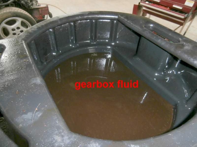

So with some whinning and moaning we got enough drive to get the zed on the ramp.
As we thought the when the sump was removed there was a lot of silt sitting on all of the surfaces and in the sump, there was no long fibres and no metal at all on the sump magnet just old oil and silt.

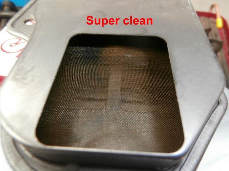

The sump went into the parts washer and the strainer removed and it joined the sump in the parts washer too, whilst that was going on the pipes and cooler was flushed out with the air line and brake cleaner until all ran clear ( messy job!!)
The sump and strainer and refitted with new seals and the box refilled with some fresh Dexron lll and the engine started, no noise and drive engaged just as it should.
10 miles of testing and a very happy gearbox performing as its should with no noise and all gears and overdrive and kick down working well.
Of course predicting how long something will last is difficult but should be ok as there was no fibres or metal parts.
