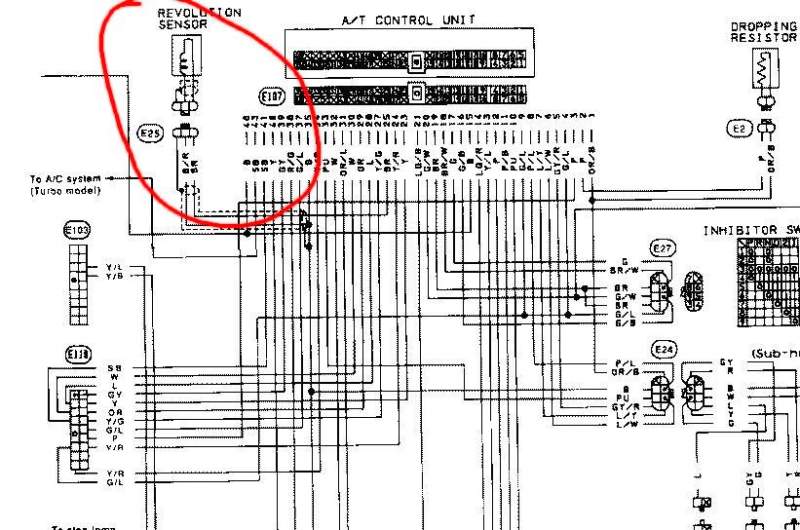

If you check wiring diagram on auto harnes rev sensor is going trough auto ecu. If i unplug it there is no revs on my speedo
Are you talking about the revolution sensor circled in red below?
If you are that is the internal gear-set speed sensor not engine rev sensor.

i fitted digital dials myself :) no cables where cut so i can put oem dial any time. oem and digital clock does the same thing when i unplug auto ecu :) it schould get signal from ecu pin 7 yellow green wire ... the same wire goes to instrument cluster tach , consult connector , hicas control unit ant a/t control unit .... my hicas control unit removed with all solenoids ... so my guess is if you remove hicas control unit and a/t ecu there is no link somewhere ... will check it when i`ll have more time
