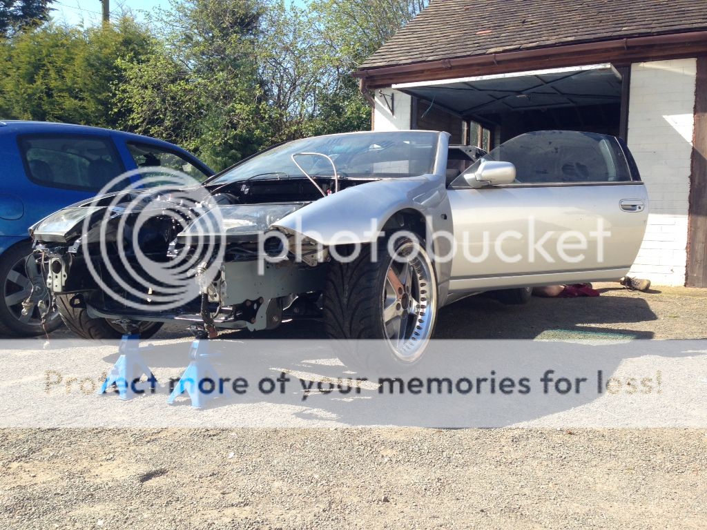

Well, a little update with the things i have achieved...unfortunately no pics atm.
Battery in boot and all wired in.
wired my Astra G PS pump in...IT WORKS :tt2:
plumbed the pump in.

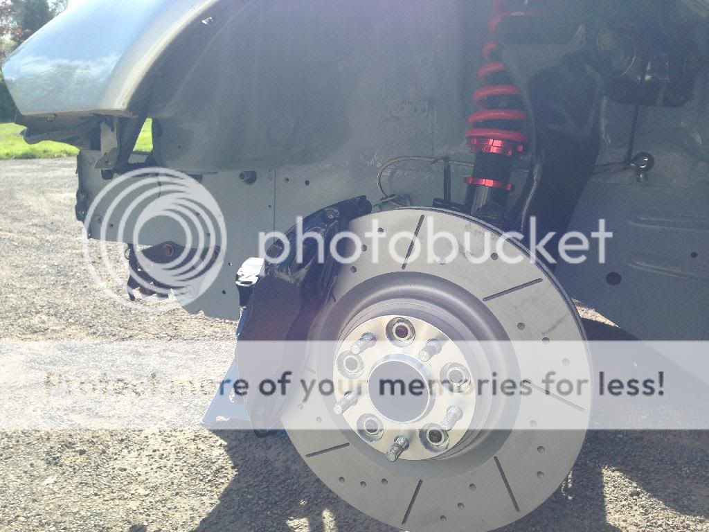

assembled front and rear calipers....
Front calipers: Carbotech XP8 pads with Mtech 350mm Slotted and dimpled Disks.
Rear: stock crap as i have no bias valve and no ABS, anything more and id probably lock up.

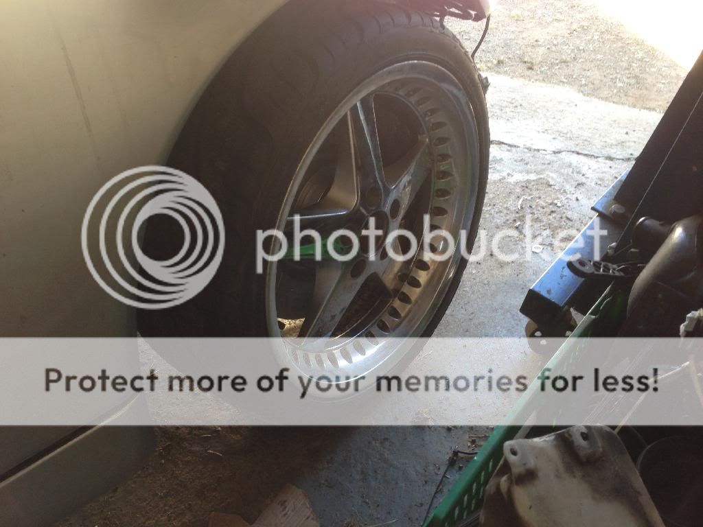

Purchased and fitted my Federal 595RSR's
fronts 245/35/18, Rear 285/30/18. The rears turned out to be a bit thinner than i thought so they have a bit of stretch which some people will dislike but they are there to stay.
Bled all brakes with some DOT 5.1
Bled PS and blew a few fuses in the process haha.

This is my pair of spacer from Clarke motorsport which Lexx referred me to, Cheers bud!

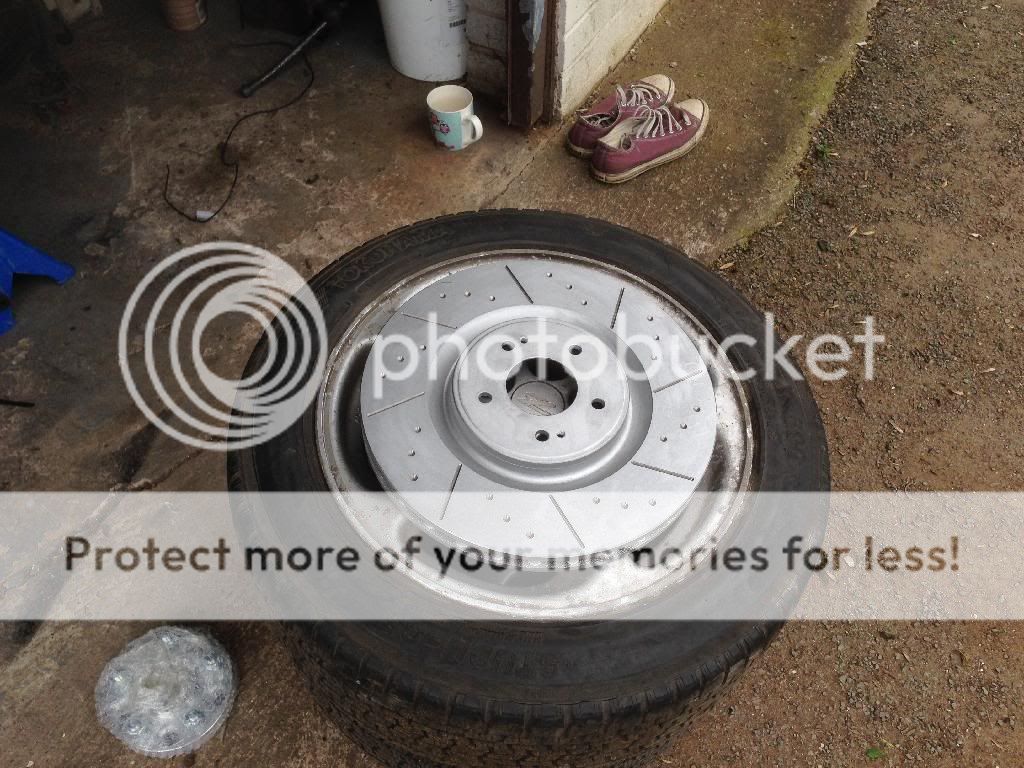

Mtech disk against the stock wheel..
Fitted..
With wheels on..random pics now
Now for the rear...Which needs work and the geometry is WAY out so dont get jumping to any conclusions....Body Mech is going to be having a play with this!

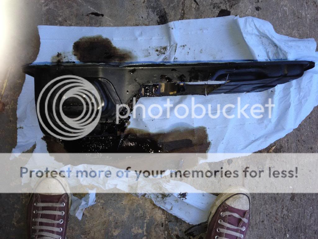

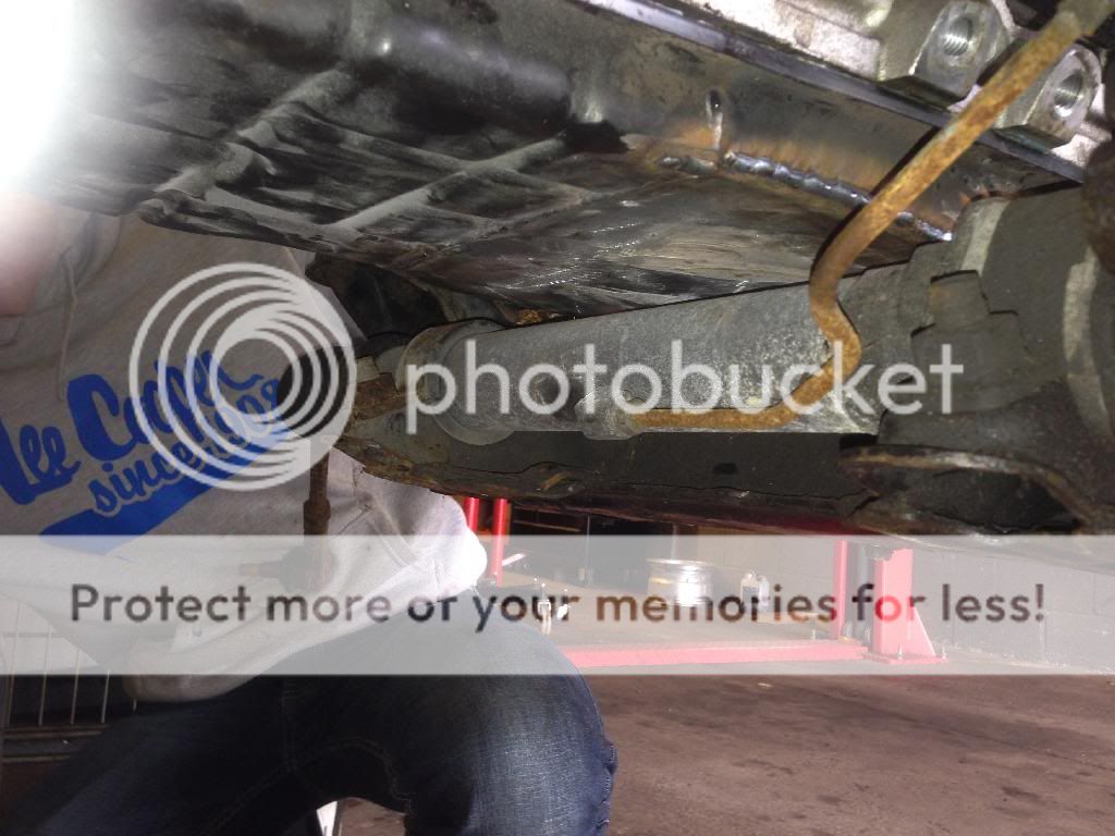

The dilemma i had a while back was my engine wouldnt clear the subframe/steering rack due to the sump. so i chopped it up and put some replacement plates in.
after cutting it im glad i did as the oil was like stodgy muck! (i did drain it for a few days before cutting so what you see is what was tucked away in the crevices)
As you can see the last picture the has filler on the sump...it just so happened the piece of sheet metal i used was my mixing surface earlier haha
Also in total i have lost around half a liter of oil capacity. Although i plan to overfill this anyway by half a liter im fitting it with an oil cooler which they don't come with standard.

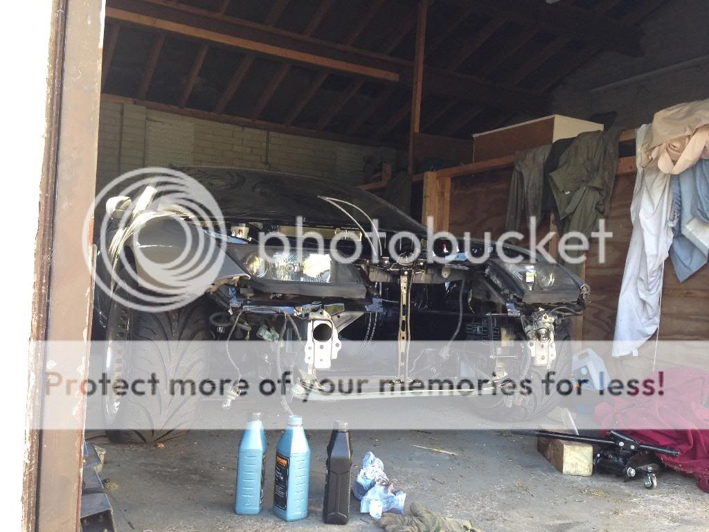

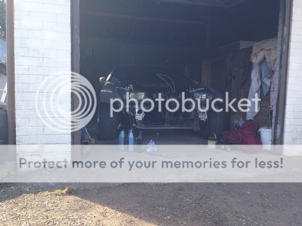

Casual pic of my car as it is at the moment in the garage awaiting engine (very dusty)

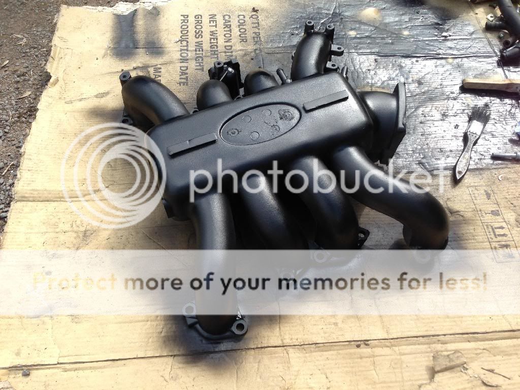

Stripped the intake manifold and runners off with the fuel rail and coolant system to give it a clean.
Gave it some paint as it looked mucky and boring
