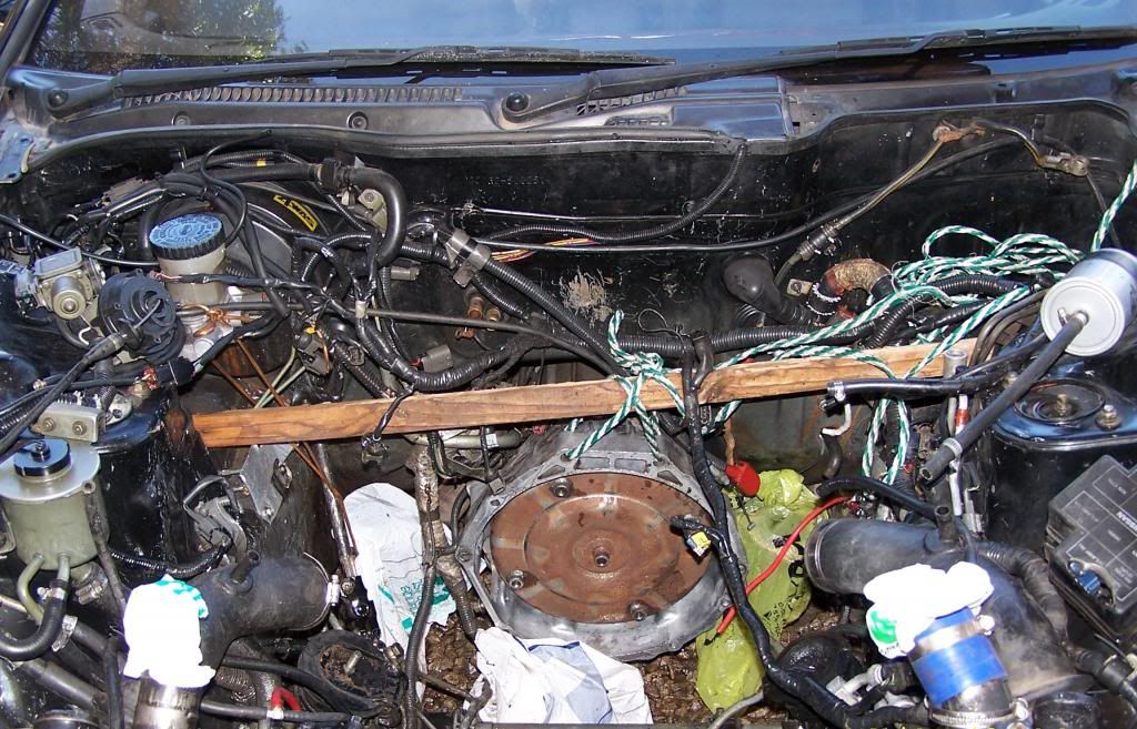

As my friend live about 5 houses up the road my first drive in the car was powered by 2 people pushing me home in my engineless car.

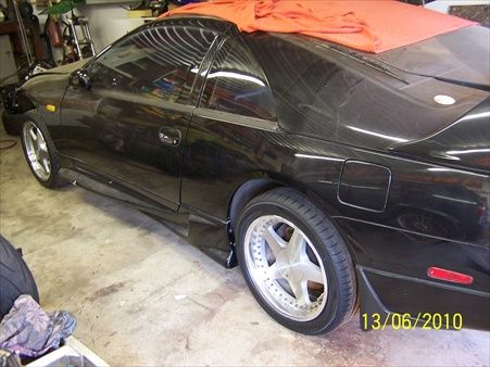

It came with a set of 17" 3 piece veiside mags, veilside side skirts, rear wing and an ugly front spoiler.
Oh look.....an automatic gearbox. That will have to go.
After a few moths or so of hunting for a manual gear box, pedals etc for a manual conversion I found this.

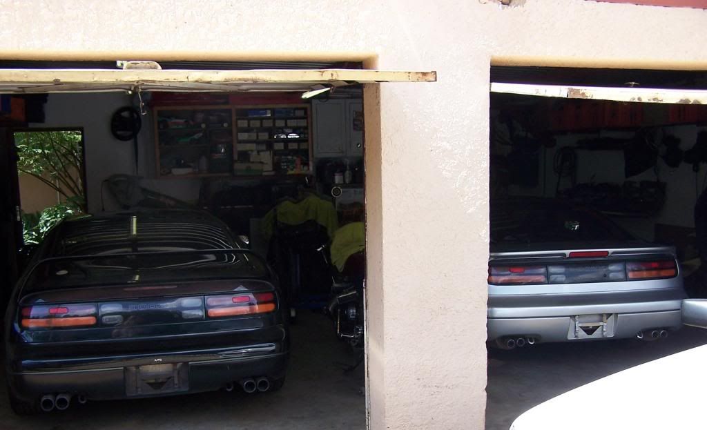

It was an import unregistered car and I had a great time removing and fitting all the best parts from the silver one onto my black one, this ofcourse included the manual conversion.
This to me was a rare and pretty sight, owner of 2 300zx's.

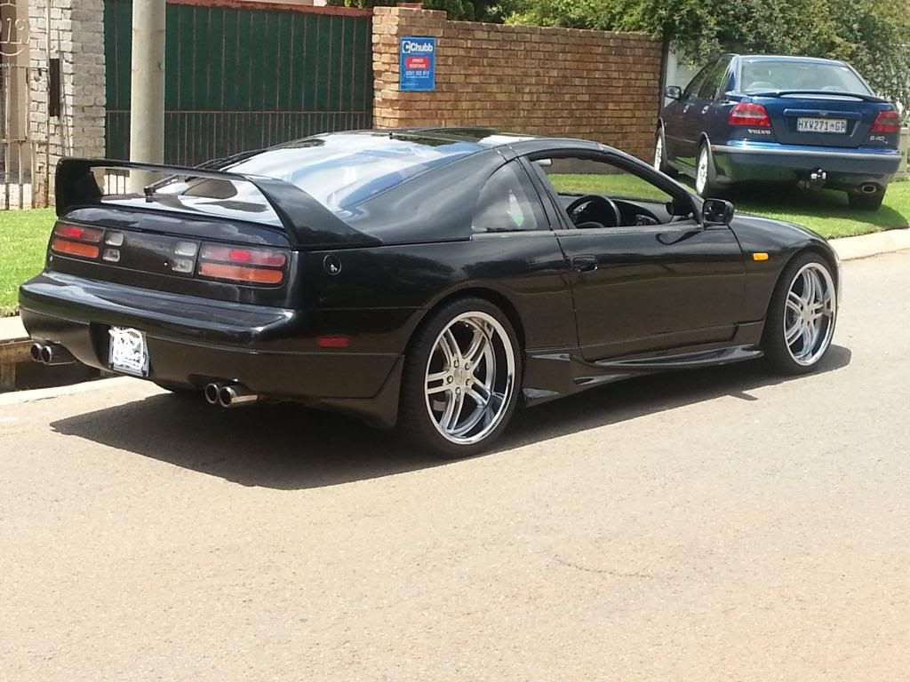

OK so that was history and this is after 3 years is where I am at the moment. It is fitted with a rebuilt stock motor by myself with port matched heads and manifolds, rebuilt turbos and running on 1 bar boost fitted with a NOZ (noel) performance chip. It is fitted with 19" alloys fitted with 175x30x19 rears and 235x35x19 fronts.
Looks stunning love the new alloys, gt some 99spec rear lights on the rear it will look amazing :)
Fantastic looking Z. I guess there's not many over there - are they all imports?
Thanks.....Nissan South Africa did sell the 2+2 TT for a while but not sure if they also sold the na versions, yes most are imports that are bought into the counrty legally and registered there are those that are illegally brought into SA from neighbouring countries like Swaziland and Botswana.Many are confiscated by the authoutities and crushed. There has been a few GTRs, EVOs, supras and I know of a koningseg that have visited the crushers.
There is a process to import a car which is legal, takes months and costs a lot, but it can be done.
Thanks again....new spec lights would be like finding rocking horse $hit here, will certainly look at some point in getting some.

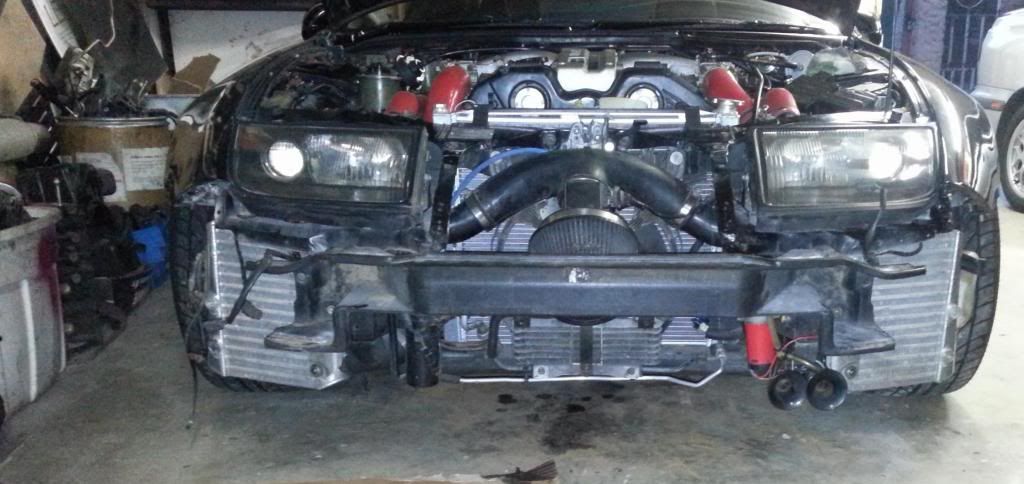

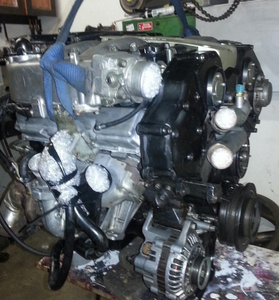

Well it was time to make way for the new engine build as I have saved up parts for a while now. The rebuilt stock motor has to come out as I have advertised it and have a few intrested parties.
Here it is still in the car.
And now hanging from the I Beam.

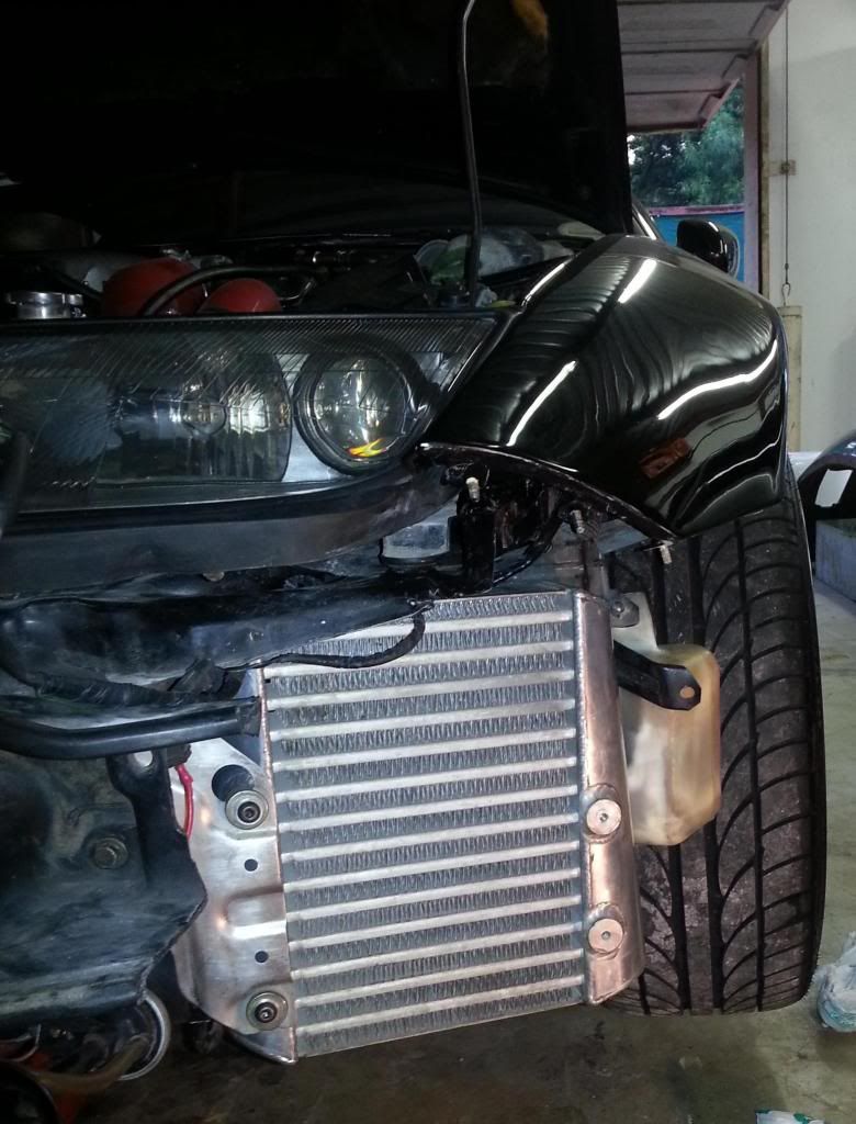

Fitted my new/used side mount intercoolers and found they fitted like a glove, quite a lot bigger than the stock ones, used the original brackets and mounting points...very happy with that.
