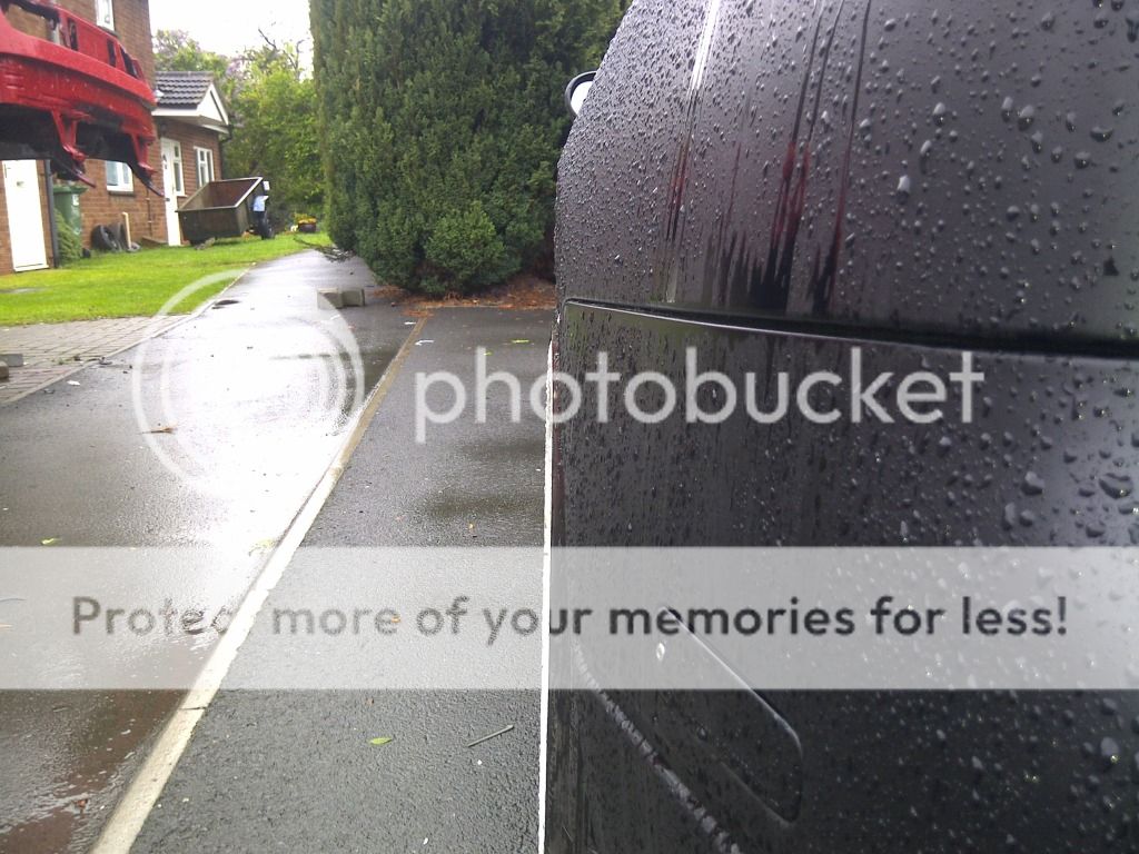

A ran 18" ET +45 (9" front and 10" rear) on mine without any problems, the 10" rear sat perfectly flush with stock arches whereas the fronts sat slightly deeper in the front wing but still perfectly useable.
Here's a pic of the rear

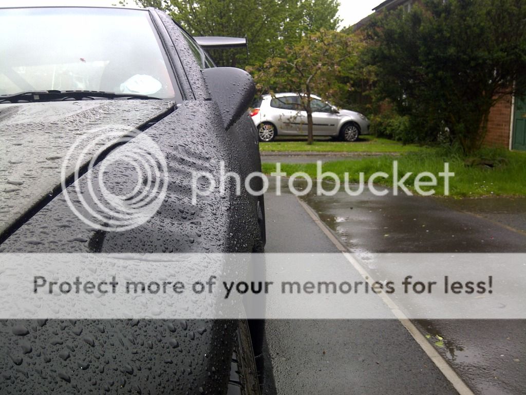

Not the best pic of the front as the wheel was slightly turned but it didn't look too bad and handling was spot on
