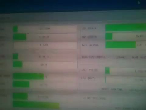

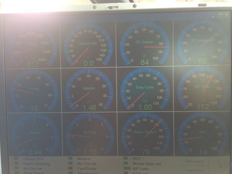

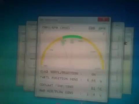

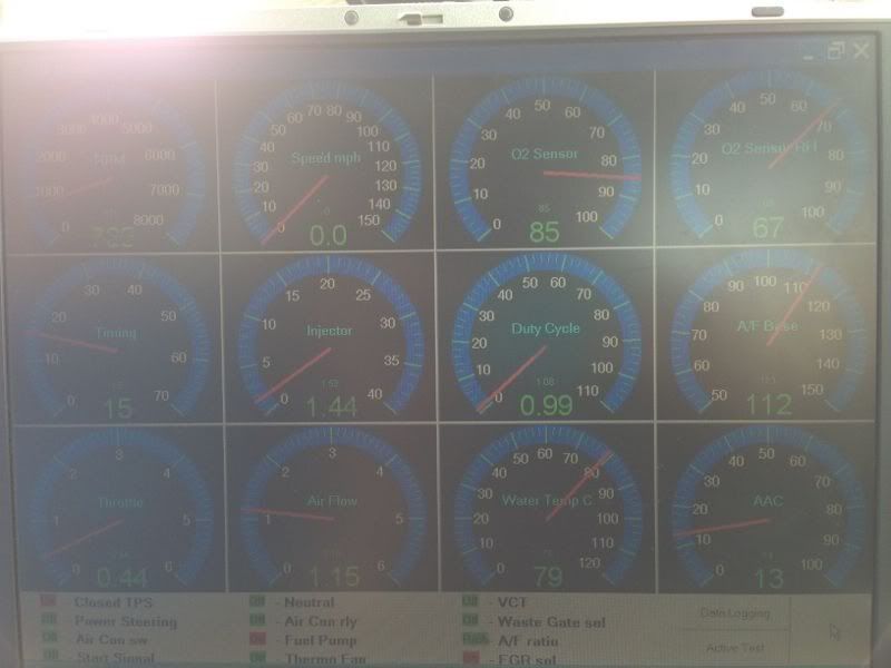

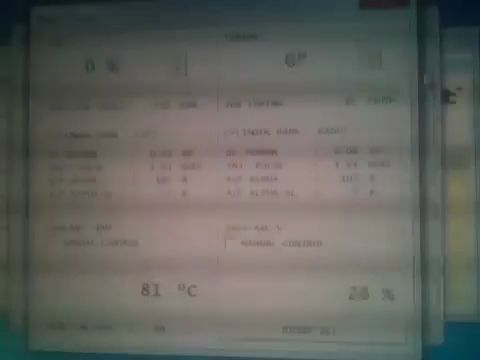

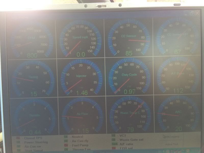

Here are 4 screenshots.
I don't think I can change what come up on the dials or know how to see the injectors - if you can tell me how to do it I will
Membership No 0780
INSURANCE GOOFA
Anything look wrong? I noticed the AAC moved from like 13 to 20 while still idling.

The AAC should remain constant on idle, the idle should be 700/750, so adjust the aac screw with the iacv plug unplugged down to around 650 then plug back in, the ecu will then take over the idle, which should then be whats required, you can then adjust the screw slightly if need to get the 15% at idle from the acc.
To get a reading from the 02 sensors, raise the revs to 2k rpm with the throttle body or accelerator to see what they are reading, if they are lazy or erratic then it will affect the fuel ratio, if that is the case, unplug both 02 sensor plugs, the ecu will run a means setting.

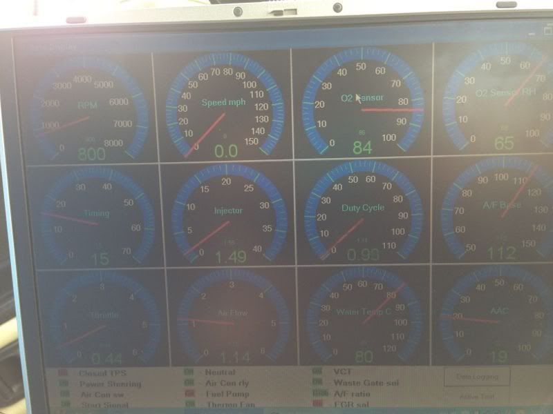

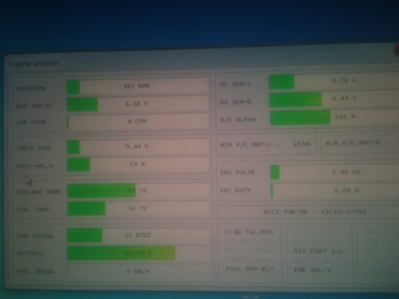

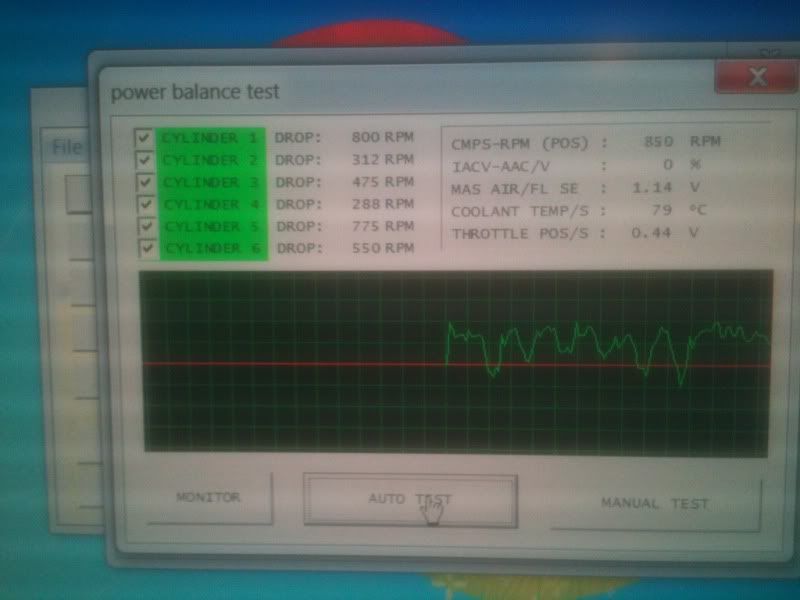

Gonna get the car on consult at Paul's.
What read outs would ya's need to diagnose a problem?

Injector pulse and duty cycle is a little low and judging by the lack of drop in revs on the power balance test, you have an issue with cylinder 1 and 5
Have you checked your plugs and coil packs? Unplug each coil pack one by one to determine which cylinder changes or not as the case may be.
You can use a meter to measure the voltage at each connector, this will eliminate or pinpoint an injector plug, also check for corrosion on the pins.
