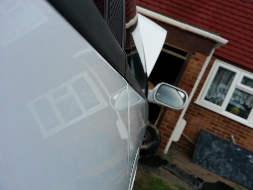

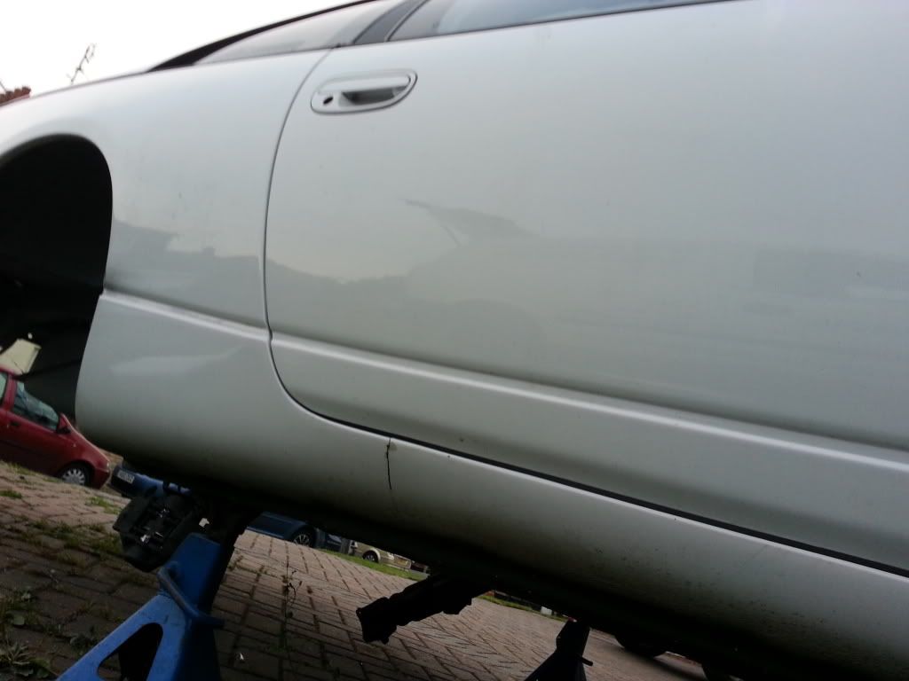

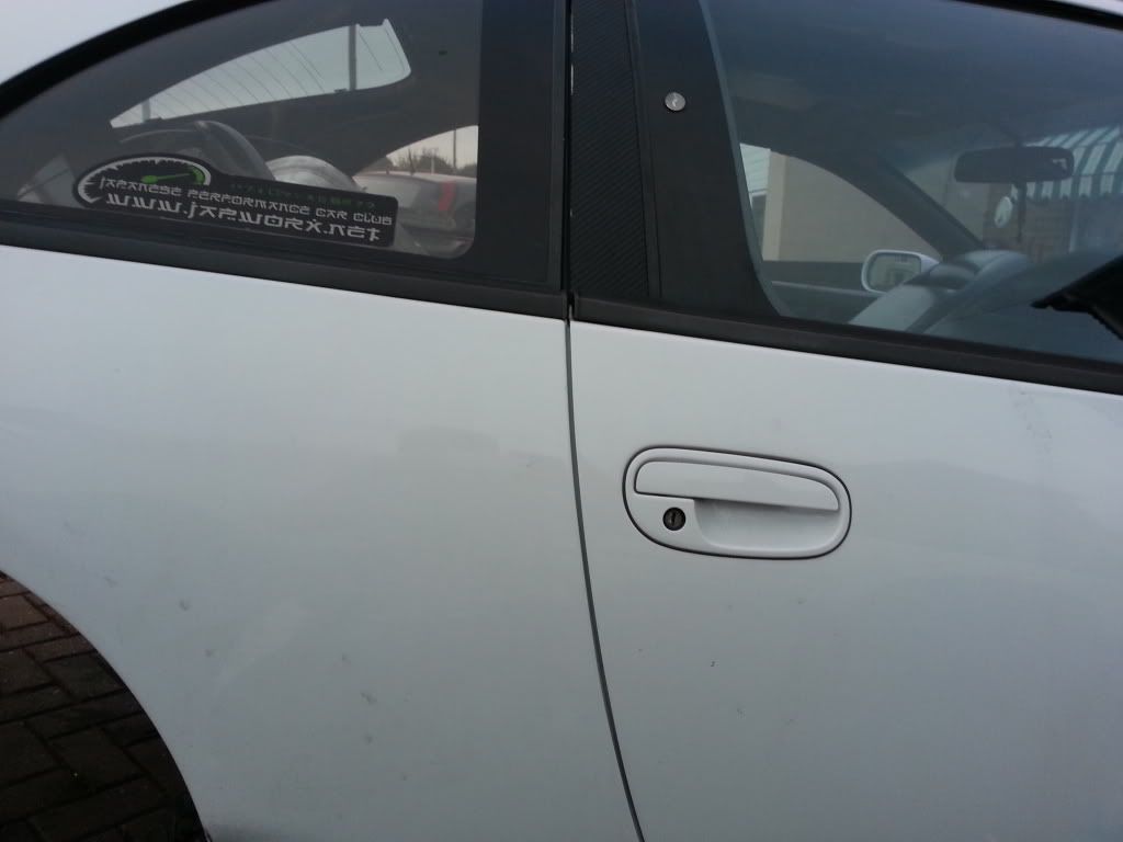

This is how I got the alignment, made the gap smaller etc,
that looks spot on, its my drivers side thats the worse, about half n inch dropped down, making the seal leak with water, and the bracket on the door is slowly wearing away the door pillar
