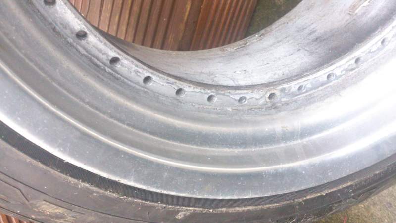

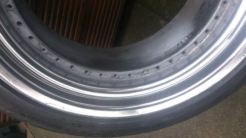

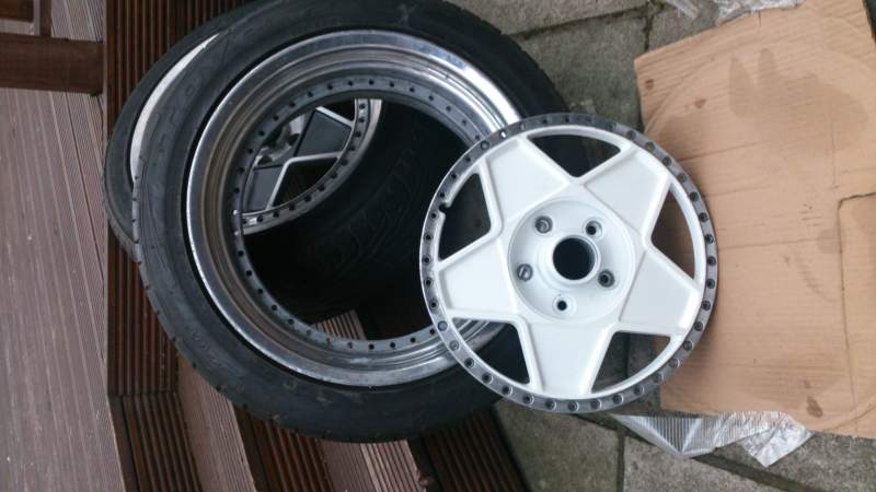

Got these a few months ago & finally got round to working on them. As you can see on the before and after pics they've polished up pretty nice. Took a while to split them though as some of the bolts were seized. Used a whole can of wd40 to soak them in but had to grind about 10 of them off. Gona polish the lips up a bit more and spray the middle black. Think they will look good in the end.
