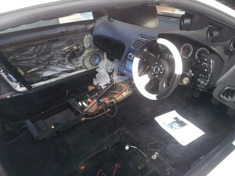

Seeing as my Zed is in bits at the moment having a full leather refit, I put in some wiring for my new illuminated door sills and also some wiring into the doors for illuminated switches etc
While upside down under the drivers footwell with the trim panels off I spotted yet another fuse box - what is this one for as opposed to the ones under hte bonnet (two that I know of)?
Also there were a couple of things hiding under the back seat.... one is shown in the phot (red arrow) the one (no pic) is on the drivers side of the rear seat and was a bit bigger with a huge fook off connector plug attached to the top. What are those for?

I think the one one the passenger side is the original bose stereo amp (and I mean think lol). The one behing the drivers side is the abs computer.
Passanger back .. Fuel Pump ECU
Drivers back ABS ECU
Middle Center consol Black box silver wires is for the Cat/exhaust temp sensors
Behind the Drivers side boot side panel on some models is the head unit booster amp
Yes it was the fuse box by the accelerator pedal, visible once I removed the trim
