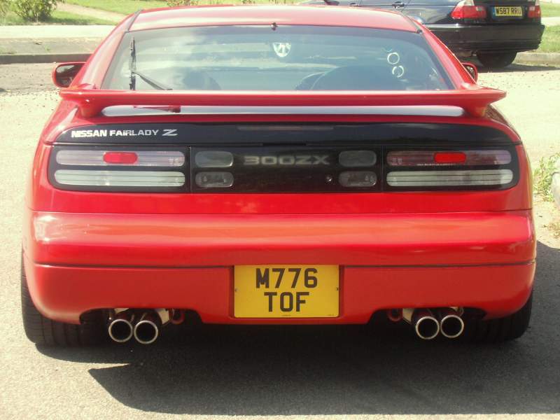

Here's a picture, maybe not to everyone's liking but I like the way it seals and stops water sitting in the corners.
That's where I've seen alot of rust issues on the 300.
Damn! That is HUGE! How does it mate with the trim at the top!?
Didn't really have a better option as my existing seal was knackered and the other profiles the fitter had would of meant the glass sitting too high or the complete opposite and for water to sit in the channel which I didn't want.
He managed to fit the top plastic corners back on but obviously the rubber seal is wider and has not matched exactly to the top trim.:no

As you can see it doesn't line in with the targa roof trims but that doesn't bother me personally.
I suppose the rubber could be feathered into the roof trim but I think this might make it look more worse IMO.

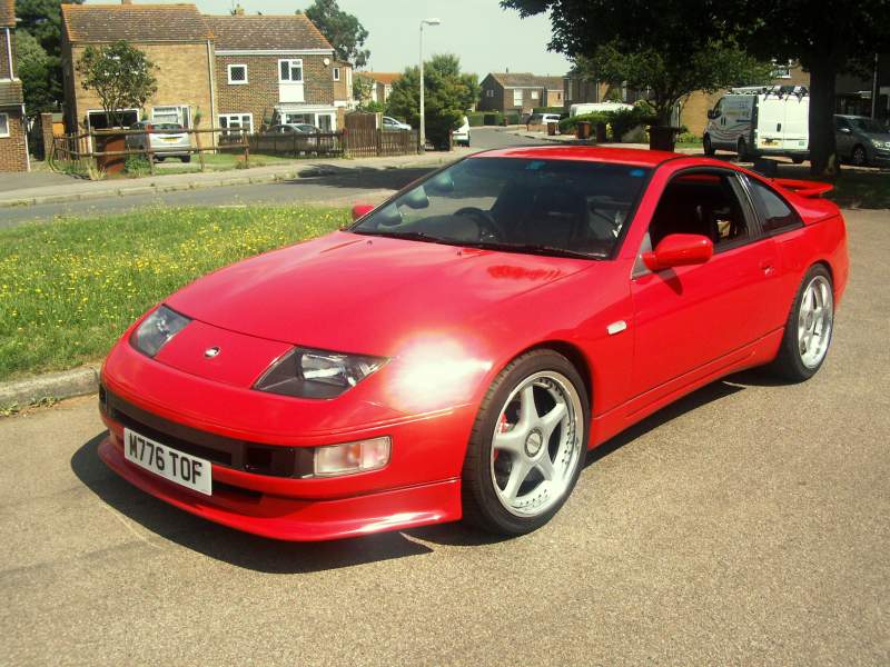

This is more like what I did yesterday and today, Yesterday I sprayed my n/s front wing in aj4 I think it was ag2. I let the paint go off over night the finish from a rattle can was very good and the shade looked very close ( got the paint from Halfrauds ) so all that was needed was a little nib back with some 1200 wet and dry and some T-Cut, only problem was that after that was done I stepped back to admire my work and realized that I would have to do the rest of the car.
Here are the results of my two days work.
Looking great! I really like your car! Soooooo glad I persuaded you to keep those beautiful split rims! See you on Sunday! :)
