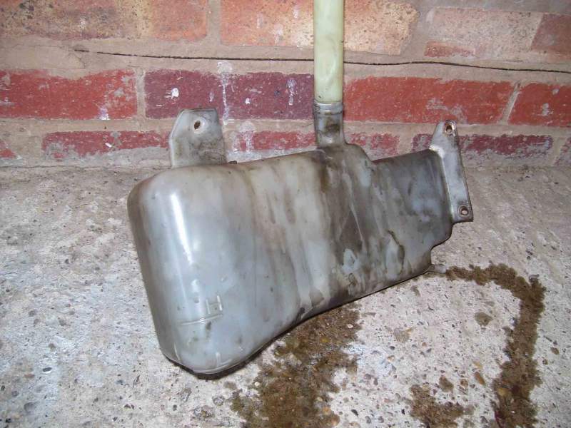

Decided to tackle a job that has been bugging me for a while now.

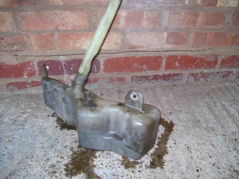

Cleaned the filthy expansion bottle.
Will be tackling the washer bottle next.
Excellent job mate!!
What did you use to clean it?
For the outside, I just used a kitchen scouring pad and detergent. (and elbow grease)
For the inside, having tried many different combinations, I stumbled across a crushed dishwasher tablet and dishwasher salt combination.
Filling the bottle to about a quarter with warm water and then vigorously shaking, the staining etc' just fell away.

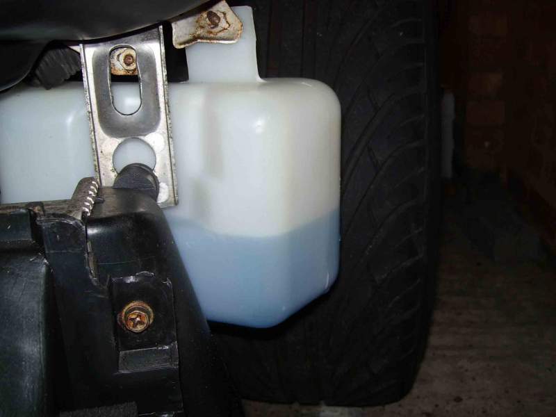

Having successfully cleaned and fitted my expansion tank, I then filled it up with antifreeze mix.
Over filled it a tad though, will adjust it after giving her a run out.

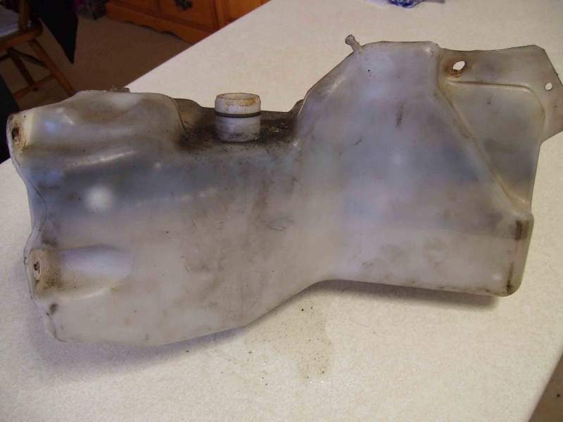

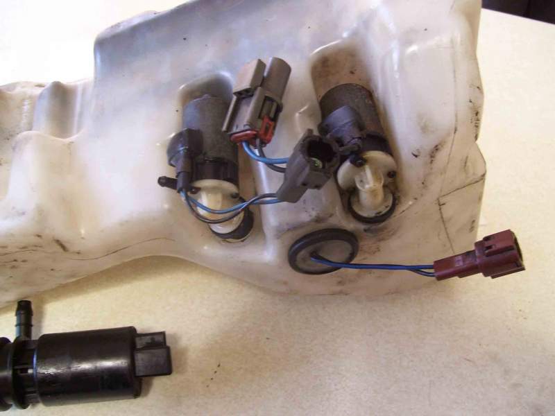

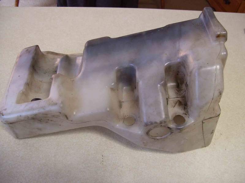

As promised, I dismantled the washer bottle today.
Not only was it a pig to remove, it was even more of a pig to dismantle!
Still, got there in the end.
Let the detailing begin.
