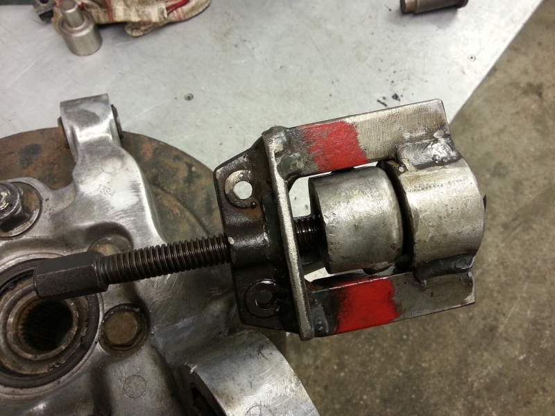

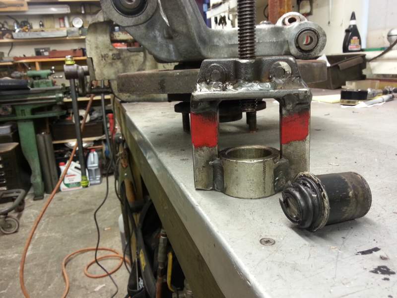

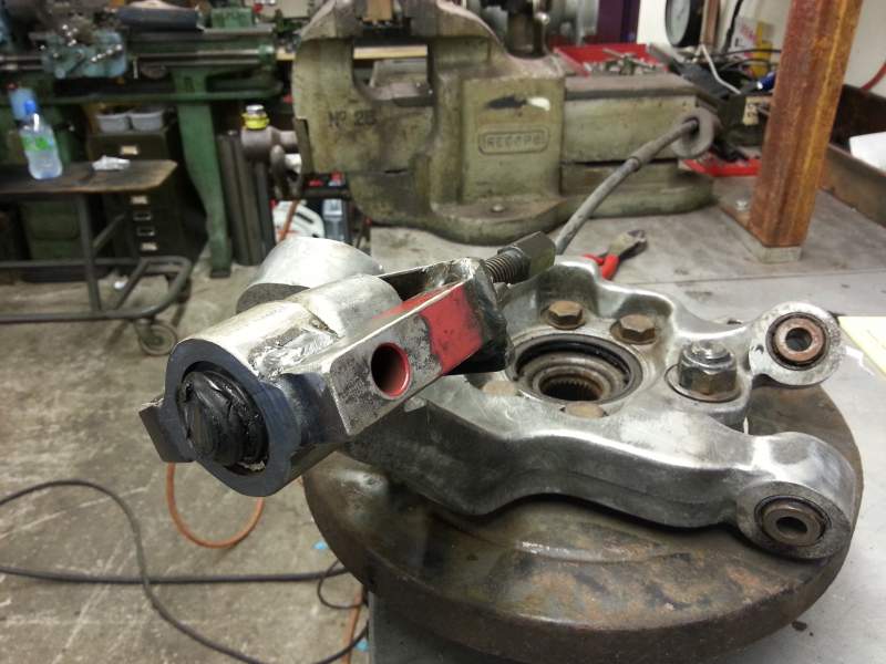

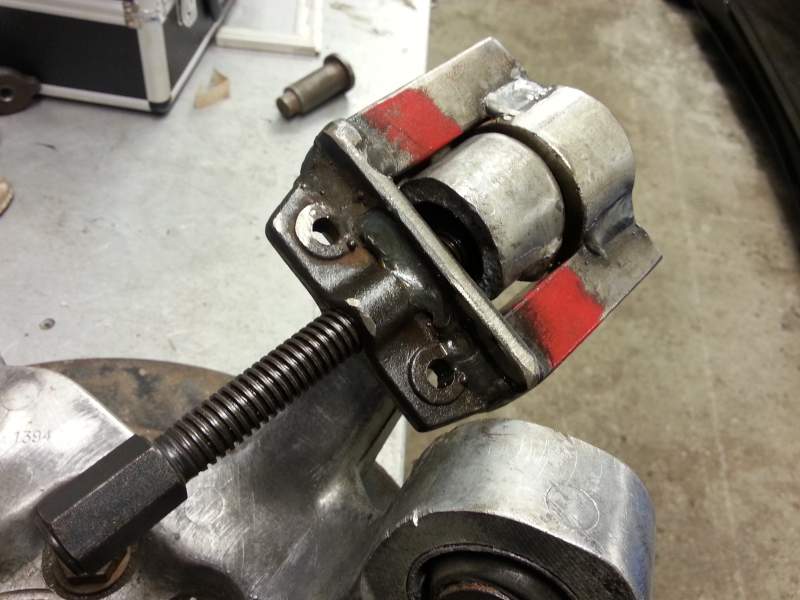

Had a spare hour this afternoon so with a bit of scrap plus a bit of time i knocked up a Hicas ball joint puller or in this case a joint pusher...makes the very awkward job a walk in the park now:yes: Thanks to danny for the hub for a jig:biggrin:

Like the ball joint puller Bri :thumbup1: and is MY Z looking good Stephen :biggrin:
