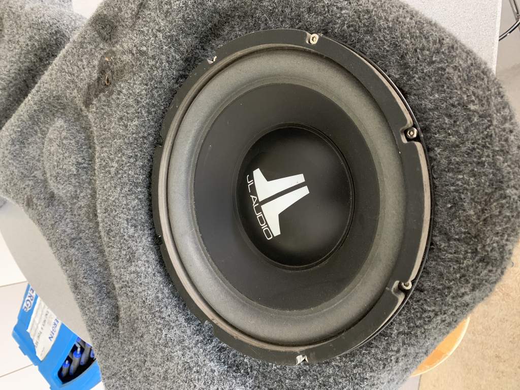

Finally fitted my JL audio subwoofer, that I must have bought from Joel 7-8years ago.
Dammit forgot to take the final photo.

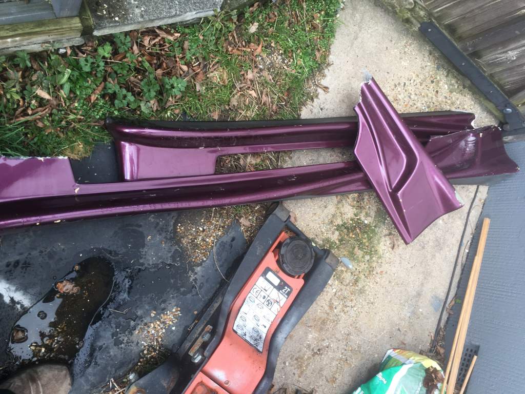

I smashed off the remaining veilside side skirt!!!!
Going in the bin at work tomorrow...........

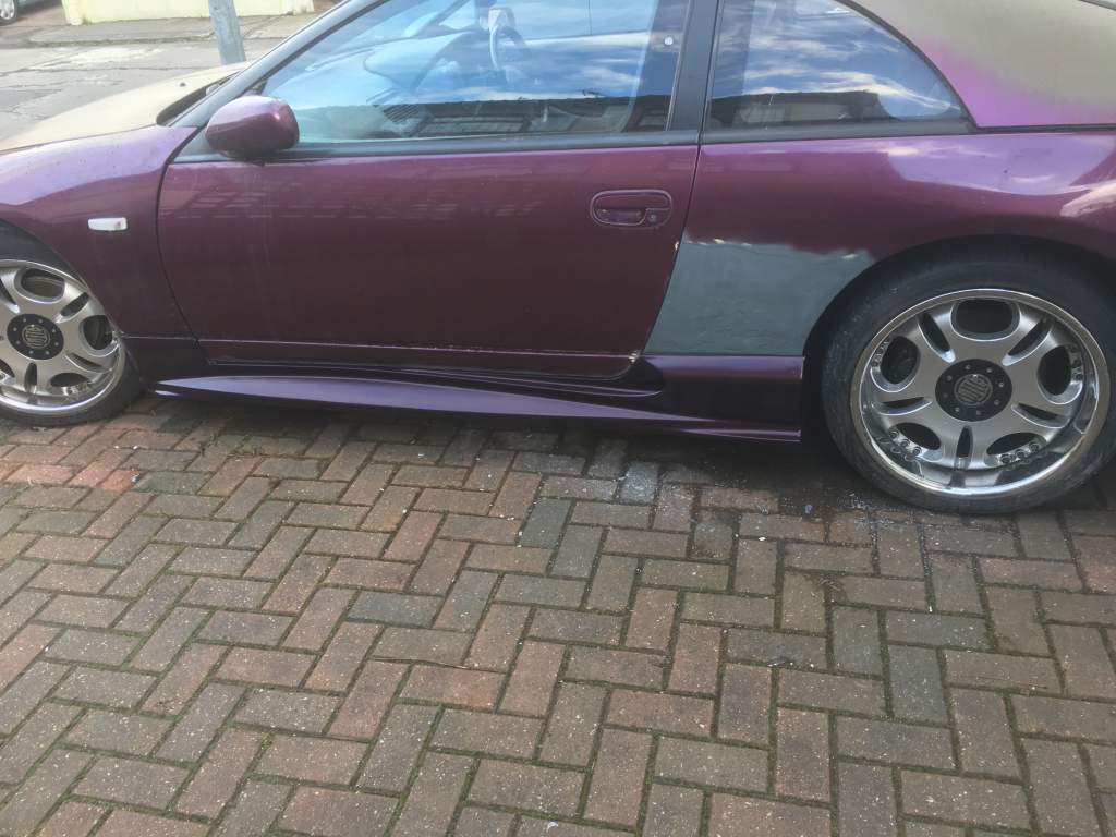

Getting her ready for a fresh respray and possible colour change...........:whistling:
Test fitting of their replacements....
[ATTACH=CONFIG]116044[/ATTACH]
Test fitting of their replacements.... ��
[ATTACH=CONFIG]116045[/ATTACH]
