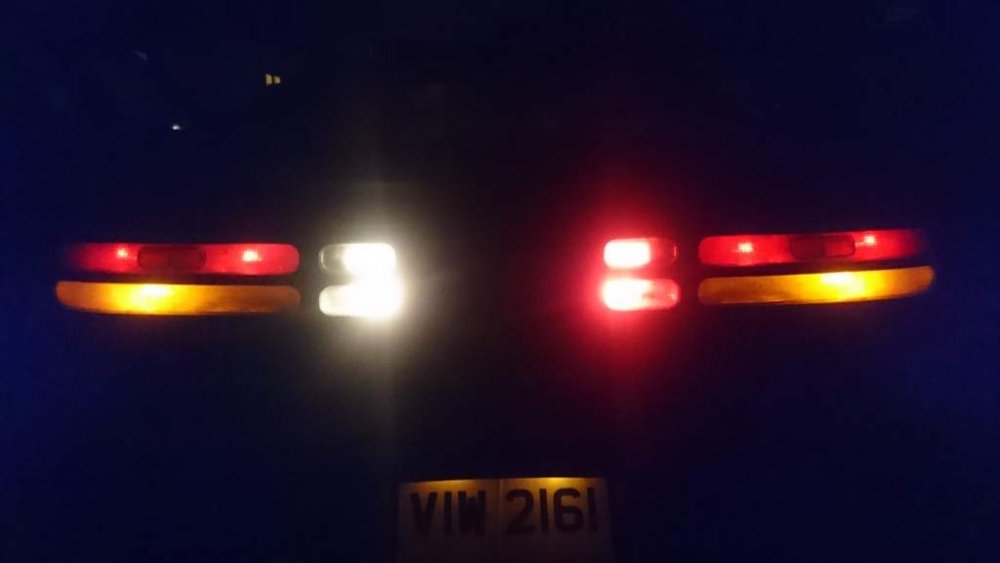

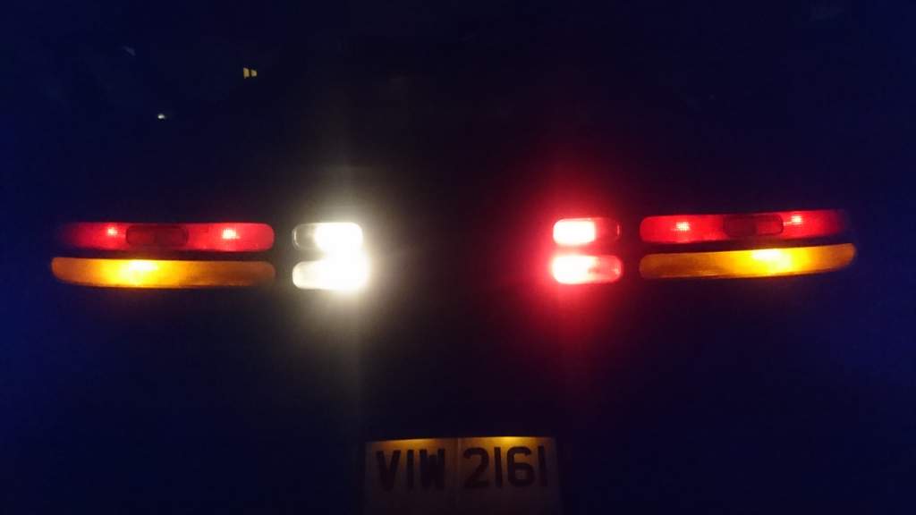

So, many hours on hands and knees sorting the little niggles like a lack of interior, tyres being right on the wear bars, sorting the broken wiring on one of the front fogs and of course the rear fog light pod refusing to function.
I don't know who wired it in, I don't want to know. What I know is that it was spliced on to a lump of blue cabling, which itself was poked though a hole drilled in the dash and spliced directly into the feed from the fog light switch in the right hand dash pod. I'm no auto electrician but even I know stuff should really go through at least a fuse if not a relay, and you don't want full working current flowing through the spindly dash wiring that's only designed to fire a relay.
Cue panic, then a moment of clarity.
I simply acquired some suitable wire from work poked it into the one working front fog through the condensation vent tube, crimped a bullet connector on and plugged it in where the bulb should go. No front fogs at all, which means the broken one is now no longer an MOT fail!
Front now powers a fog light bulb that had its 'bent' bayonet clip filed off to fit in the reverse light holder.
It's a bodge, but at least it's done properly, and I can sort the front fogs out properly when it's positive temperatures outside, and it's not ruddy dark!
