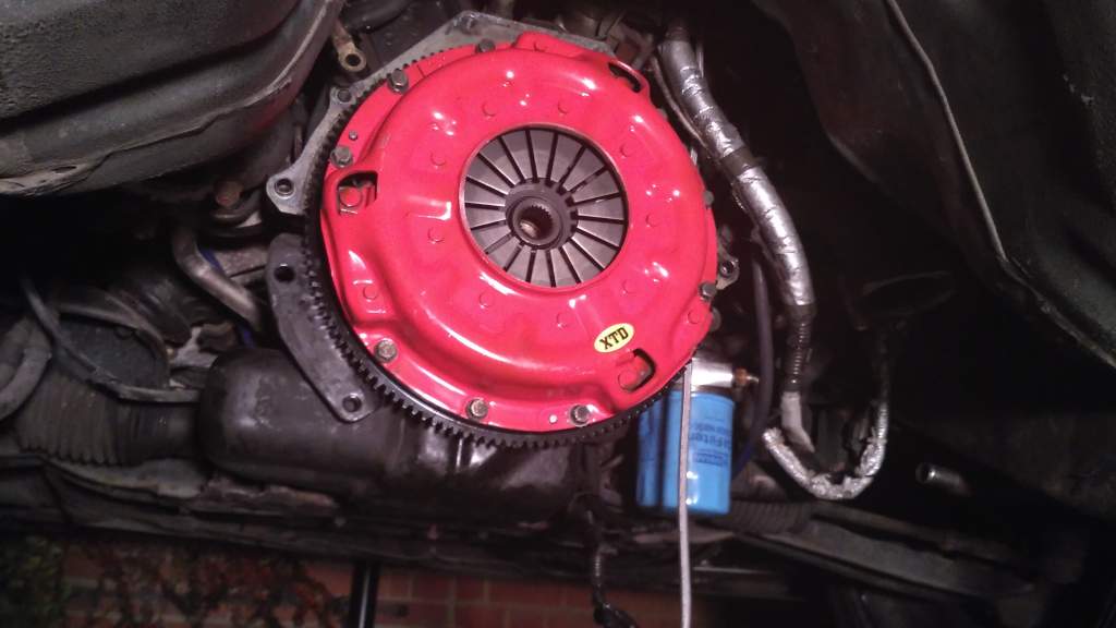

So, today I swore a lot, got the clutch pedal installed.
Bruises and cuts later of hammering the auto pilot bush, I used a pipe wrench to spin it and loosened it and it finally spun out. Then Pilot bush installed, and flywheel + clutch installed also.

Weldone kiddo. Have you modified your gear box yet?
That's the next job to do, need to pick up a grinding blade as opposed to the cutting blade that is on it, and I am told grind the inside where the starter mounts up about 2mm, and shim it out 3mm. I might make a plate to secure it properly but it shouldn't be a problem.
So gearbox in on Friday I think, then finishing up wiring etc on Saturday for SE meet on Sunday... phew.
Good stuff, although I may have been a good idea to use the clutch and fly assembly off the car to test fit. Clutch pedals in I take it? I dug this out for you too. Reverse light wiring;
Obviously you can neaten that up but it just shows the way it's done.

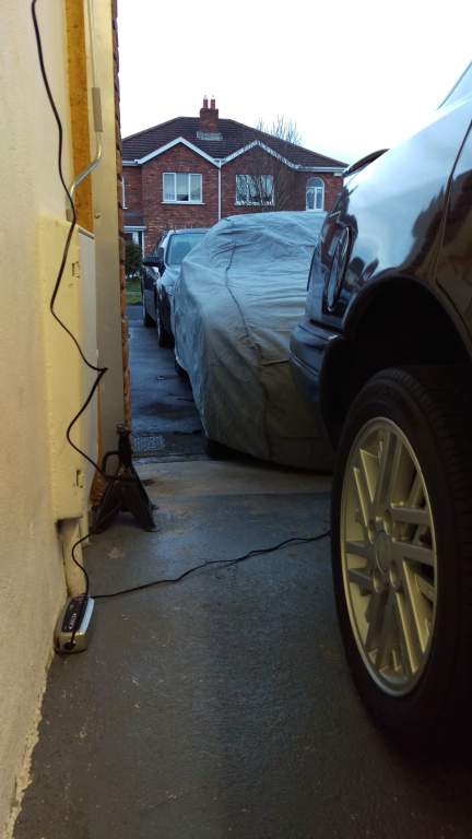

No salt for mine this Winter!
Washed, waxed, tyres inflated to 40 PSI, fuel stabiliser added, CTEK charger connected and covered. All that's left to do now is cry. Oh, and buy some dehumidifiers.

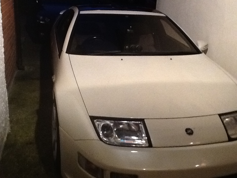

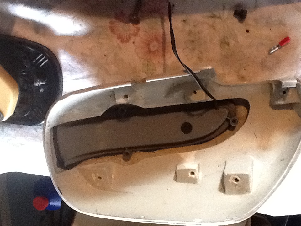

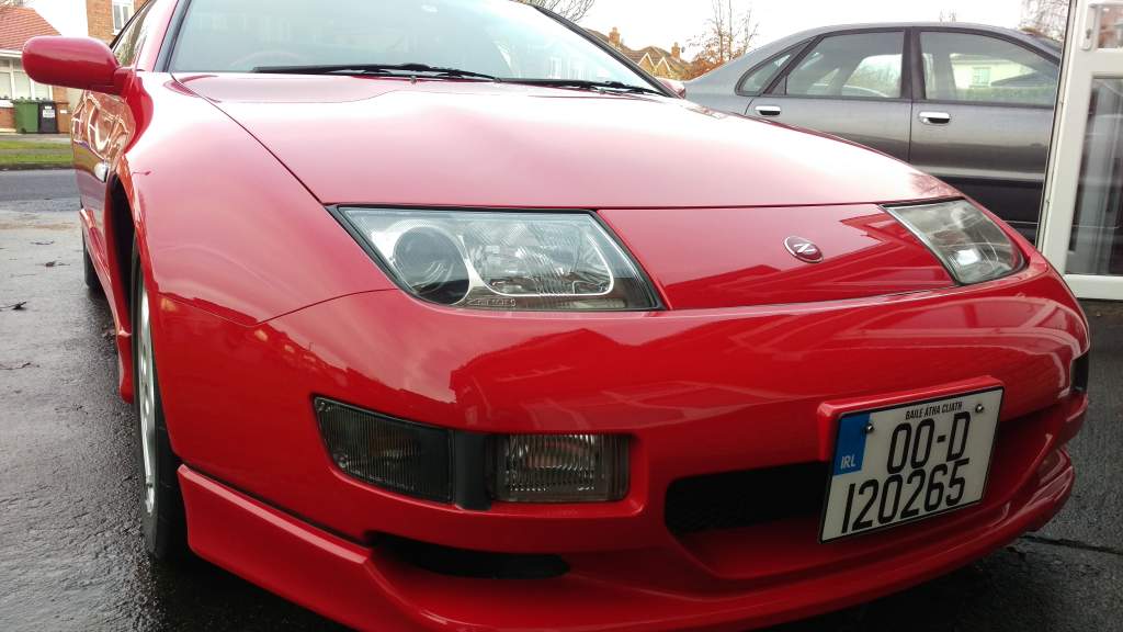

Productive day today. Installed HIDs and LED sidelights.
Sitting there having a smoke I felt it was missing something. So in four hours I created a two wiring looms and altered the indicator units to give me the US running lights.
I'm well chuffed with the result.

Make your own Dehumidifiers mate, saw this on a thread somewhere and tried it, works superbly, obtain some silica based cat litter (Wilkinsons stores sell it in bags) put it in old but clean socks, tie or sew the ends up and leave in car.. Works a treat, I even use em in my caravan when in storage..
Cutty
Cutty
Must check what kind of litter we have then!

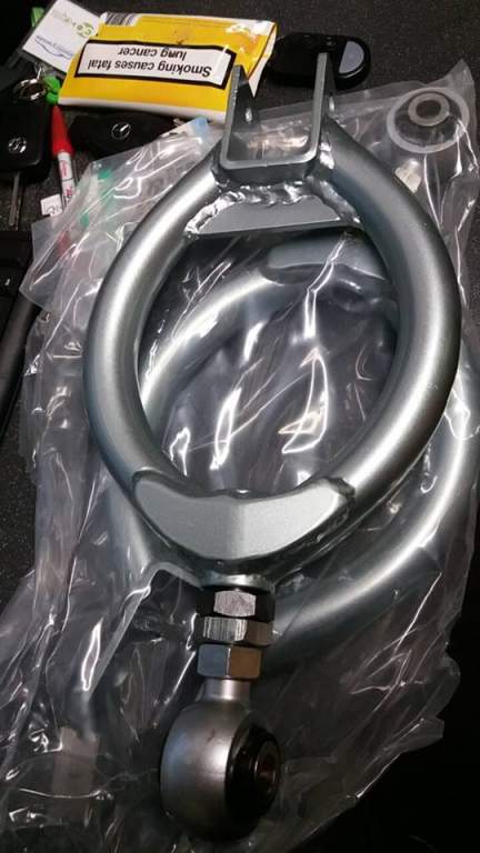

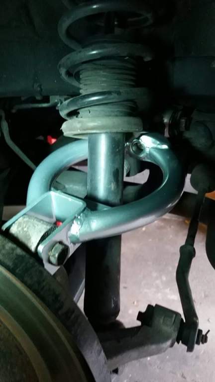

Just had an update from Denty on my annual service and stuff to be done/checkup
new camber arms
Fitted

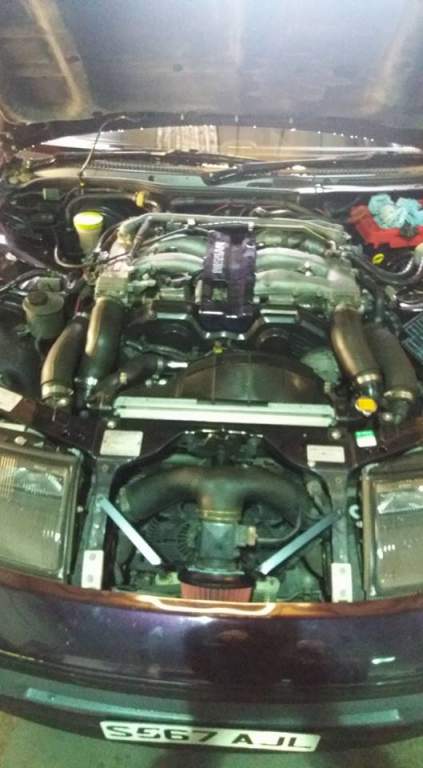

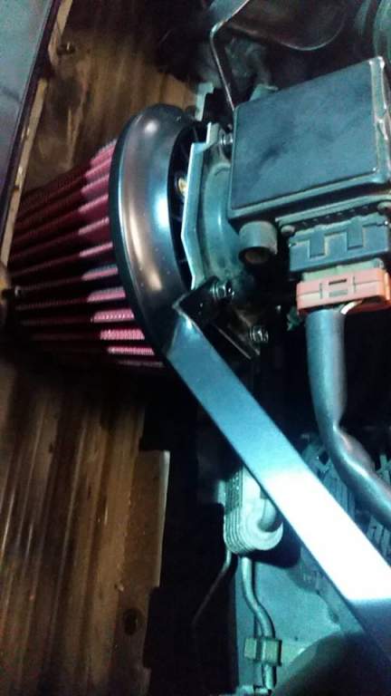

Apexi filter
fitted
trying out my cool gift from Nemiszx,
That contraband looks very familiar :innocent:.
Bracket supports for the cone, i don't have them so mine just kinda dangles - where have they come from......please enlighten me ?
