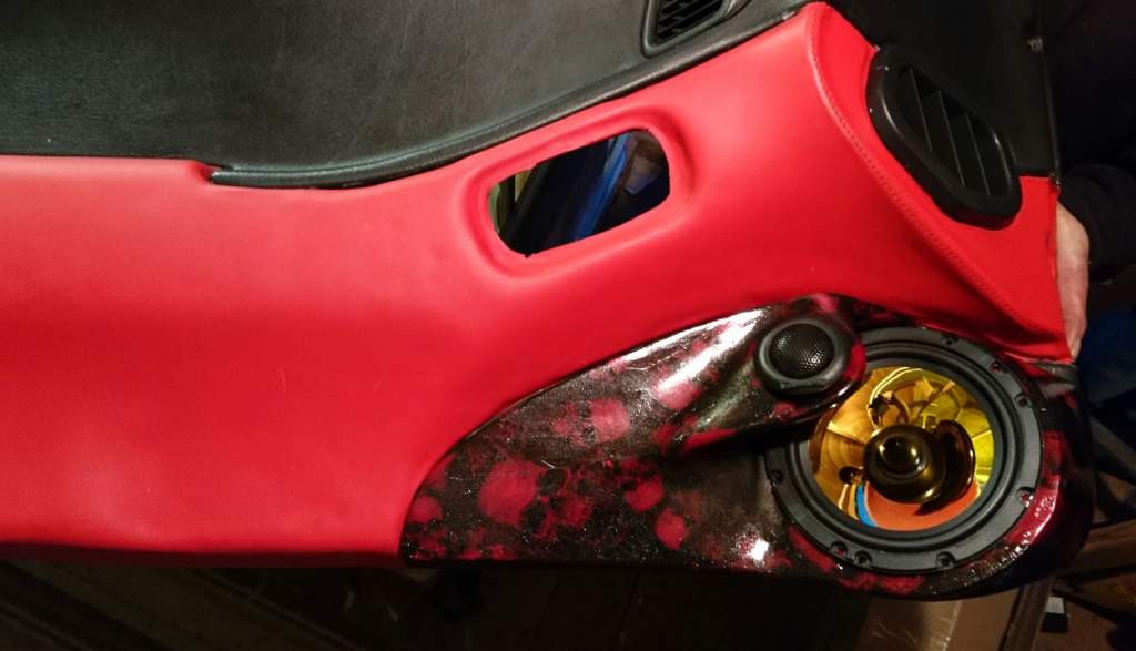

On a lighter note, I got to work on my door cards and speaker pods today.. Got the passenger side almost finished.. :lol:_20160904_201232.jpg
I'm thinking that looks nice..

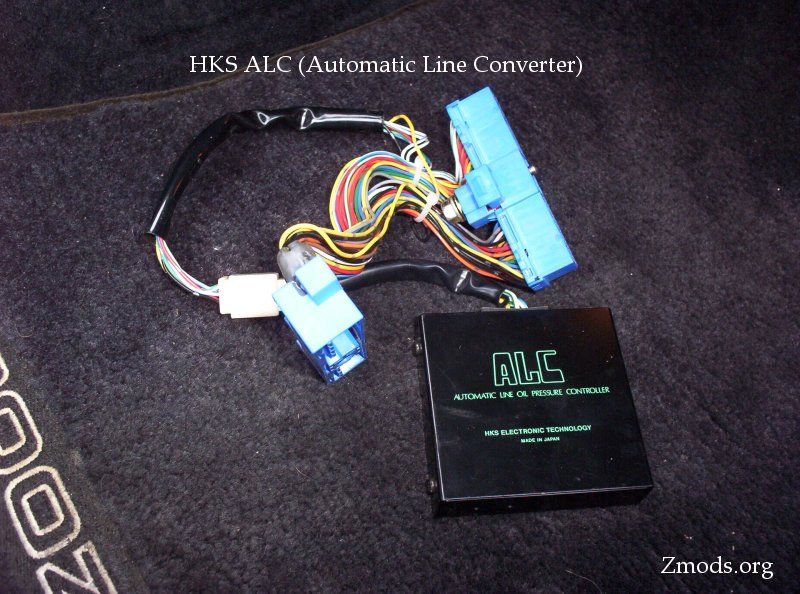

You haven't got any piggy back computers, like hks alc etc, that could be causing pressure issues.

Just thinking the amount of electronic goodies fitted to your zed it's possible it had an alc fitted, in theory they just keep the pressure up for faster changes ( I think that's what they do) it could be the culprit...
