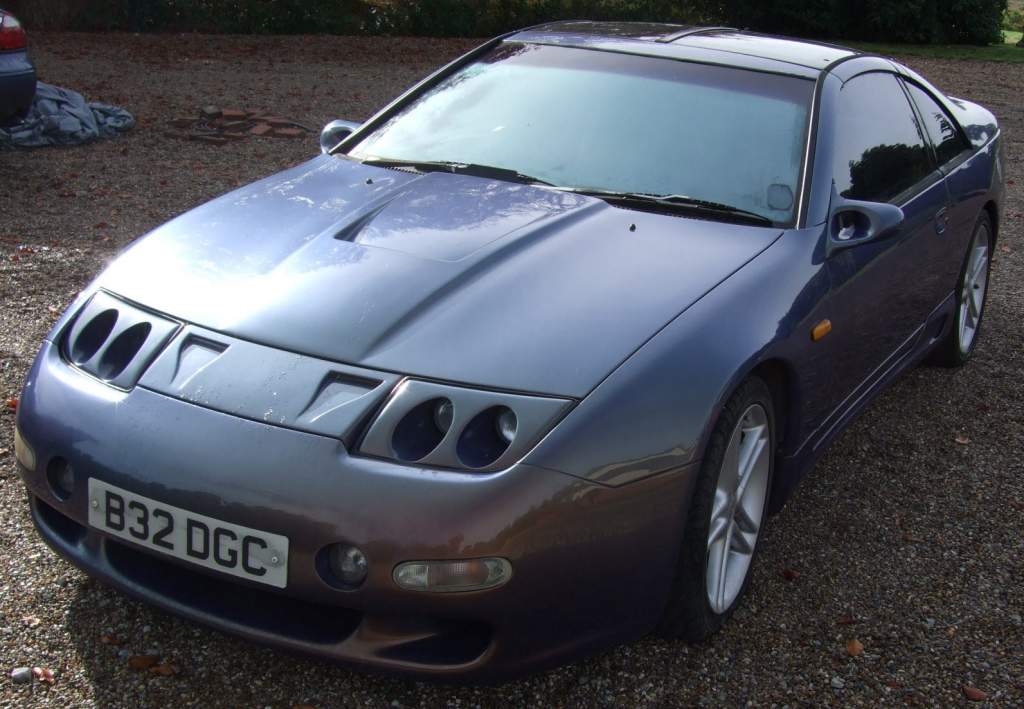

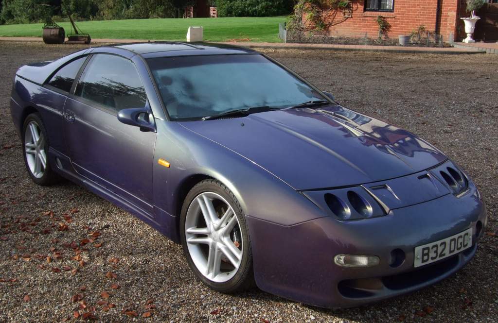

Bought this!
Come on, there's got to be something wrong with it isn't there?
EDIT: Its got corrosion :(
But looking at the specs, built motor upgraded turbos injectors, it will give your car a run for its money :p
Edited by Alic
Yep!
Its rotten underneath, but I want the engine then I'll part out the rest.
The engine should be good for 550bhp I reckon.

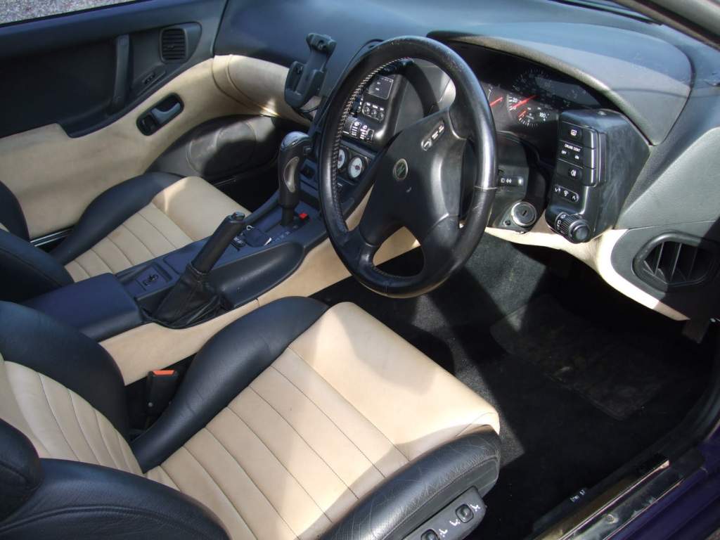

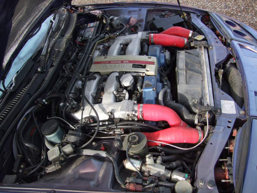

Chassis 18 Inch wheels Springs and dampers (Tokico + Eibach) Stillen Brembo brake kit Interior Full interior – magnolia and black leather with alcantara sides HKS gauges Greddy boost controller Engine Forged pistons, full rebuild, ported heads, new water & Fuel pumps SE hybrid turbos 555cc injectors Stillen intercoolers SE reprogrammed ECU Full stainless steel exhaust system Racelogic traction control Bodywork Paul Bailey front Tailgate conversion – smooth Rear lamp conversion Front quad lamp conversion Side skirts

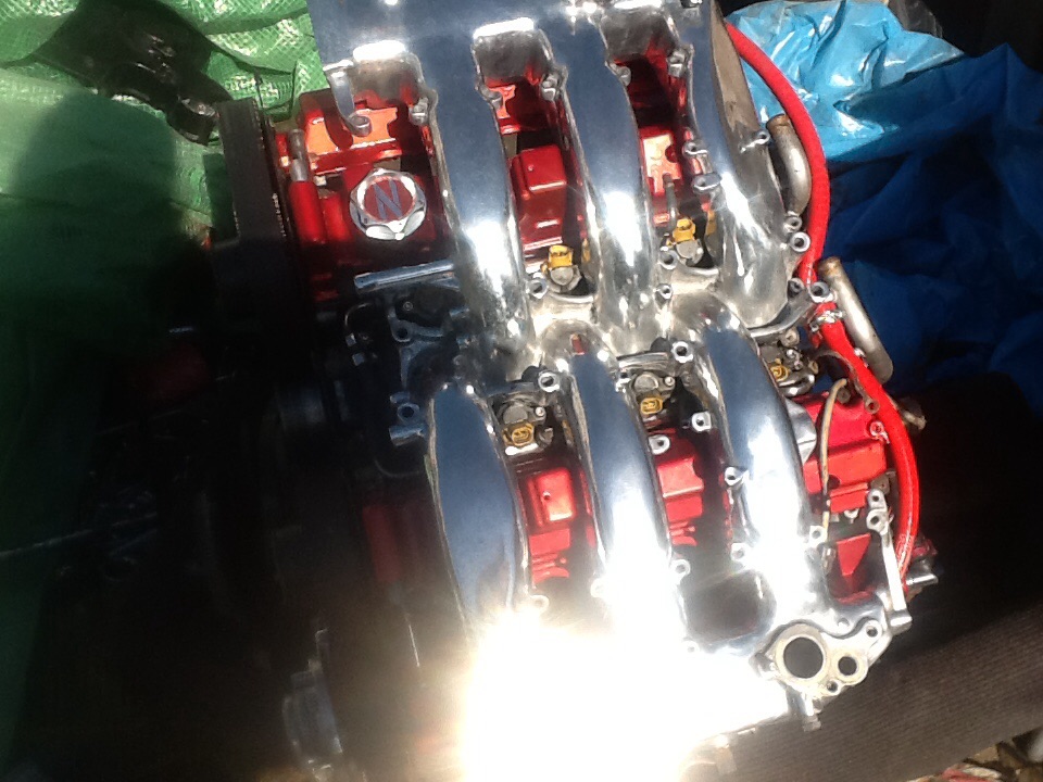

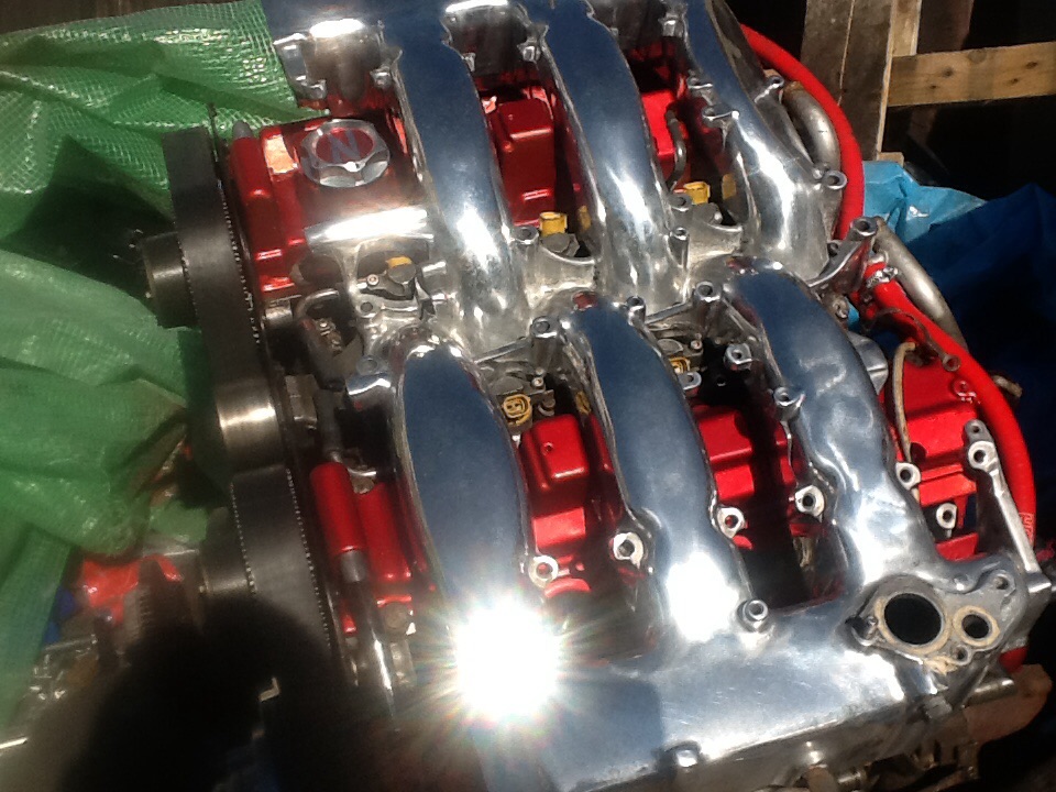

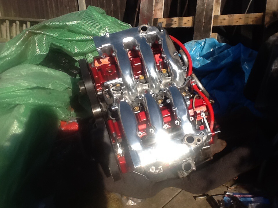

Well started on the engine again put some gear on to see what it wood look like clamped the hoses and put the injectors on so fare so good image.jpg
Great job with the engine Ted looks stunning!
Cheers Baz lets hope after all this work she starts ok or its a expensive paper Wight haha

Well started on the engine again put some gear on to see what it wood look like clamped the hoses and put the injectors on so fare so good [ATTACH=CONFIG]96701[/ATTACH][ATTACH=CONFIG]96702[/ATTACH][ATTACH=CONFIG]96703[/ATTACH][ATTACH=CONFIG]96704[/ATTACH]
That looks bitching Ted!!:bow: Nice work buddy:thumbup1:

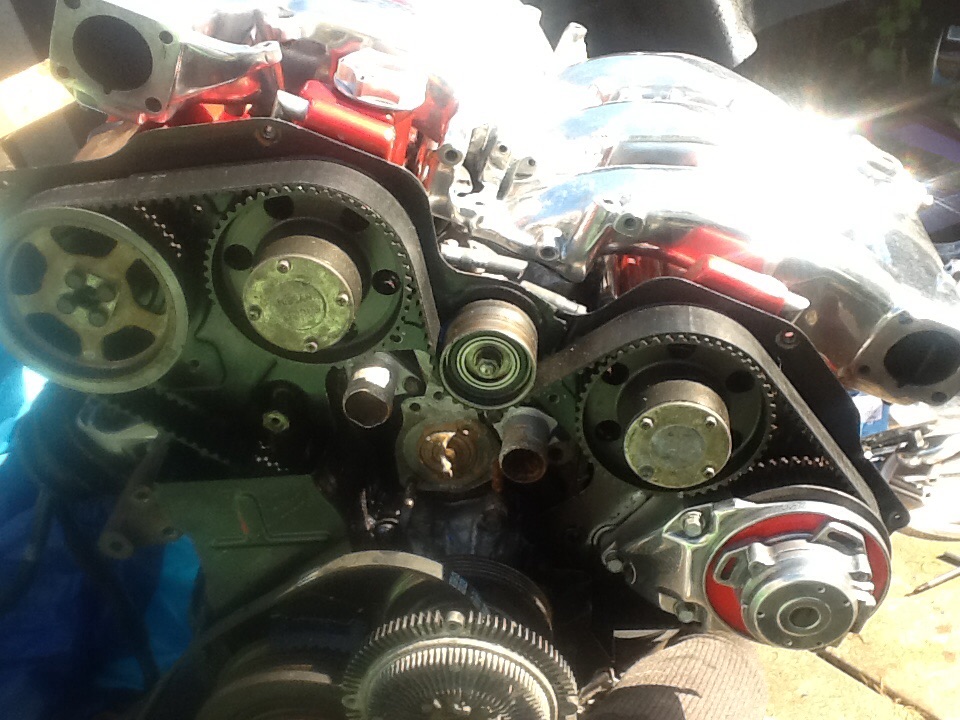

Had a scare :scared:
Crank angle bolt sheared just enough to unscrew it. Phew
