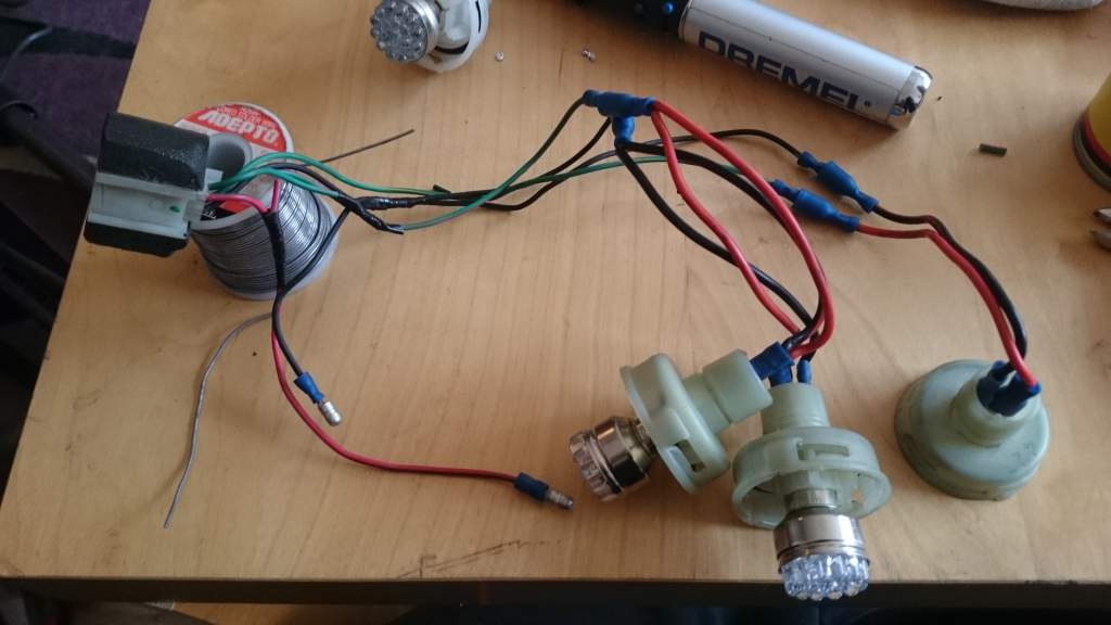

OK, got a tech question regarding the fog light conversion for jap specs..

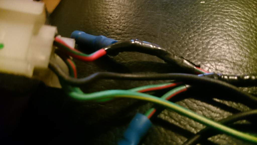

I opened the bulb access covers on my tail lights and found the red/green wire to my inner stop/tail light cut on the passenger side. I checked the driver side and can see that had been cut too but a live feed had been connected from the fog switch at the front of the car to the drivers side inner stop/tail light. I only noticed today but when the fog light is switched on,it also powers up my side and tail lights??? Is this normal?
I'm assuming that when I fit the venom lights to the car and wire them as they were supposed to be (ie original loom) I can then fit a seperate fog light in a different location and use the feed from the switch through the light and then down to earth on the chassis etc?

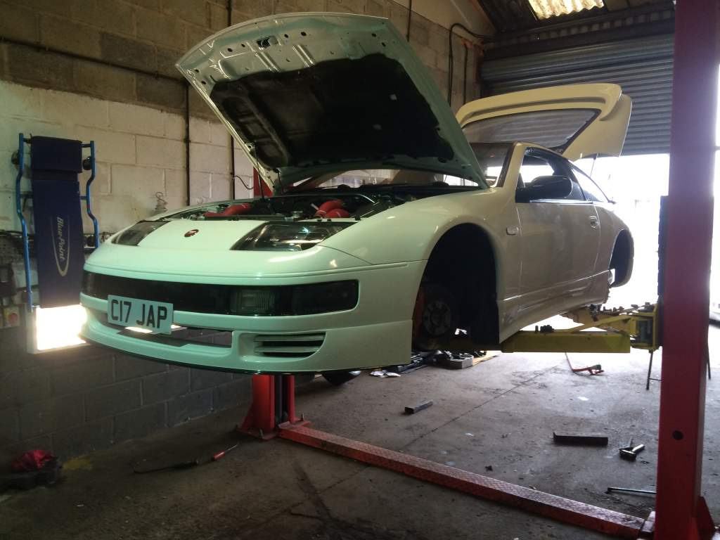

Had a good day at Lee Dents yesterday. He fitted my new Miester coilovers & a new power steering pump as the belt kept coming off. Also, as the car was on the ramp we saw the inner tyre wall on one of the rears had come away. Bit scarey as I'd just driven over an hour on it so had to get a new tyre as well. Car feels so good to drive now, still a bit bumpy on the rear but next job is to change more of the bushes but the coilovers have definately made a difference. Always a great day at Lee's, thanks again mate.

Just be careful because the loom in the car the colour of wires does not match up, meaning it's red/green on the stock short bulb harness but to it it's not red/green to it, and either side has a different colour, so please note.
Think the red/green wire actually goes to the reverse light !!
Quite common for owners to crimp on the live cabin switch feed to the STOP part for the fog light, put on one of the r/h bulbs, not bright enough on the 'tail' part. Fog could of been put on both sides to balance things up but only one on the r/h side is required for test.
Yes just ground your new fog and put the live cabin to it.
I would always use the top two chambers btw, on the reverse panel for the fog, that way all the 'red' lines up.
I'm using the original wiring harness plug from the stock lights Andy. The wires pictured below are the original ones from the light harness plug DSC_0207.jpg
The red with green trace goes to the tail lights. The green with red trace goes to the brake lights. The green with yellow trace goes to the indicators and they all share the same common earth (black)
I had noted that the cars harness plug is as you say, different colour coding. However I have stayed with the light harness original loom colours in order that I can assure I connect the correct wire that coordinates with the correct bulb holders and of course to stay true to the original tail light panels wiring code in the manual.
