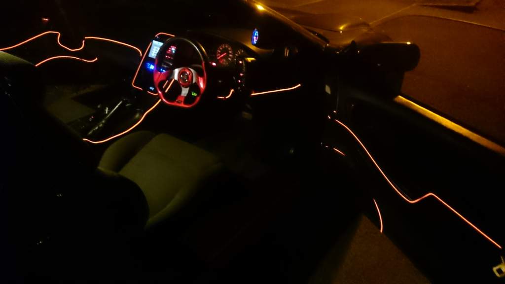

Well, finally got the sunshine so in perfect time got the return of Funkysi from the states, here is the completed interior lighting project I've been working on..

I finished the job at 2pm but figured it might be best to take the photos when the lights were visible.. For full effect ya know..

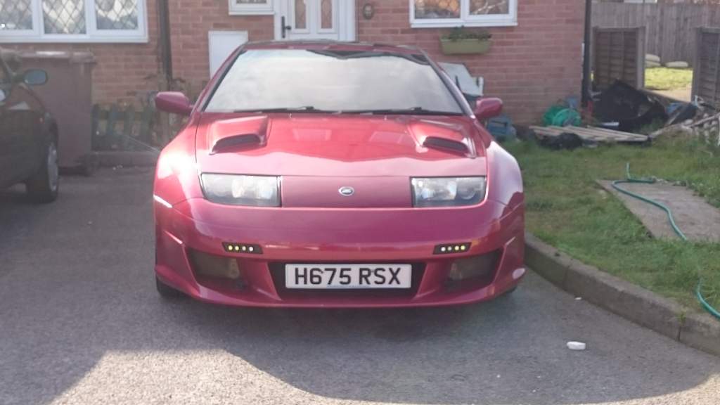

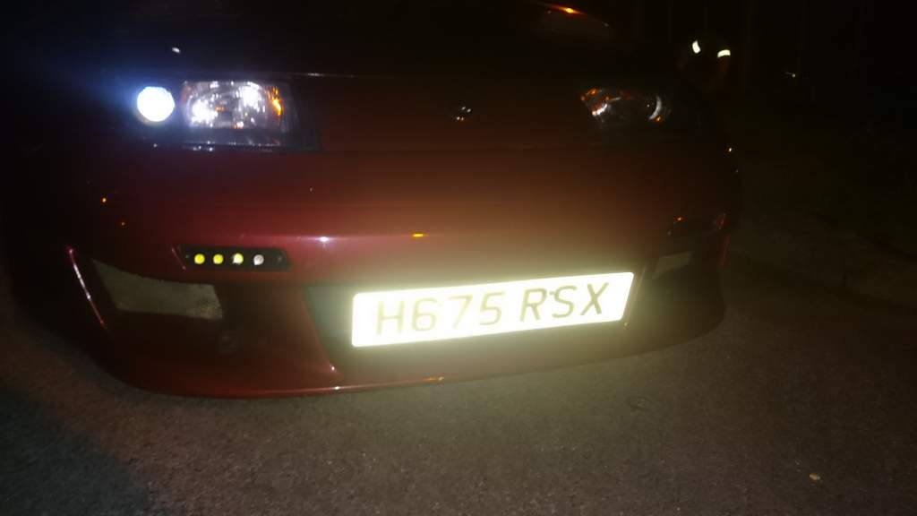

Seeing as the sun was shining I thought it'd be a good day to fit my custom made carbon sidelight/indicator panels.
The Abflug bumper on my car has a strange set up for the sidelights and indicators. The bulbs and holders actually fit directly in to the fibreglass on the back of the bumper and there is a plastic lens also built in to the inside of the bumper. The smoke cover is then screwed on to the outer edge of the bumper.
So first I removed the bulbs and then the outer cover. I had to drill through the inner lens so that it could be broken up and removed to give way to the wiring for the new panels.
After this I soldered the new connectors on to the wiring and connected them up. Asked my friend to switch on the lights and hazards to test. He did, I then saw the wiring to one of the indicator leds start smoking!! Unfortunately it turned out that one of the leds had an internal short and I didn't have a spare, so I rewired another sidelight in to leave me with 3 sidelights and one indicator.
Not as I'd planned but at least they're working.. As the sun went down I began to feel like an ice age had set in on my backside. So I gave up on the idea of starting the passenger side.. I tested the lights again, this time using the indicator stalk. I then find that the indicator is flashing rapidly!!! Aaaaarrrrggghhhhh!! after a chat with the God of lighting (phutumsch) I now need to buy a fast flash relay to replace the original manufacturer's equipment.
Fingers crossed the sun will be out again tomorrow so I'll get on and fit the passenger side and hopefully things will go a little better...
Picked Purple Haze up from LA Autos on Saturday. Lee and Sam have done a terrific job on the cavity wax (dinitrol) and I managed to translate the Japanese to get my sounds working correctly. Big thanks to Lee for all his hard work on her.
Well, got up this morning and finished fitting the light panels to the passenger side. Now all the indicators are flashing rapidly so got to get a fast flash relay soon or I'll be losing bulbs I think!
I'm fairly sure that the sidelights are gonna blind people though so might have to get some window tint and cover the sidelights? Hopefully it'll dim them enough or ill have to angle them down somehow..
Anyway, they're in and I think they look pretty smart.
