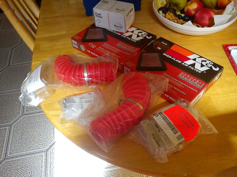

Picked up my order from CZP on Friday!
Didn't have a chance to fit anything as it was then off down south for the weekend. No problems with the Z whatsoever - and that water-resistant glass was amazing in the rainstorms on the motorway.
DSC00283.jpg[
Loving the xenons too!

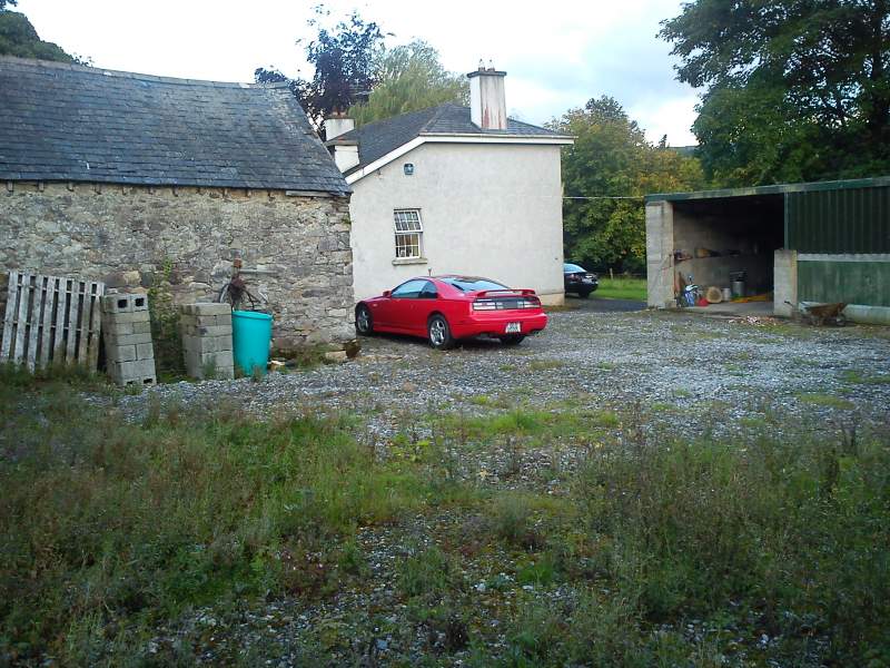

[ATTACH=CONFIG]90161[/ATTACH]
[ATTACH=CONFIG]90162[/ATTACH][
[ATTACH=CONFIG]90163[/ATTACH]
Those xenon headlights are fantastic when compared to earier models.
