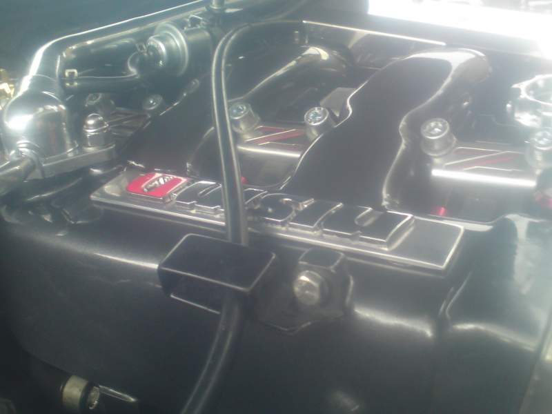

Having had my plenum powder coated so hence losing the TWINTURBO decal, i made a bespoke stainless plinth and then used a NISMO MOTORSPORT decal but i wasn't totally happy with the decal i applied, so when i spotted this front grill badge and after grinding down the fixing lugs i have used this instead, attached with some flexible heat resistant clear silicone.
It does in fact get covered 75% with my strut brace but here's a pic just prior to the re-fitting of that.
[ATTACH=CONFIG]82215[/ATTACH]
That looks really nice
