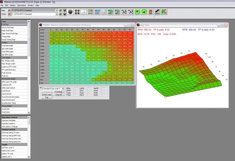

The ECU is in closed loop mode at idle above a certain temperature, ie O2 sensors are activated at idle:
For a stock JDM Auto ECU 41P13: O2 activation temp is 50°C; lean trigger voltage 0.21v; rich trigger voltage 0.58v
Let me know if you've got a different ECU and I can check the specifics.
The 2000rpm is an arbitrary value specified for diagnostic purposes in order to achieve approx 1 change rich to lean (or vice versa) every 2 seconds, and to ensure no other sensors (eg IACV) have a bearing on the results.
