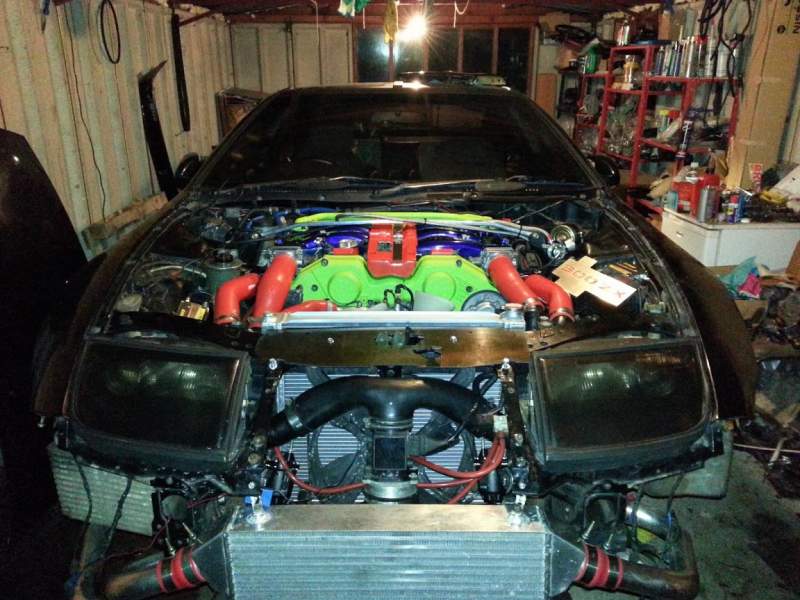

Im using FMIC becouse it was cheaper to buy, and i like the way it looks ;)
[ATTACH=CONFIG]69083[/ATTACH]
They do look good, my side mounts are old, so may just get a front mount.
Will I have to cut my bumper cause that is gonna hurt lol..
New 99spec in the box me with a grinder, heavy handed and all that u see the picture of whats coming lol..

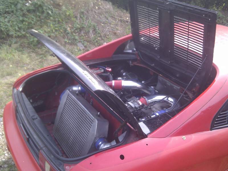

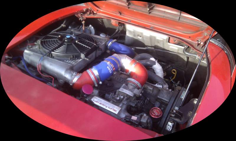

The only time I've made a car more "laggy" after modifying the intake was when I went from this:
To this:
It pretty much ruined the drivability of the car, but it was needed to cool the charge at 32+ psi :D
