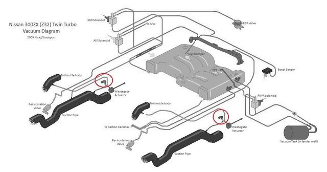

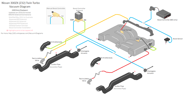

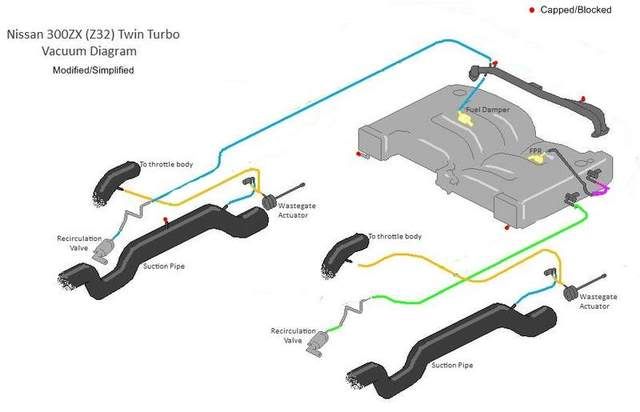

Rip them all off and throw them in the bin,
Theres a diagram somwhere to show u how to delete all the crap not needed.
I'll try find it or im sure someone else will come along and post the pic up..
These may help...
Standard
Boost controller
Simple
