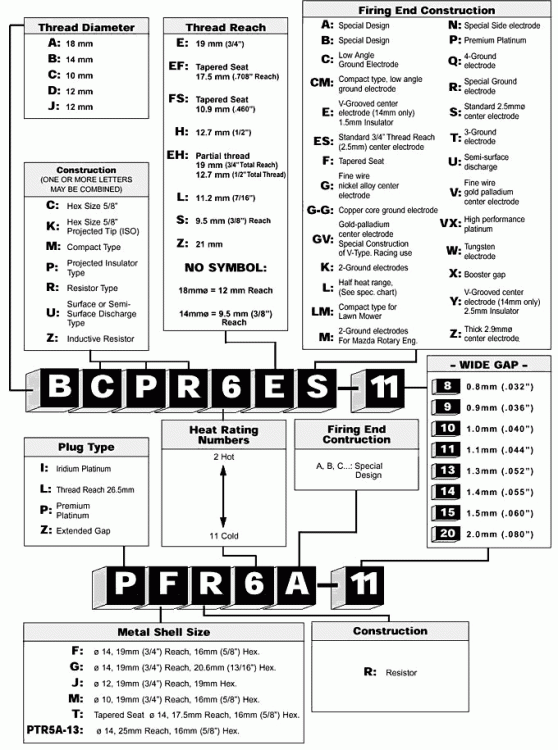

The spark plug number PFR6B11C the 11 part stands for 1.1mm gap.

The definitive answer is the biggest gap possible without the spark plug being blown out. On a standard car with standard plugs, you just use the specified gap, which would be 1.1mm straight out the box.
Running a 0.8mm gap shouldn't cause you any issues. How does the car drive? Is the misfire gone? Are you only getting stock boost with the intake & exhaust upgrades?

If they wern't B (US) or C (UK) specs, you had N/A plugs mate
smithy
Yeah thats right smithy plain 11s na plugs, I assume they were fitted asthere half the price.
