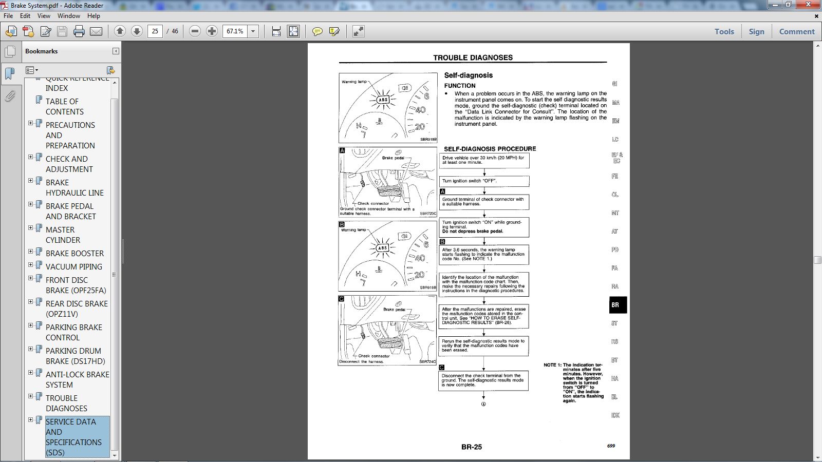

Ok if you read the whole thread properly you will see that I said this in the first post as I know other systems on the later zed use dash lights instead of the old led's on boxes. Thing is though the online manual I read didn't confirm this and only mentioned a led blinker on the abs control box. You must have a 94+ manual. You will have to take a picture of yours so we can all see.
Well im sorry, but you clearly havent studied the WSM properly (oh, there is no 94+ WSM AFAIK)
Clearly says that the ABS diagnostics uses the dash light. people are trying to help you buy saying that it may not be a bleeding issue and it would be worth considering looking elsewhere for a fault.... otherwise whats the point in asking for help....

Looking at the brakes today and a look over the manual again. This is the BR 25 page I am looking at not that one above.
Regardless I have no reason to suspect an ABS fault at current was just highlighting that the system if different on a 94+.
