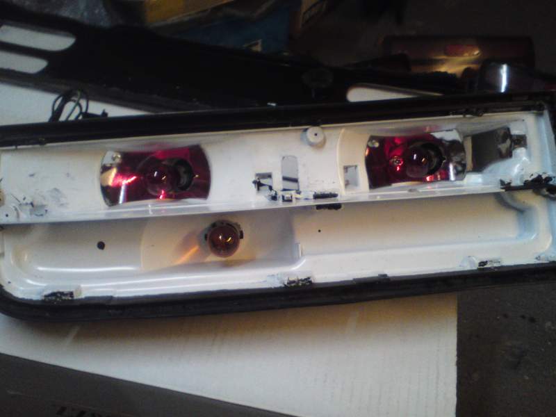

This isn't particularly related to the 99 spec lights but seeing as I have loads of carcasses and have had loads of tail units through my hands I did save these chrome inserts from a set, now don't ask why I have some of these as I have found nearly all do not and I only have these and no more.
I have also found that without these the white paint inside around the bulbs as flaked or burnt off on many units.
Primarily there job would be as a heat protector as the brake filament bulbs get very very warm but of course do have reflective properties although I have not visibly noticed a difference, the small one on the end is a bit of a mystery piece.
Anyway FYI, I have now done away with my led conversion and gone back to stock bulbs :cool3:.
