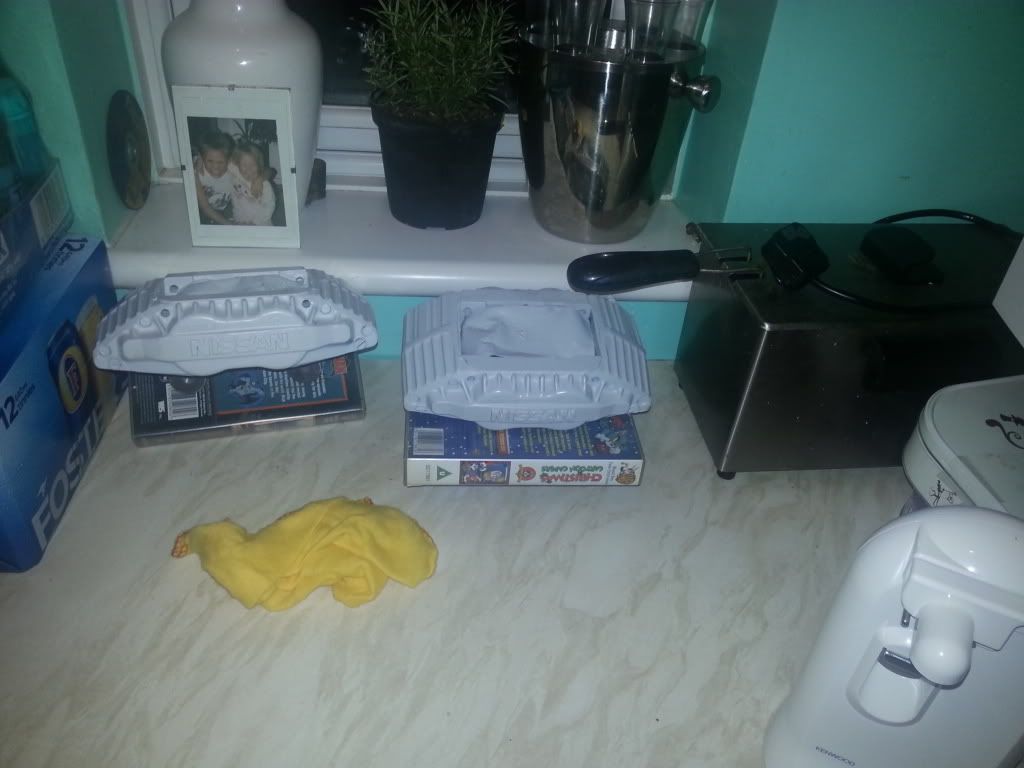

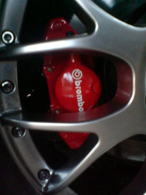

January 10, 201313 yr Did mine. Rub em down, primer them with red hammer ute primer then red hammerite spray and bake in a normal oven for an hour and leave to dry over night, the paint should go hard. Hammerite takes ages to harden without some heat. See finish product below ;)
