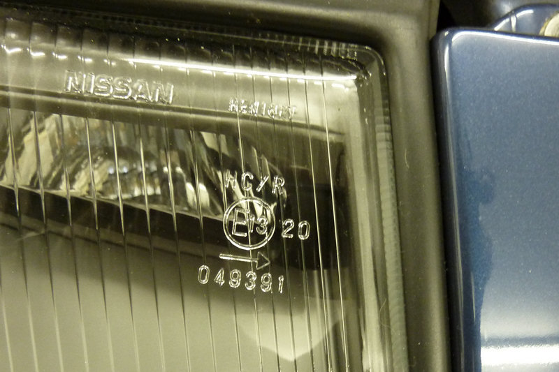

This is the marking on the O/S headlight of my UK Z:
Assuming you can get some power to low beam bulbs then the beam pattern with tell you which is which:

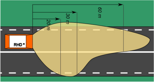

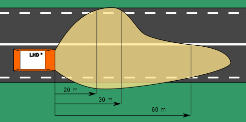

Below is an average UK beam for right hand drive, its angled to the left to avoid blinding oncoming traffic.
The left hand drive would be the reverse of this.

OK, fair enough, the site I got it from was actually wrong and I understood it wrong too !:mad2:
I think the sight I got it from got right hand drive mixed up with right hand traffic
Here's a Wikipedia link showing it the correct way.:whistling:
http://en.wikipedia.org/wiki/File:Low_beam_light_pattern_for_right-hand_traffic.svg

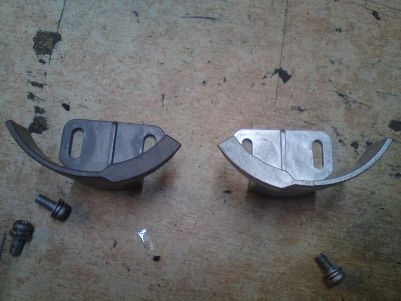

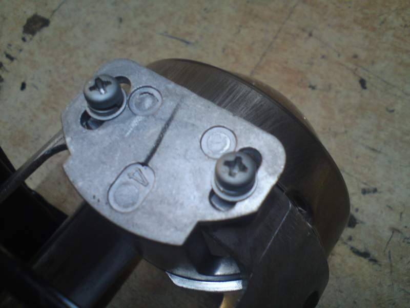

Having been sent a set of USDM headlights that differ greatly from our JDM or UK's.....they have 3 nipples on the lens for a start which as far as i am aware serve no purpose, the adjustments is bizzare, it seems the whole unit moves up and down as opposed to individual housing ones and boy they're heavy contraptions !!
One thing that is the same is the projector which leads me on to why i am posting.
I need to migrate over the LHD shield out of the USA units and into a JDM set of headlights.
Therefore this pic shows them, the USA one hence driving on the right, is the shinier one on the right, the same shape shield is fitted both sides.
The shield adjusts, i find these in the middle of their travel so this is where i put them. I have tried a little rig up with a standard H3C bulb and in positions nearer and then further away from the bulb and didn't notice any difference against the inside of my garage door.
Hthey have 3 nipples on the lens for a start which as far as i am aware serve no purpose
The nipples are for the headlight aiming tool:
http://www.twinturbo.net/nissan/300zx/forums/technical/view/1092270/Utilizing-the-Headlight-Aiming-Tools.html
