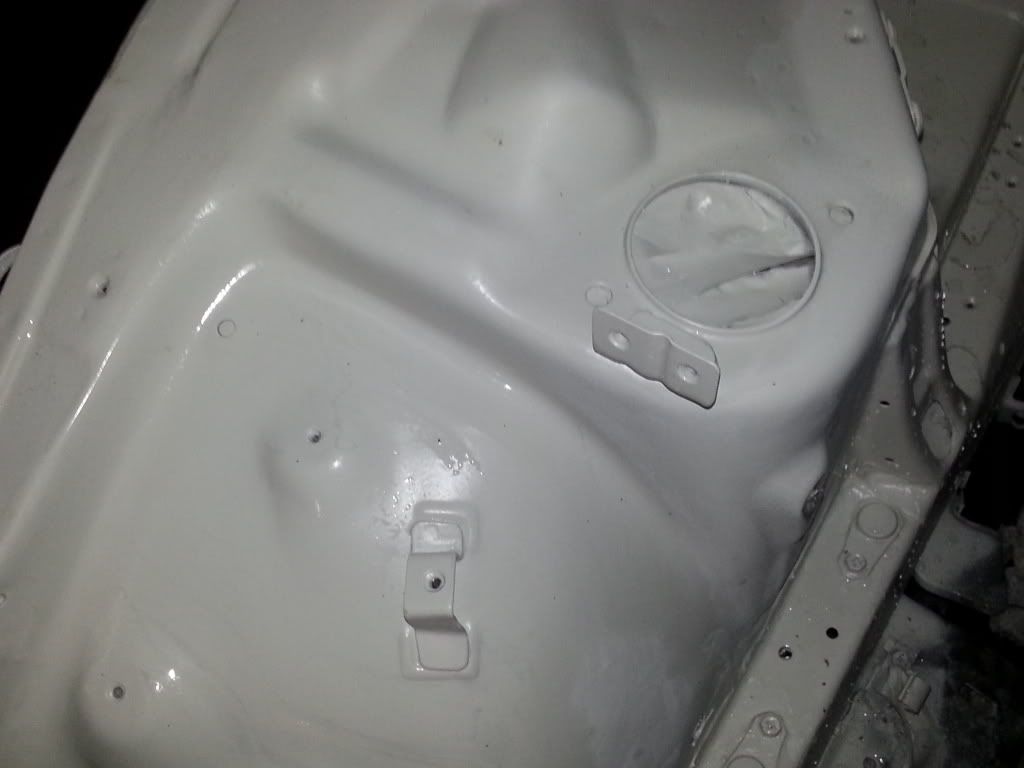

Primered engine bay yesterday, and was happy till I got home from work,
Seem to have a reaction problem, I used dinitrol stonechip that is overpaintable on the chassis rails either side of engine bay at the bottom and the area where battery tray is plus the opposite side, thought it may be a bit harder wearing...

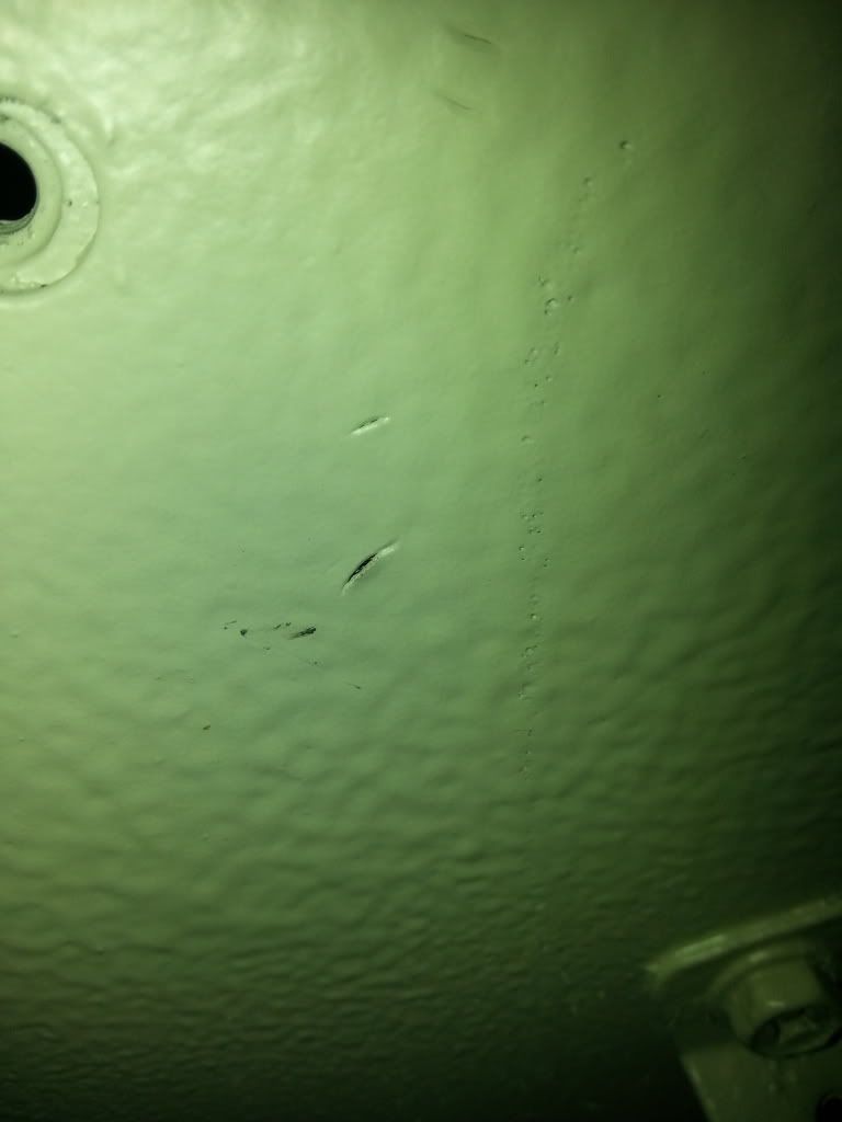

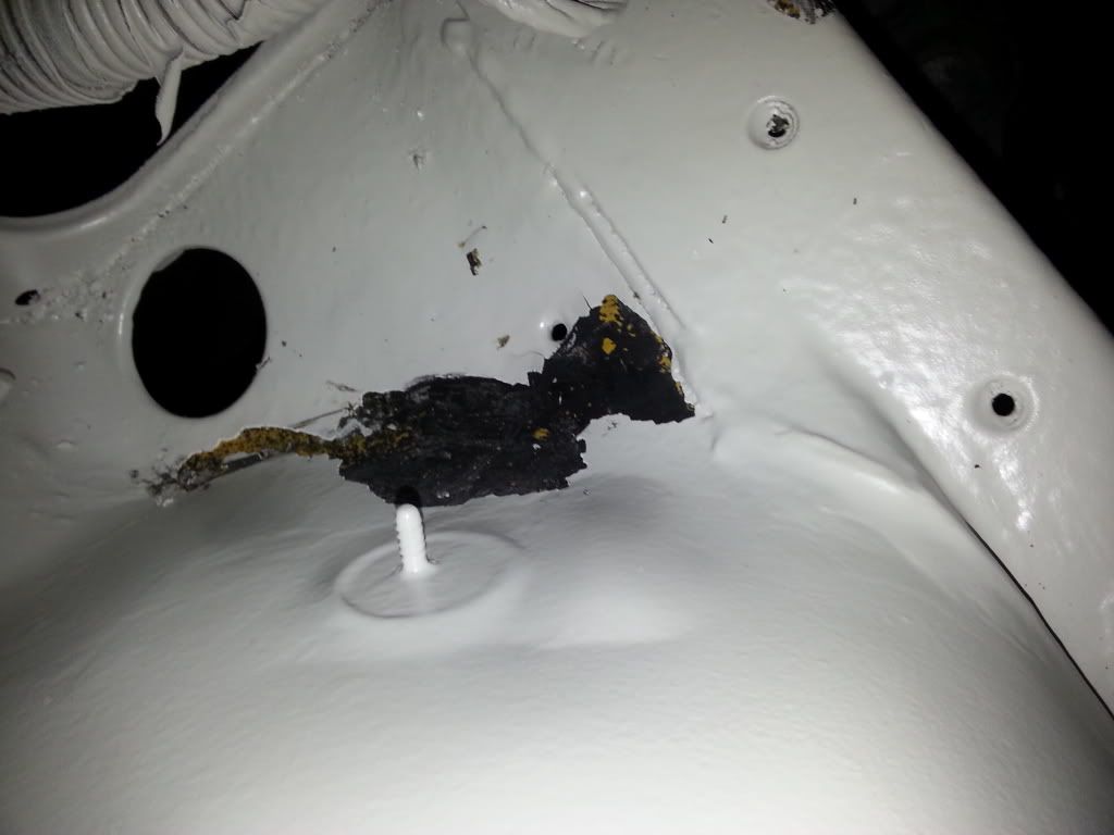

Stonechip was dried for maybe couple weeks before it got painted over, came home had a bubble so picked it and it pulls of in lumps has u can see in one of the pics, the stonechip is soft and sticky now so primer has reacted somehow,
The other pic is where I have pushed my finger nail in, all the rest of bay is rock hard and won't scratch just where stonechip is.
Really pi@#ed off, will it dry or will I have to remove it all,
Even know it's on places u don't see don't want to risk stuff happening down there and it chipping off,
It's etch primer, dinitrol stone chip overpaintable, and 2k high build someone please tell new what's happened I'm so depressed lol.

If it's a chemical reaction between the 2 it may have to come off, although it may be that there were just a few small patches of stone chip that hadn't fully cured

U reckon it Will cure under the 2pac or just take it off,
Should have dried cause its been couple of weeks, and was not soft like that before primer.
Only thing I can think I may of done is put stonechip on to thick, or primer on to thick and sitting on stonechip to long wet and soaking in.

I may be wrong but doesn't 2K paint react with 1K? Maybe need a barrier coat between the two.

Before spraying any 2k, over any unknown paint type i spray a sealer coat, which is clear, but it seems your underseal hasn't cured in the thick areas and the 2k has got under it and reacted. scrape off and remove the affected area and put a thinner coat of dinitrol on. Putting coats of anything on too thick will always struggle to cure under the preceding coats.

Especially good for our Poly bumpers where crazing and cracking repairs have been done. I tried just 2k high build primer on the rear bumper and a week later started to show the stress lines, due to reaction from the 2k, bare in mind i didnt rub it down to the gel coat, which if i had done, may not have reacted with the previous paint.
A couple of coats of bar coat sealer, prevent this happening as its fast drying. It looks a whitish opaque colour in the tin, but once mixed with hardener and dried it goes clear.

The low temperature may have had an adverse effect on how well the stone chip and top coat cure.

thats my thinking too...the stone chip is a long cure type of coating at the best of times given its elasticity so cold and put on thick and its going to take a good while to cure

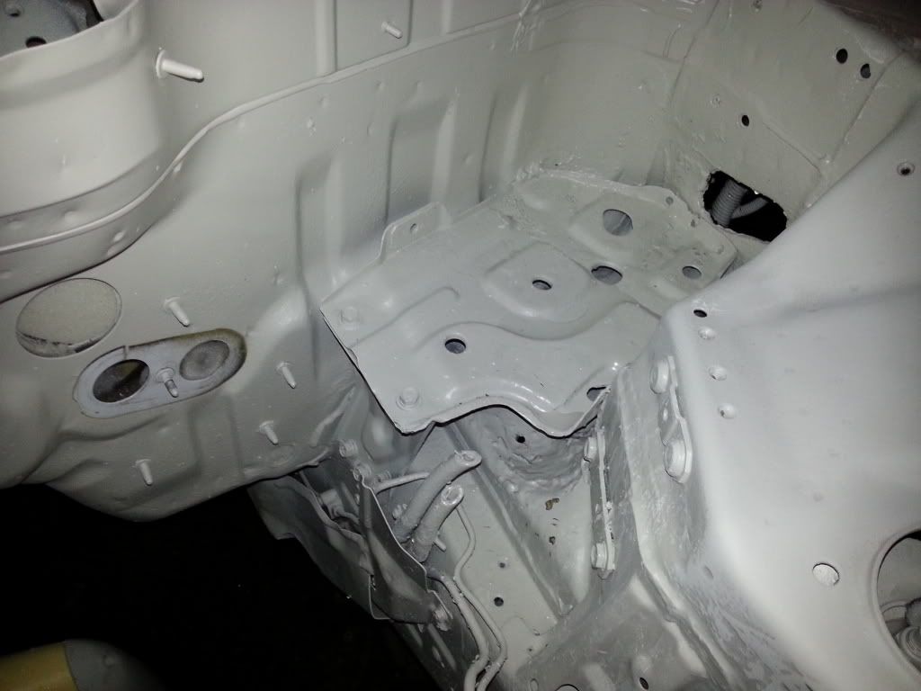

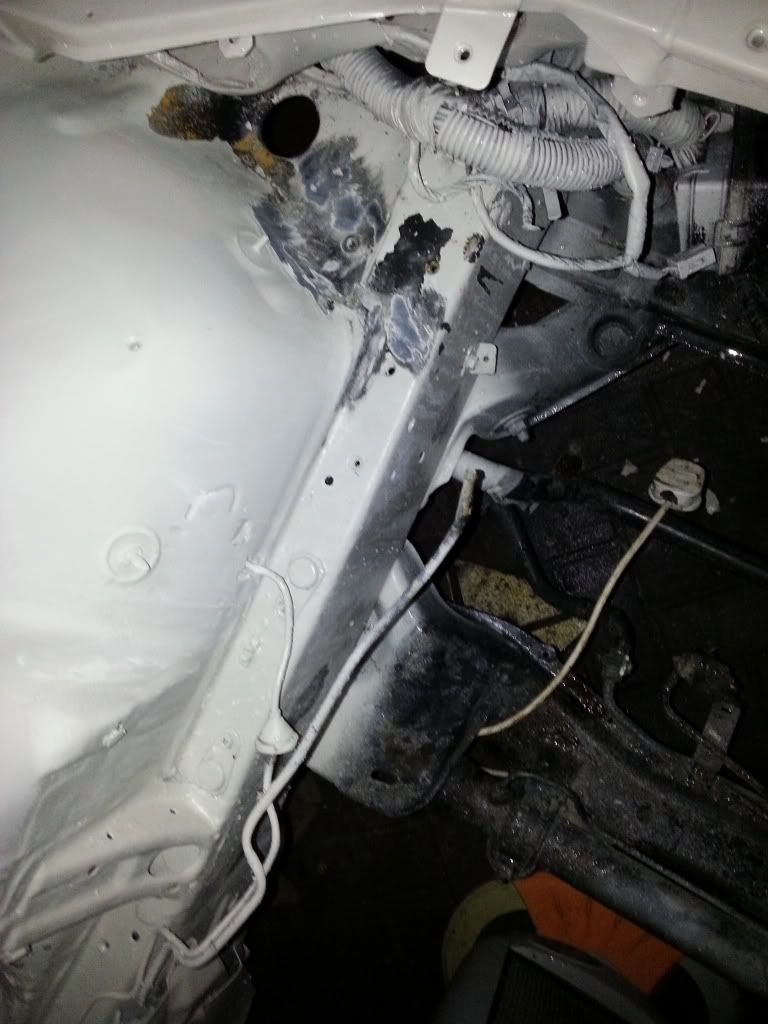

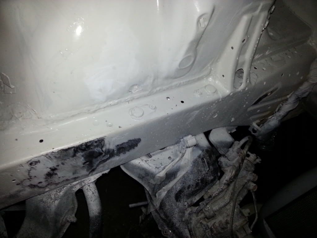

I started taking stuff off tonight, its coming off easy where its sticky underneath,
So shouldn't be to bad atleast I noticed it now, not later when engine is in lol.

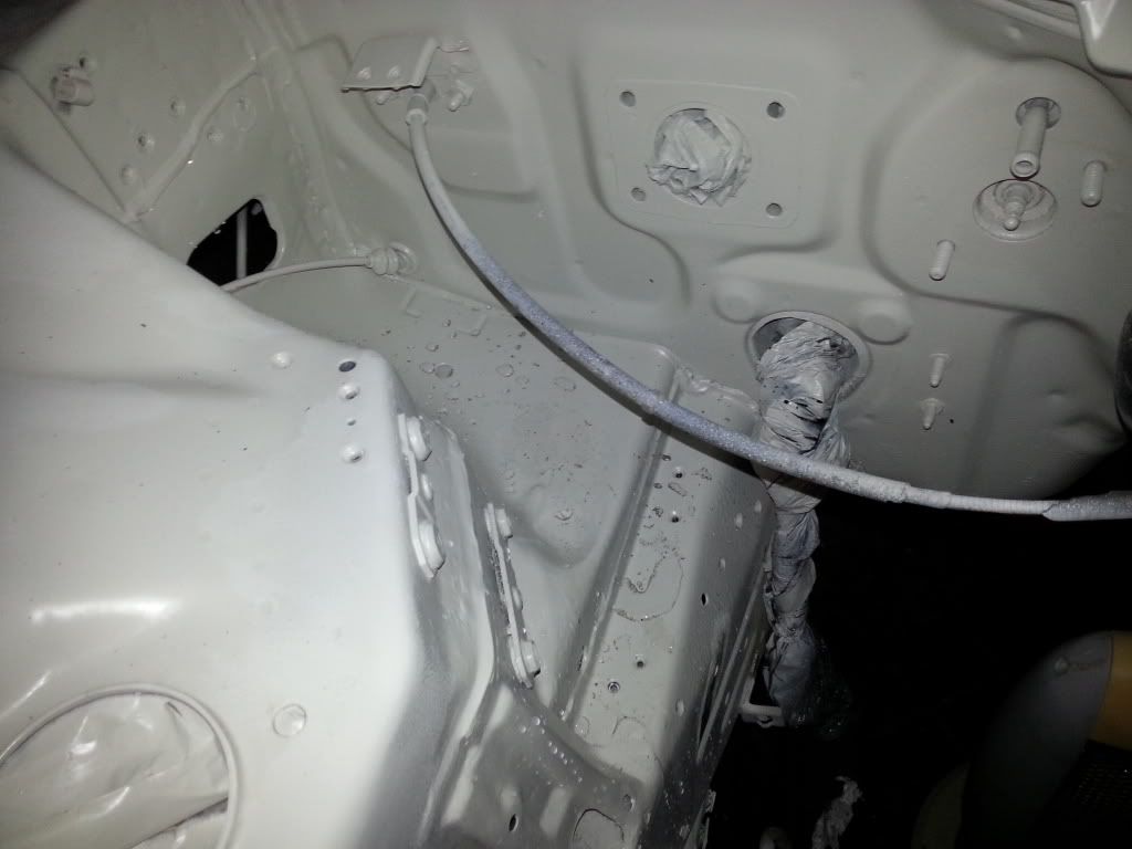

Pics above are where I got to take the crap off so only the places u dont really see.
Atleast this bit either side is ok and the tops where shocks bolt to are fine too
Even tried flatting the top parts see how hard it is to sand before top coat and is easy,
By the end of weekend this stupid engine bay is gonna be painted and I mean in top coat has well lol. Pics to follow.
I know I got over spray on cables and stuff, dont worry I got replacements for them on spare zed, and the loom gonna re electrical tape them, so wont look like that once finished...

Yeah was outside, and with it so thick I messed up bad lol.
Just gonna remove stonechip from engine bay area, was one of those crazy rust proof ideas that came in my head to spray it in these places thinking it will be hard wearing.
Didnt have it there from new so think its best just take it off and have primer and paint, no stupid stonechip...
