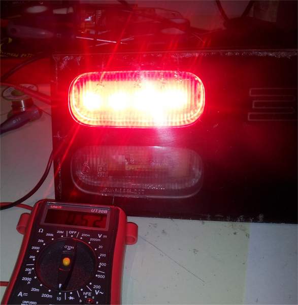

OK here we go version 2

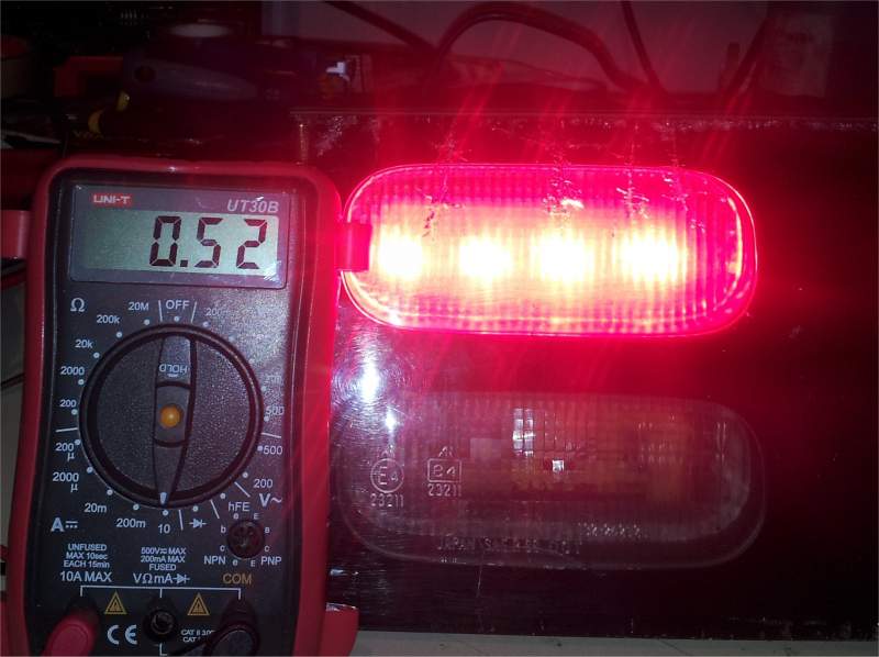

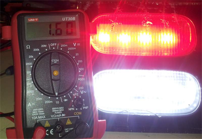

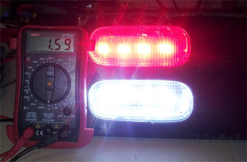

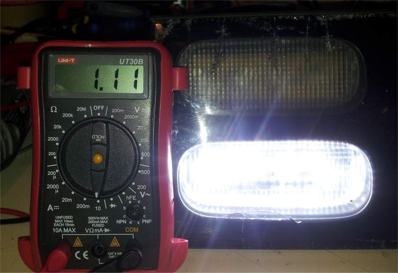

The fog lights show as four distinct LEDs (they don't look yellow like the pic - that's just my camera makingh it look like that) and are really bright
The reverse lights are mega bright! You can't even see the individual LEDs
Four white and four red LEDs now used
The meter shows the current drawn approx .50 amp for fogs and 1 amp for reverse
Hows that looking?

Why is there a difference between the white light and the red Rich, I do know the camera does lie but you've used the same type of 'bulbs' I believe ?
Yeah I agree Andy, it needs some way to diffuse the Fog lights but it is not easy to do.
Though to be honest it does not look too bad with the four red dots. The Reverse light also has four white dots, however that light is so bright it is actually painful to look at for more than a fraction of a second so you don't really see the individual LEDs. Although these are all 3Watt LEDs the White ones are about 180 lumens of brightness and the red ones about 80 lumens.
I don't think a diffuser sheet would help a lot as one of the other problems is that the fogs LED pcb must be mounted close to the clear 'window' to get it to fit. That is because there is less space behind the two top reverse lights than there is between the two bottom ones. I fitted the fogs PCB into the top 'windows' as I walso wanted it to double up as a brake light repeater when the fogs are off, so it only looks right if mounted in the top.
I originally tried with the PCB mounted further back in the bulb enclosure but it only lights about 3/4 of the aperture as the last part is covered with plastic and it did not look right.
I then cut this plastic away to illiuminate the whole aperture but because the hole in the metalwork of the Zed is narrower than the reverse lights 'lens' it means the PCB must be mounted very close to it otherwise it would not fit. You did mention that the Zedwizz PCB also mounted by cutting away part of the plastic on the rear panel. I've never actually seen a Zedwizz PCB or how it mounts so would be interested to see if they had the same issue and how they got around it.
It is not so much a problem with the reverse lights which fit into the bottom 'window' as there is more space, and you don't need to cut away at the plasticc on the back panel either. So not only are they much brighterthey are also mounted further back.

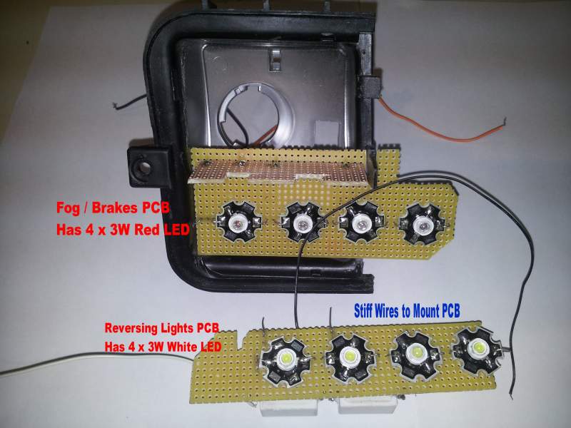

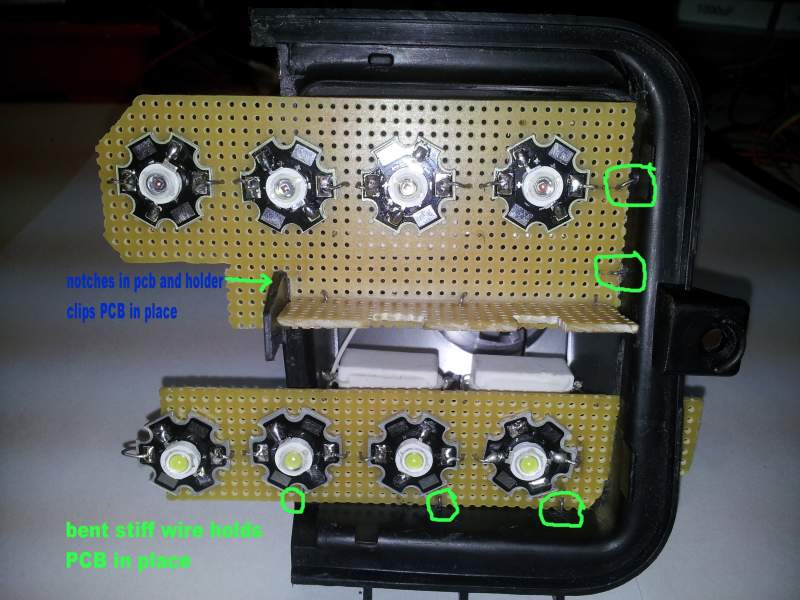

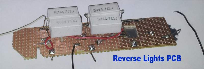

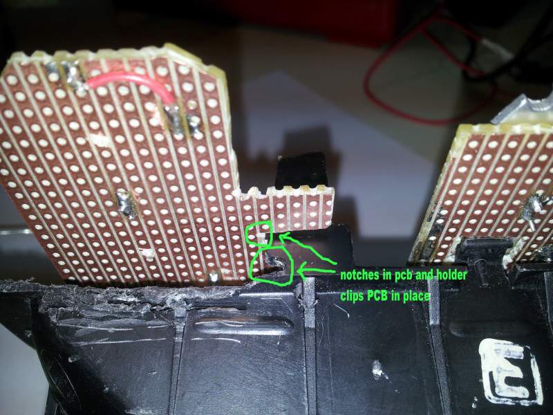

All this will be much clearer if I post some pics so here goes. This is how I built it.
The vertical section of PCB is there just to act as a divider so the LEDs only illuminate the correct aperture
I need to upload a clearer picture of the rear of the reverse lights PCB so you can see track cuts and soldering (if anyone wants to have a go at building this) just let me know
The Red fog LEDs are all wired in one 'daisy chain' of four LEDS like this
+12V --> 4.7ohm 5W resistor --> +LED1- --> +LED2- --> +LED3- --> +LED4- --> Ground
Note the LEDs have a + and a - and all need to be the same way round!
The white Reverse LEDs are wired like this (two daisy chains of two LEDs)
+12V --> 4.7ohm --> 4.7ohm -- > +LED1- --> +LED2- --> Ground
+12V --> 4.7ohm --> 4.7ohm -- > +LED3- --> +LED4- --> Ground
This is because the red LEDs have a 'forward voltage' of about 2.5 Volts each so there is plenty voltage to supply all four (4 x 2.5 = 10V)
The white LEDs have a 'forward voltage' of about 3.5V so if you wire all four in one chain (4 x 3.5 = 14V) there is not enough voltage to light them properly
This is also why the red LEDs draw about 0.5A and the white ones about 1 Amp (0.5A per 'daisy chain')
I used 2 x 4.7 ohm 5 Watt resistors in series for each chain of two white LEDs, beacuse that is what I had lying around - it would be easier to use 1 x 10 ohm for each chain instead - but make sure it is rated at 10 Watt
