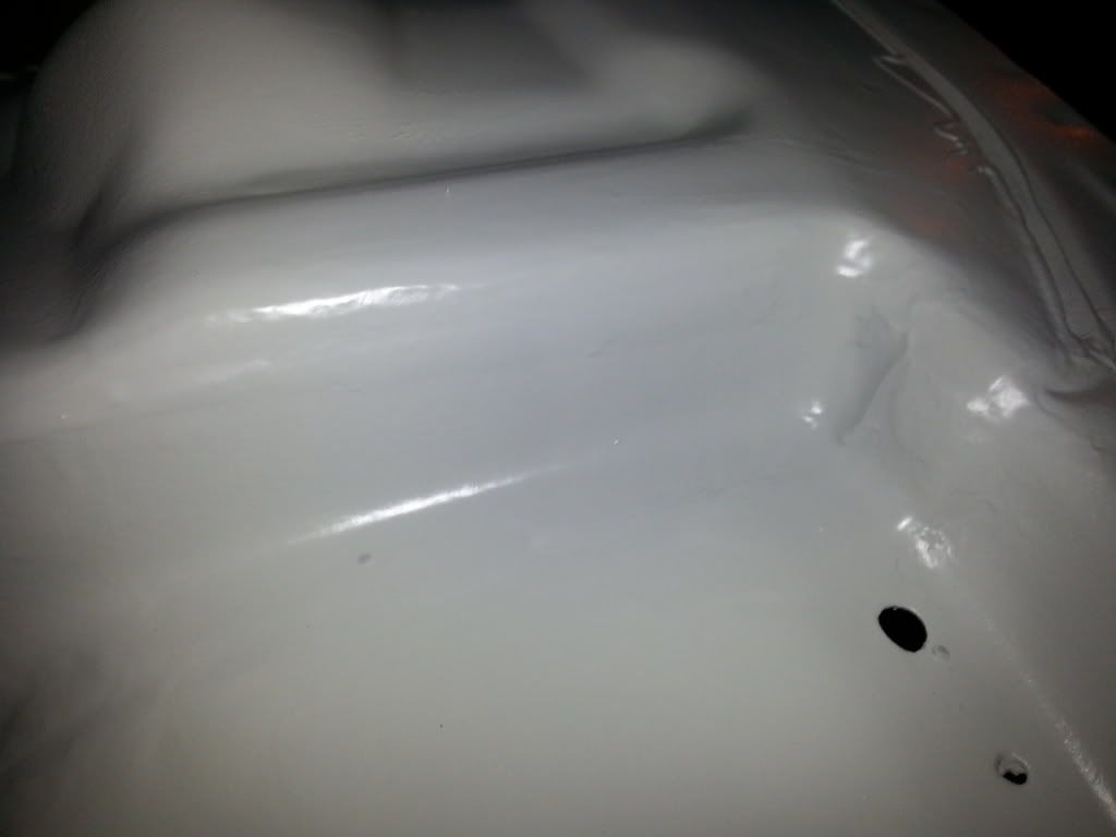

So now the passenger side I put a thin bead of sealer on and with my finger and thinners smoothed it out which looks better but the side with seams welded up looks so good it makes the original look crap..

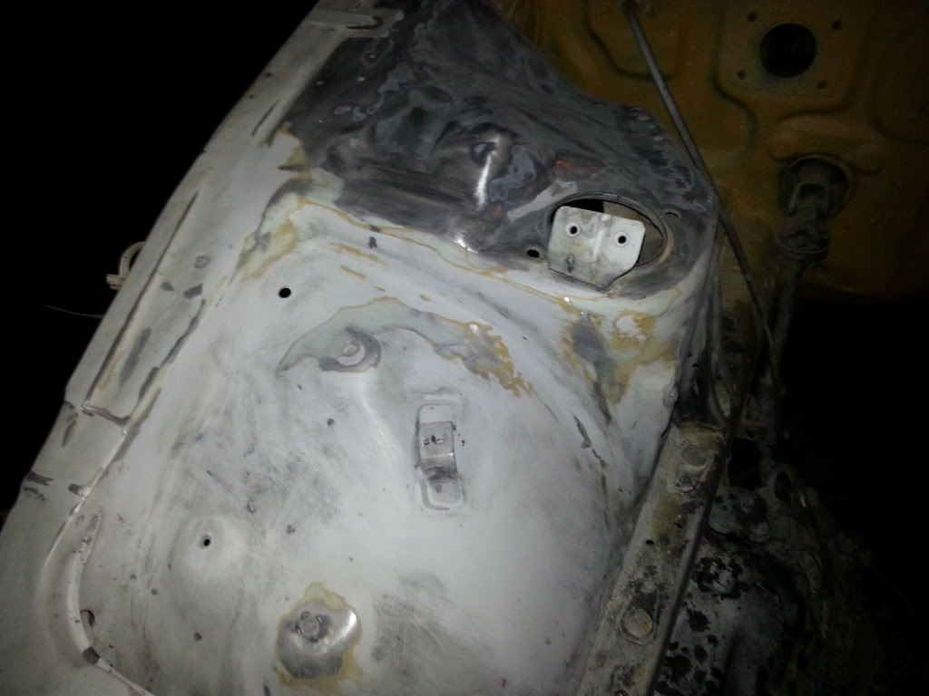

Here's some pics what would use do just leave it has it is, weld this side up and 're stonechip arch etc , or any tips on another way to make seam sealer more smooth..

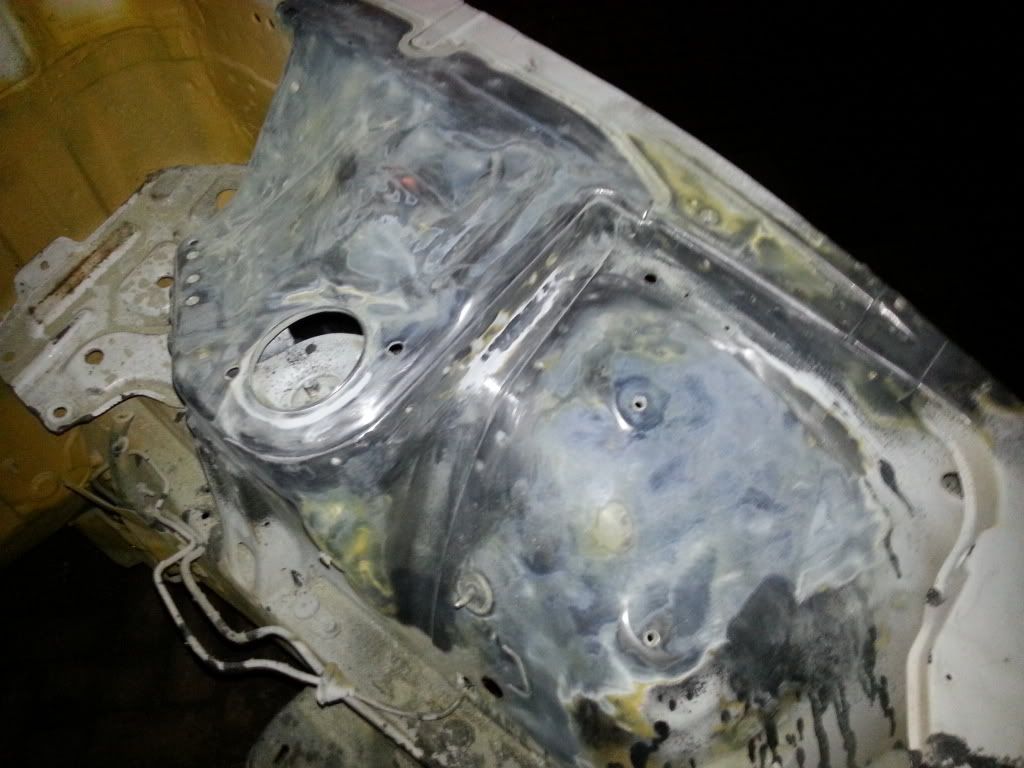

This is the side I welded up and smoothed out

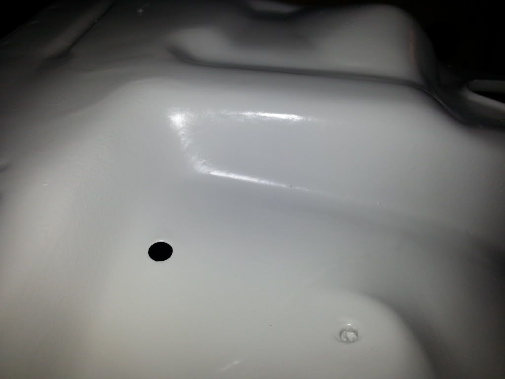

And this is it with primer on it got dark and I made runs everywhere but didn't care cause gonna flat it back smooth anyhow so don't laugh
This is passenger side with seams not welded up
And with this with seam sealer smoothed out has best I could but looks so bad to how smooth other side came out but it will smooth up a bit a lot of it is runs in primer where I blasted it on and was getting dark.
Sika flex is an amazing bonding agent, it cures fairly quickly and still pliable even up to 20 mins depending on temperature you are working in, when i worked with it i was bonding two units together so the excess would squeeze out and i would clean off with a plastic door wedge and WHITE SPIRIT, don't use thinners. the good old middle finger wet just to smooth out, or the traditional way would be masking tape both sides that you are putting the bead of sika on smooth out then peel the tape off.
Oh I used thinners lol, will it do anything to it,
Horrible stuff to use, I thought would be easy with mastic gun to make a bead like stock seam sealer,
It's so hard to keep same speed moving plus pumping it out and not shake.
Cheers for reply
lol, it is quiet tough, if you put it in a bucket of hot/warm water it will help it to squeeze more freely from the mastic gun, using the thinners if i remember makes it tacky as it breaks down some chemical adheasive stuff and takes longer to cure, its been 6years since i last used it ,and i used it frequently on repairs of caravans etc.dont try and do the big long squeeze on the mastic gun short squeeze frequently.

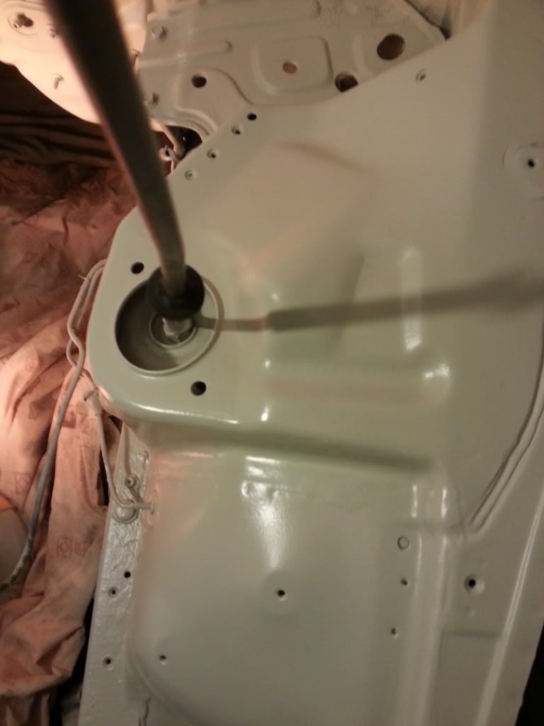

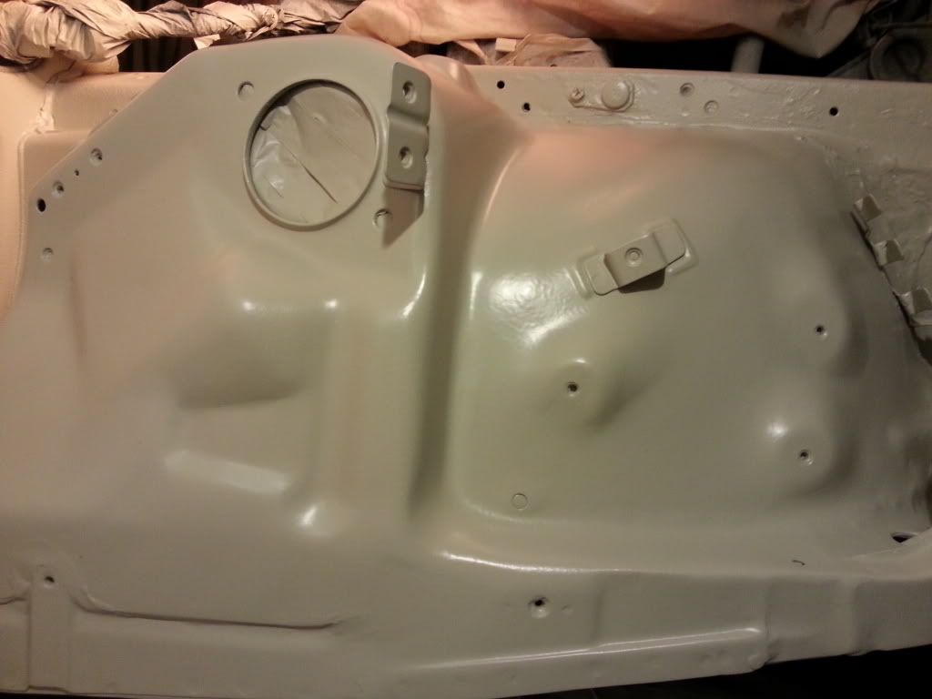

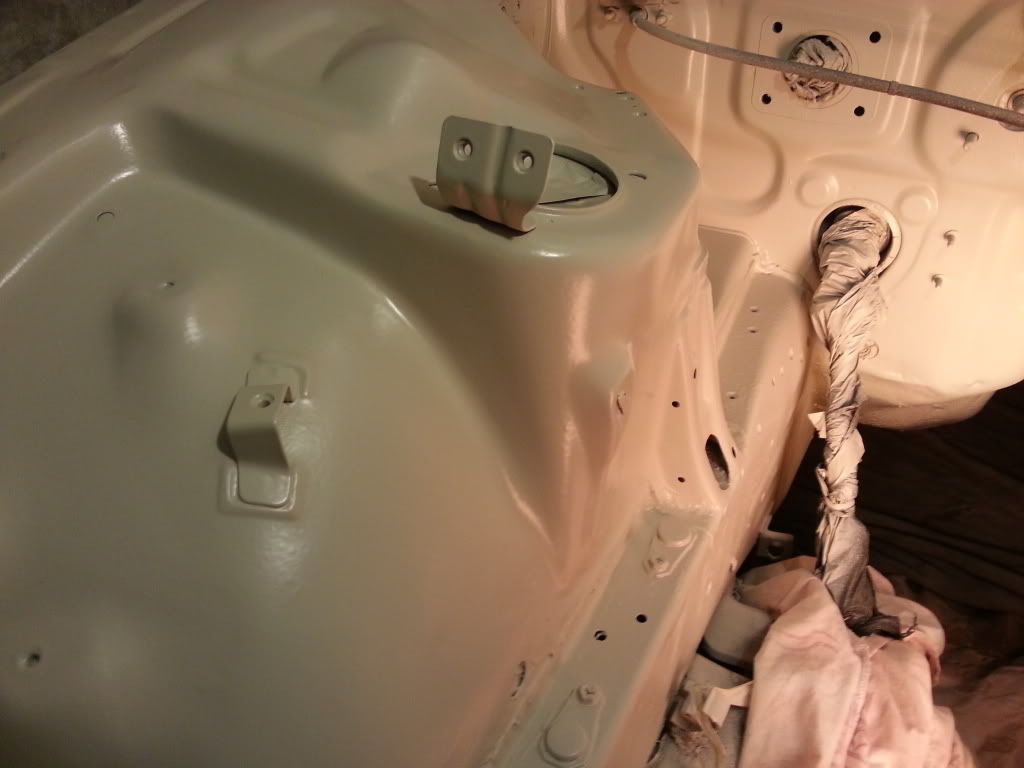

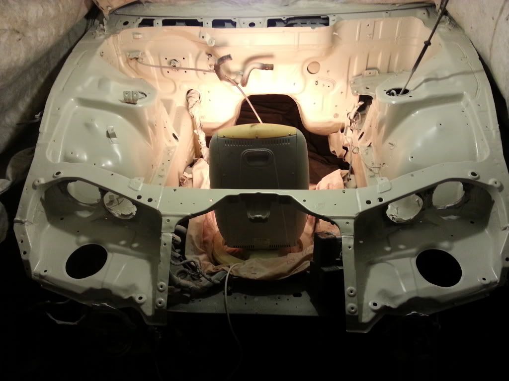

Hi guys I got the engine bay in primer tonight made a little shelter out of a car cover lol, a little electric fire and all went quite well.
Had the fire on till started spraying then when finished turned fire on again...

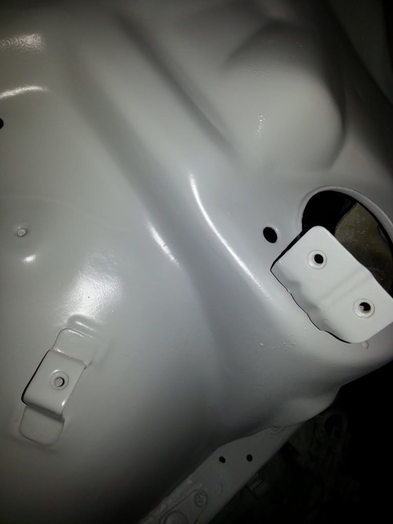

Drivers side looks great passager side is ok but not perfect where seams are.
Couple pics..
Now gotta flat it all down, for top coat.
Cheers for looking.

I hope it comes out well, I work on cars for a living but mechanical all this body work stuff is horrible and this engine bay is holding me up I wanted to paint the engine bay at home cause now I can put the engine back in and drive it to brother in laws work for respray,
Rather then tow trucks and the chance of scratching wings etc putting engine back in..
By spring it will all be done and I can't wait lol..

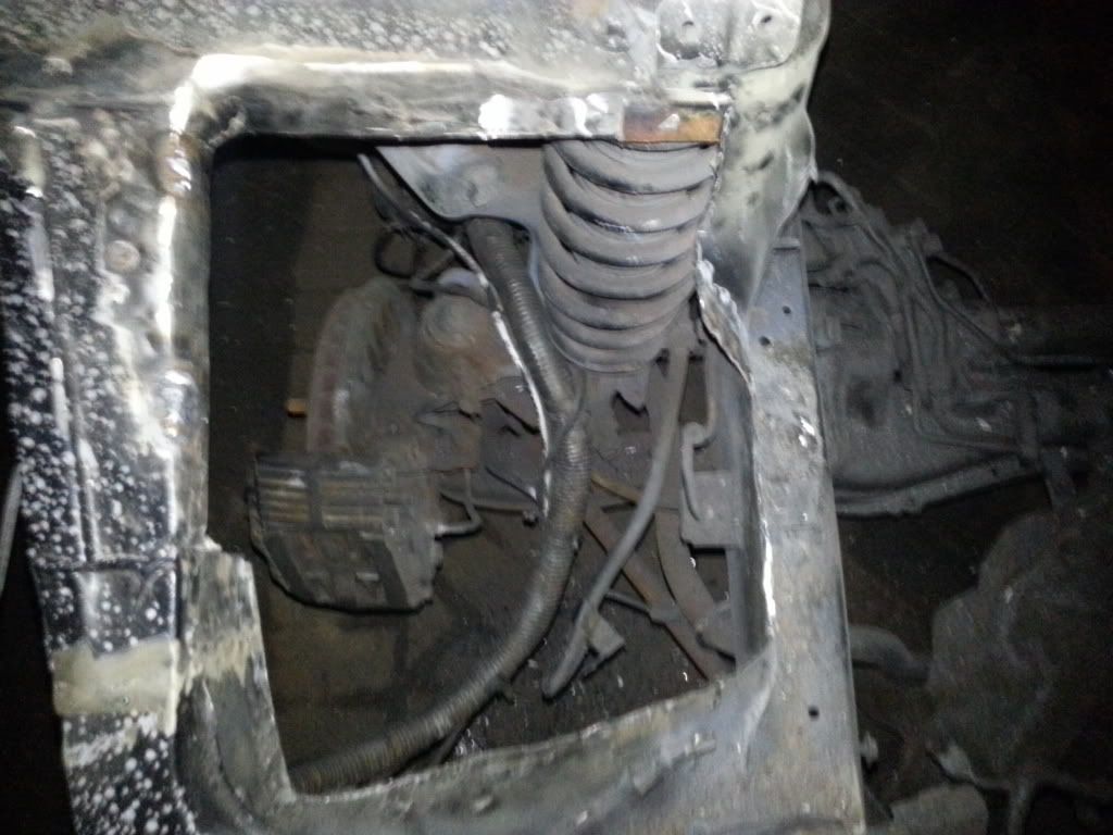

The 2 main chassis rails either side of bay I stone chipped that's why it looks really bumpy I'm hoping it will protect it a bit better down there..
And where battery tray is and opposite side is stonechipped,
