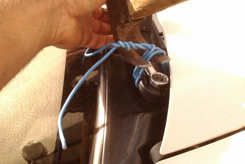

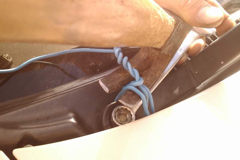

There is a bodge it option for fellow cowboys out there!
Loosen the nut, but leave it on a few threads.
Leave the spanner on the nut.
Wrap some wire of some sort around the spanner and wiper arm.
Lever against the spanner using a hammer or crowbar.
The nut has a lip which the spanner sits on.
It needed a fair amount of force, but it worked a treat for me.
Ahhh, like what you've done there! I've managed to get the front off after lots of messing around and swearing and blah blah but the back isn't budging. Once it stops raining I'm gonna give this a try.
