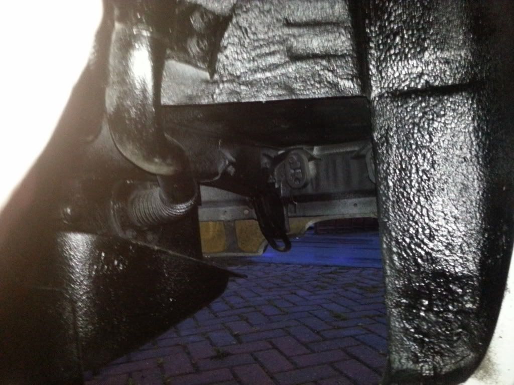

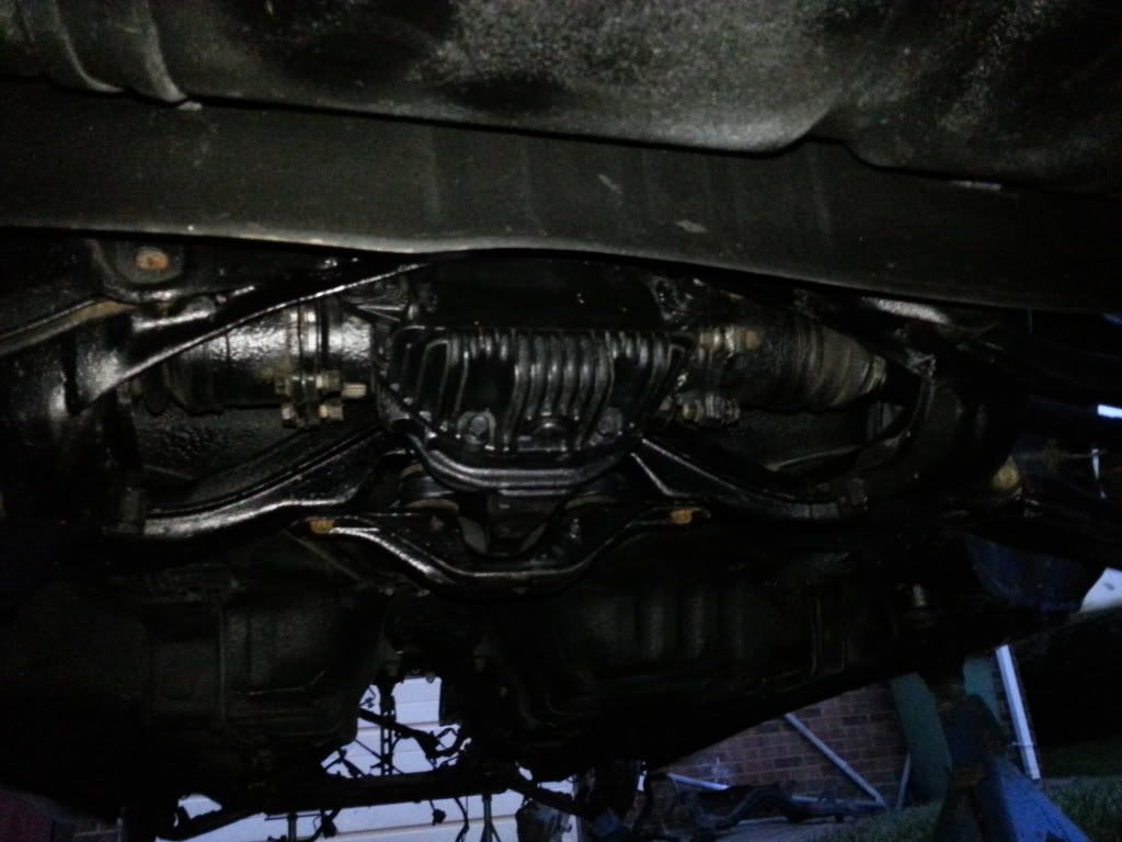

Hi guys done some more bits to the zed,

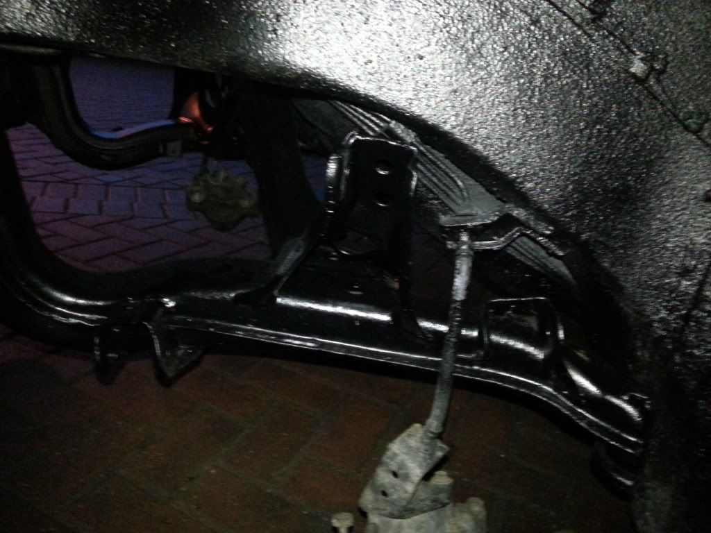

Painted:

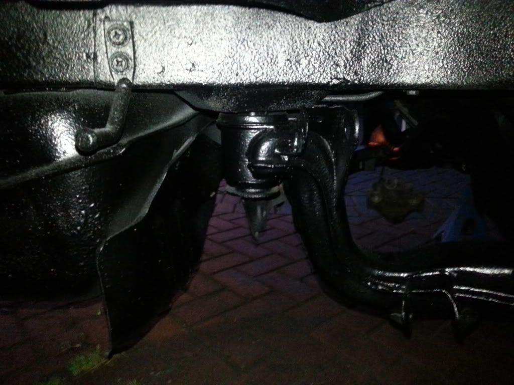

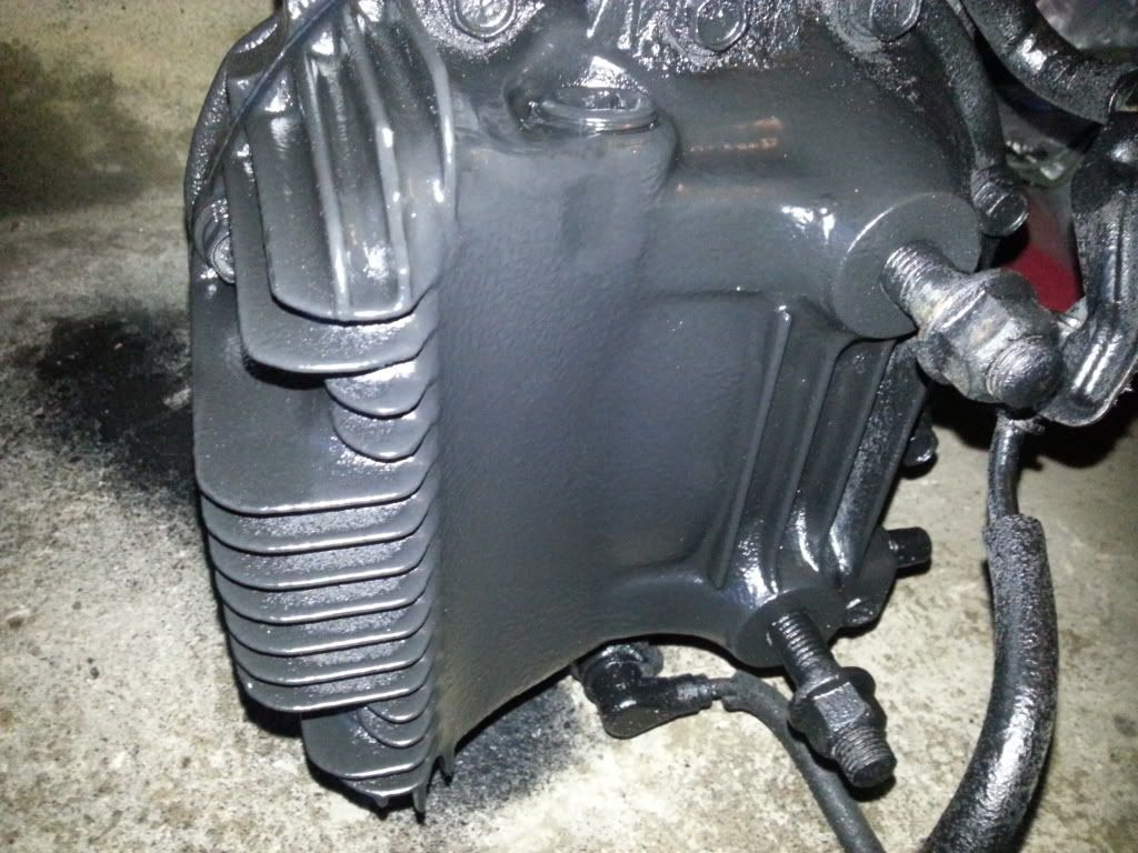

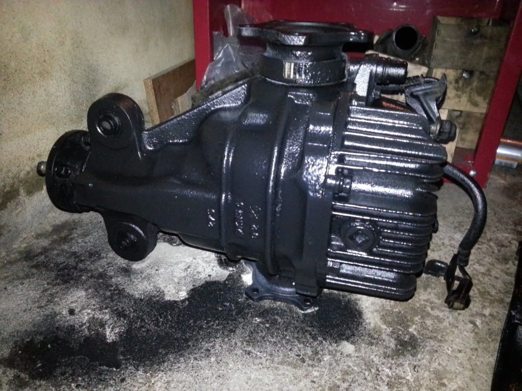

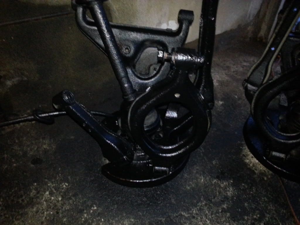

suspension arms

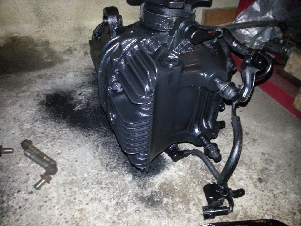

Diff

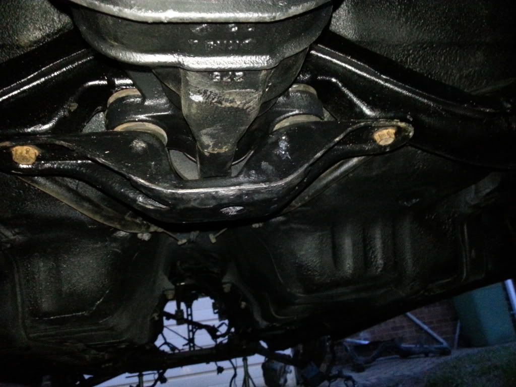

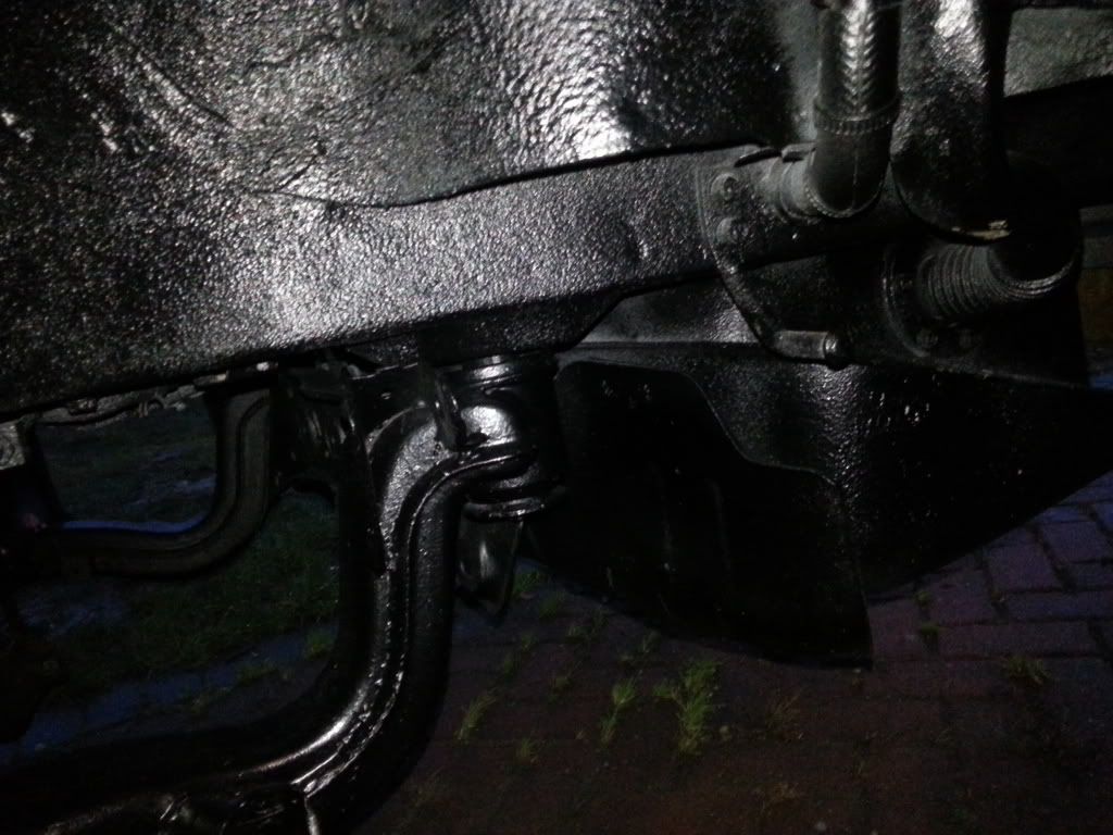

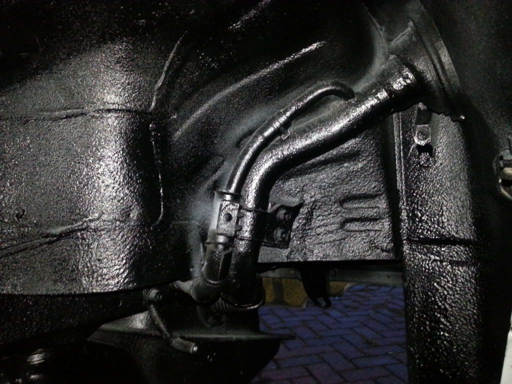

And finished off underneath

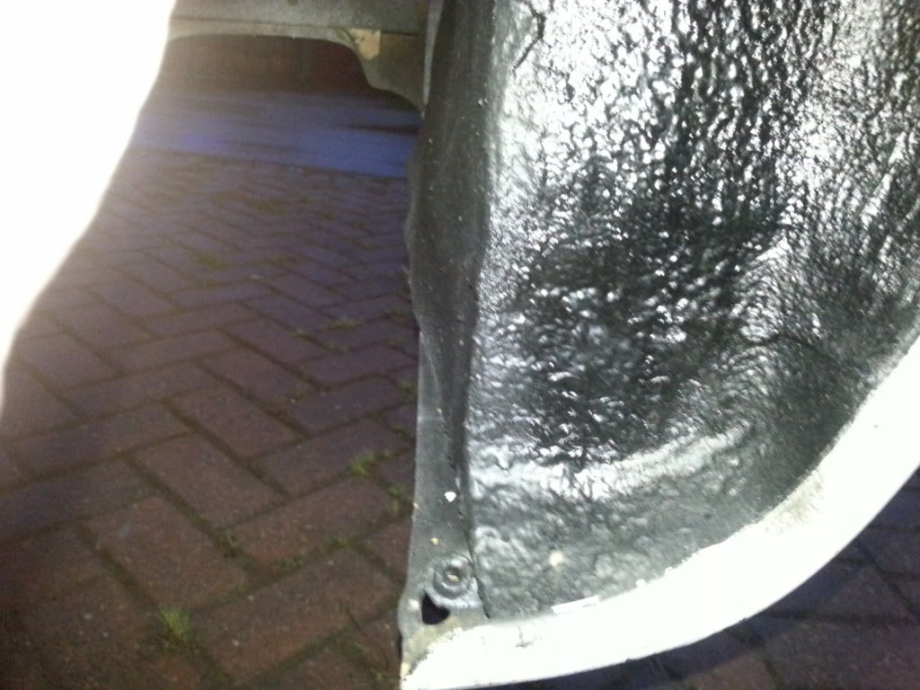

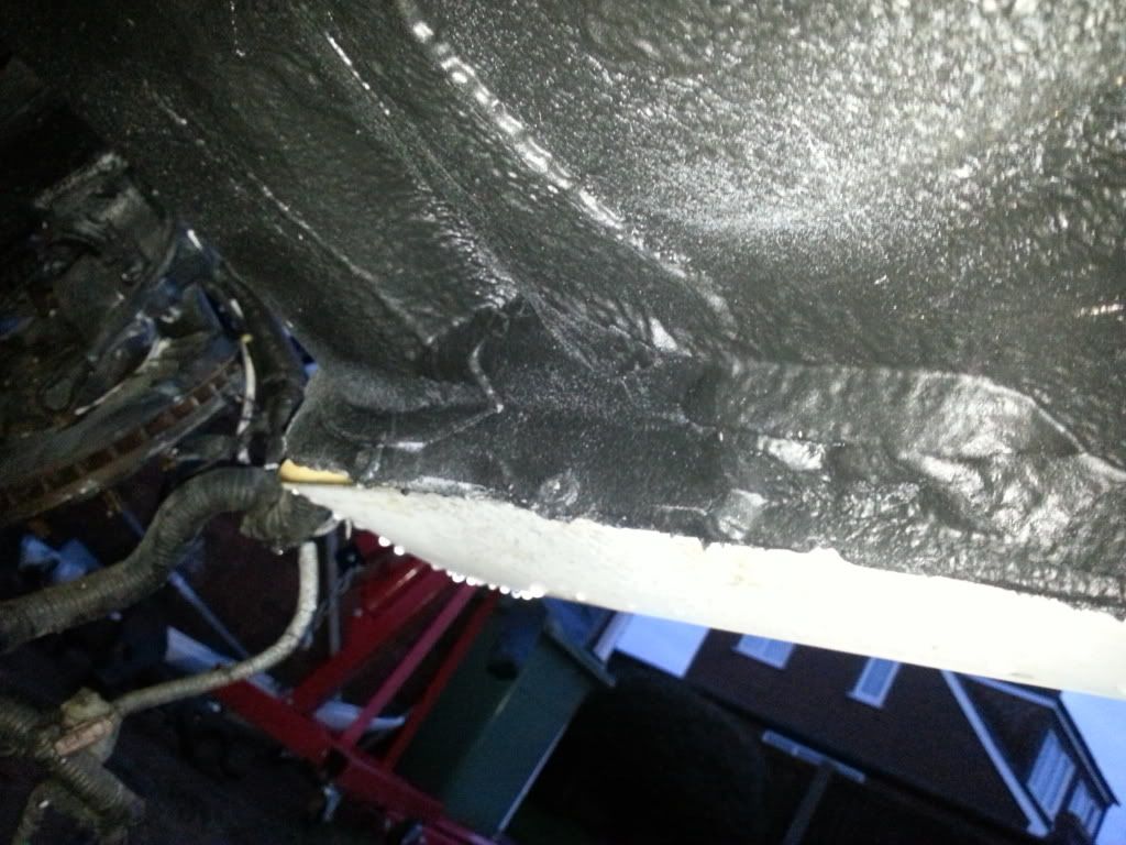

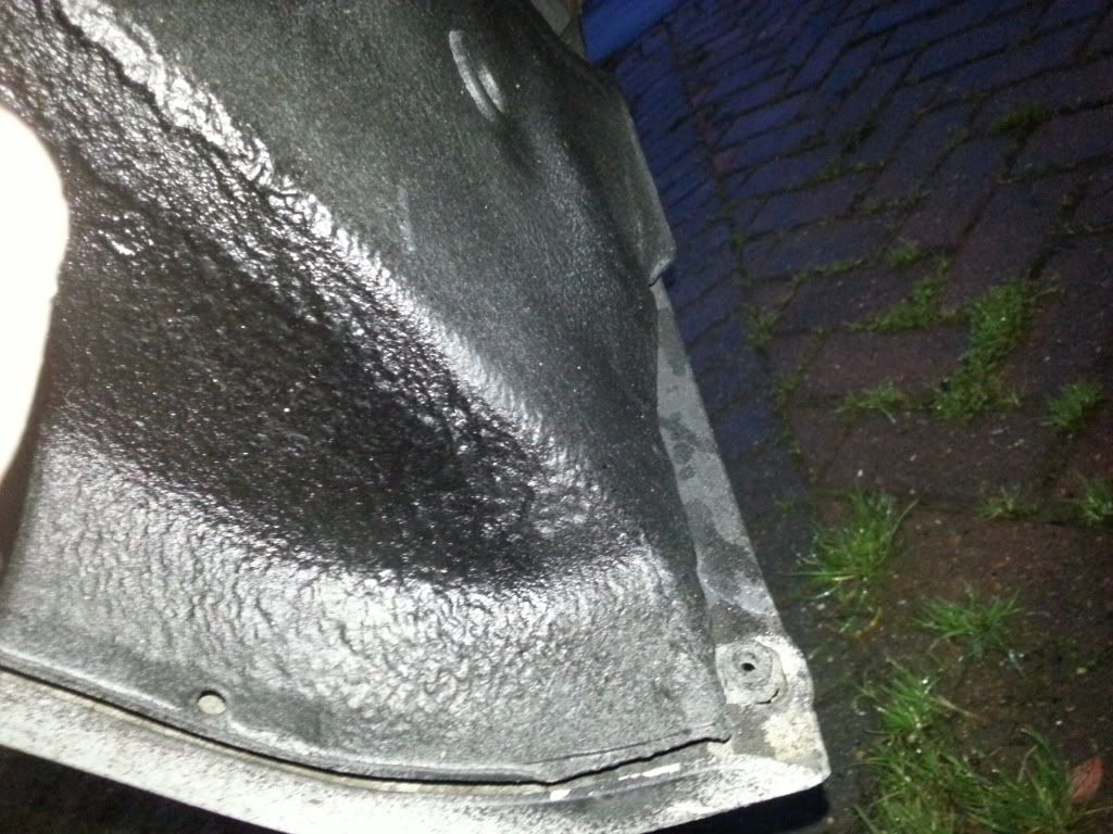

Underneath is dinitrol stonechip so not ment to be a nice finish, just black and bumpy lol,
But should protect it, I hope.
Even the diff is painted in dinitrol stonechip unsure what it will be like I'm hoping it's ok and shouldn't chip off.
Not going for show finish just want it clean and protected.
Lots of pics lol...

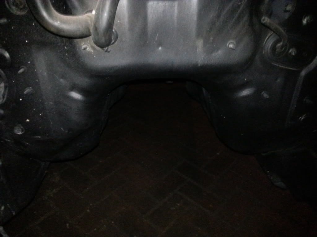

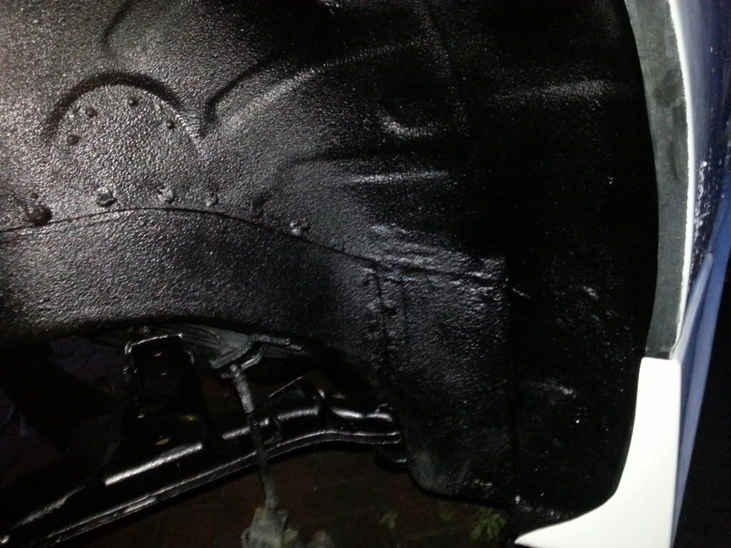

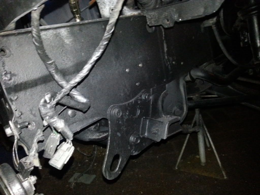

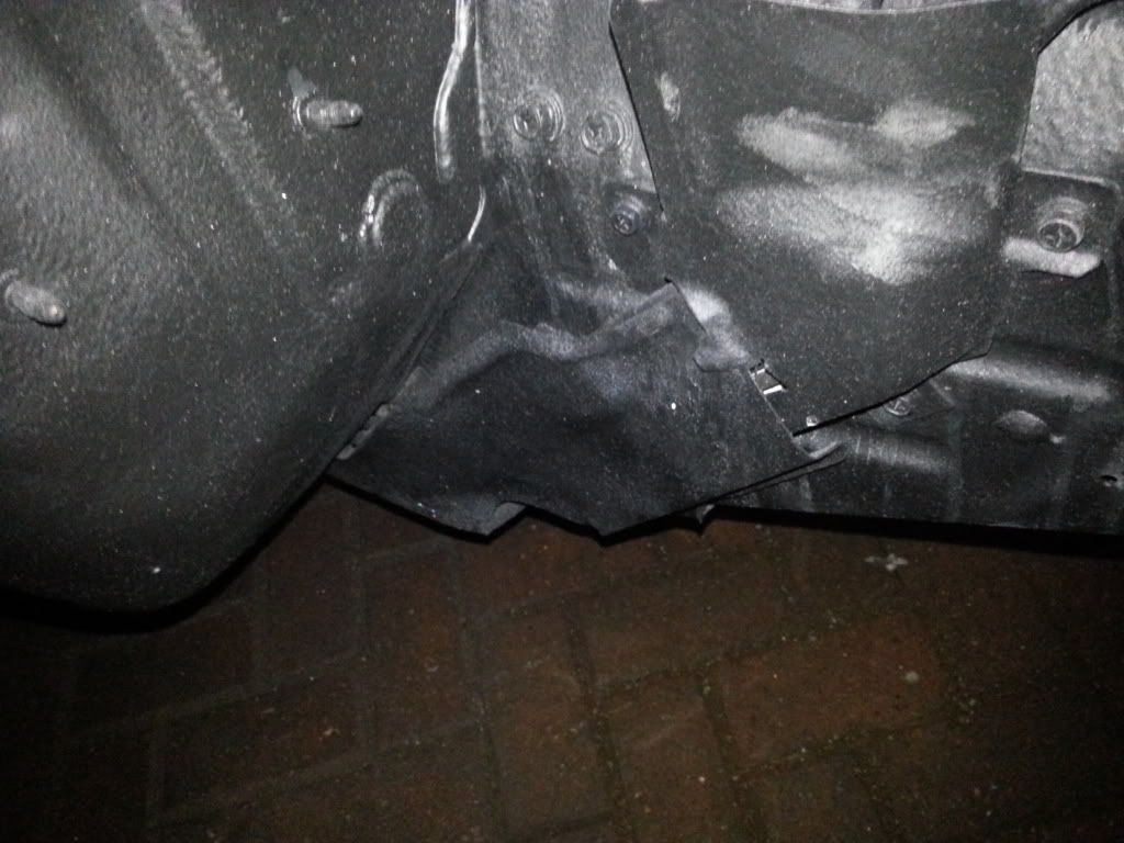

I dinitrol stonechipped the tunnel for gearbox and carried it on into the engine bay too but lower down where u don't see cause the finish will be a bit bumpy will over paint it white and should protect it more.
So have stonechip where battery tray goes and the opposite side and the front of fire wall.
And along the box section either side of the engine.

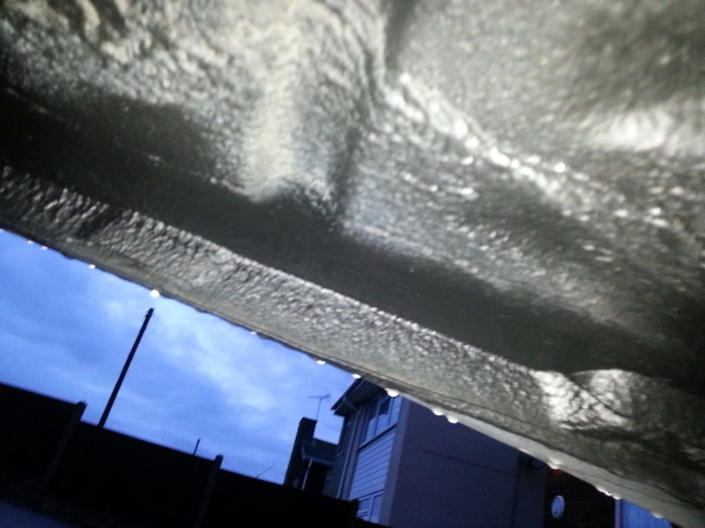

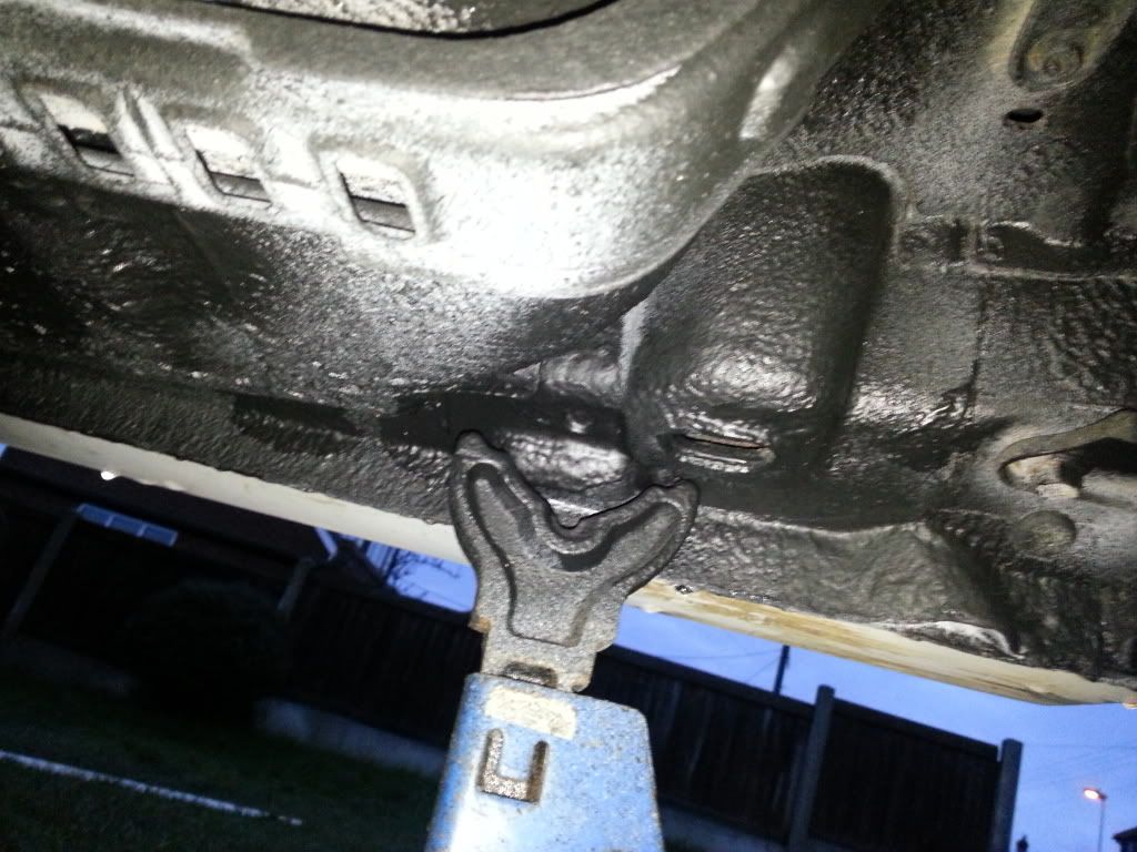

Looking good matey,
I did the exact same underneath looks so much better when done doesn't it
The pics make it look crap my phone flash reflects off it,
But when u look at it in real life it's just black and clean.
Glad I did it, laying on my back underneath spraying is a fun and dirty job lol.
Got the other dinitrol cavity wax too.
Should keep her clean for a few more years, it had better anyhow.

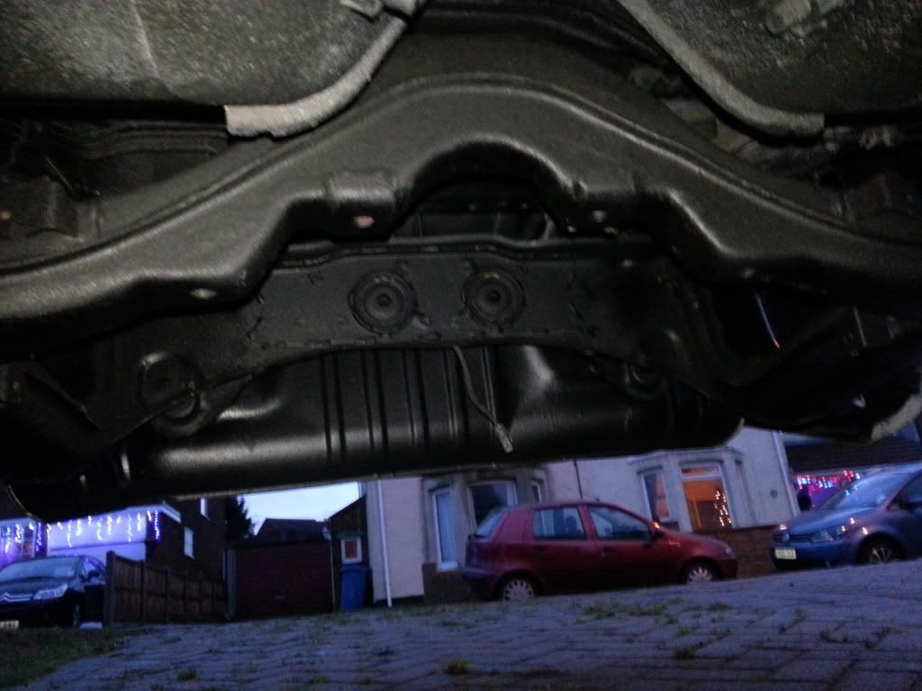

Got home at 2 and put me diff and suspension back in place,
Has said it don't look pretty but it's tidying it up and protecting it..forgot to paint the bolts so the look rusty gonna take them back out wire brush them and paint them.
