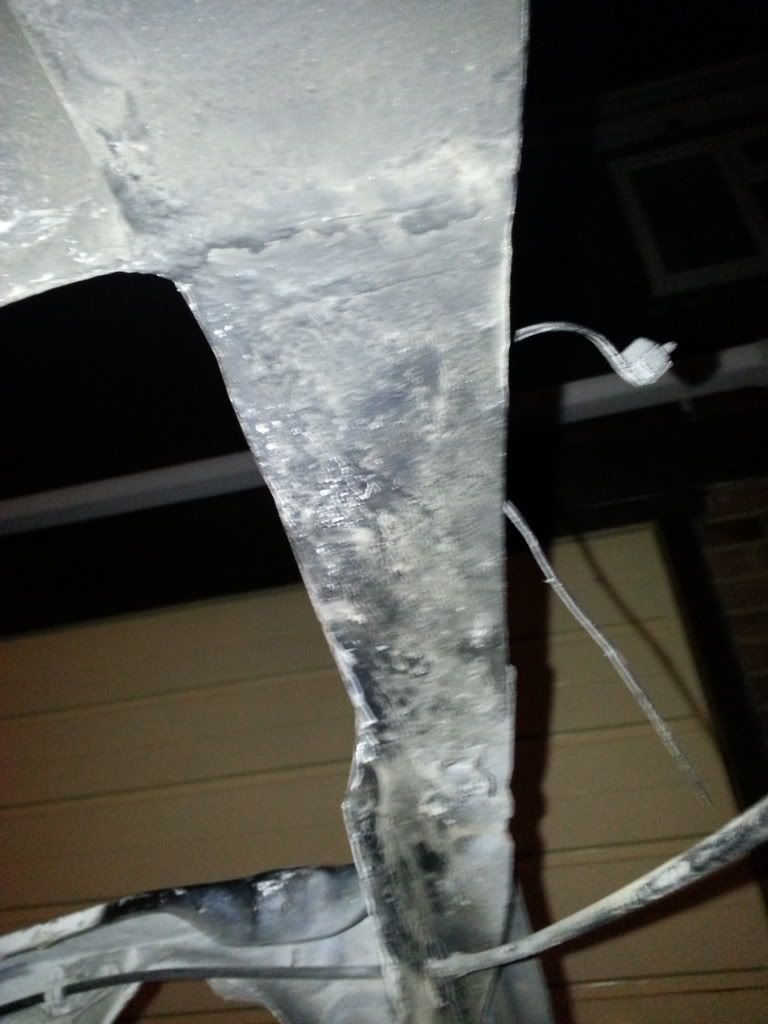

This is what it looked like when I done it
I painted it black and used some seam sealer on it all over the welds to stop it rusting till my next day of today and then when trying to grind welds flush metal around welds got thin and cut the whole lot out again.

what welder are you using and what shielding gas is it...look to me like you dont have enough amps and the wire feed is too fast mate...it just needs small hot fast spot welds on silver steel and then you wont get the weld build up you seem to be having.For grinding back you then need a flap wheel instead of a disc as they are to aggresive i think...BTW i use couger light gas from air products much much better than CO2 that pubs use..No its far from ruined mate..LOL

In the pic welds look big cause put seam sealer over them to protect till my next day off

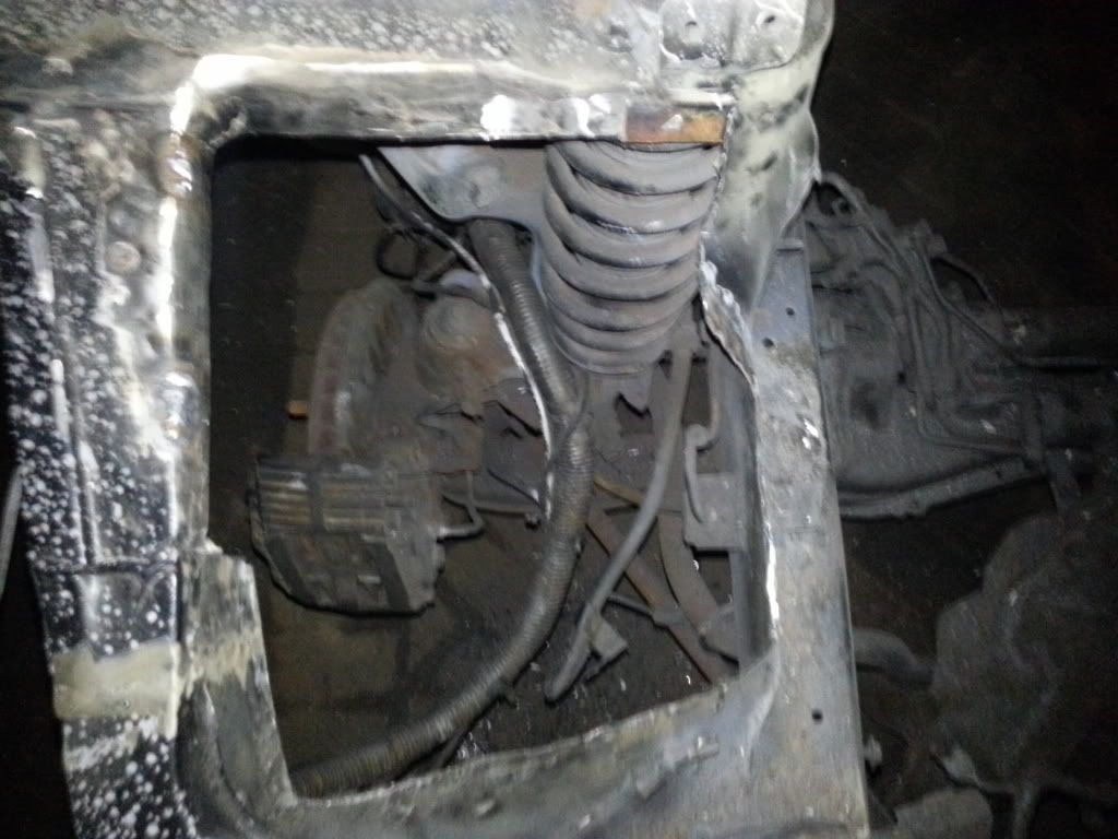

Fixed the box section bit like this
So box section bit is back in and ok now,
And posted wrong pic hole is bigger then 1st pic
With the hole this big is it still fixable.
Please say yes
Also bought 40grit flap disc today, that's where I went wrong, my father in law keeps saying weld and grind flush so don't need filler,

It was fine could have put a skim of filler over it and now I ruined it trying to get welds to look like it ain't been welded.
Now I need the bit I cut out my spare zed again.
And have nothing to cut it out of, and not very good at fabricating the shapes.
With the hole this big is it still fixable.Please say yes
yea just take your time and dont try rush the template as the closer the gap the less wire you need;)...that Cebora is one of the best but i still think the wire feed is to fast looking at one of the pics
Your more then likely right I'm ok welding thicker stuff but the tin foil zx is made of I'm useless lol
Looking on the net for a mobile welder, I have no chance making that plate now,
Hole is getting so big I dare try it anymore.

I had metal in my eye, and got flashed about ten times from welder, to end up with hole bigger then I started with after 6hrs in the bloody cold.
I wasn't amused could have set fire to it.
If it's still fixable I ain't so stressed now I'll call someone into do it,
