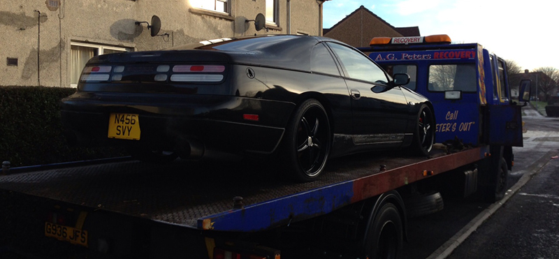

So my zed got lo loaded this morning and shipped off to get its alignment done; it was scary putting it on the loader
as we had to use planks as the front bumper would have badly scraped if we forced it on so after the front wheels were
on we raided the platform and slowly drove the rest of her safely onto the ramp.
It was very chilly this morning so took a bit of persuasion to defrost the old girl.

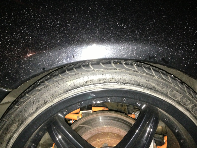

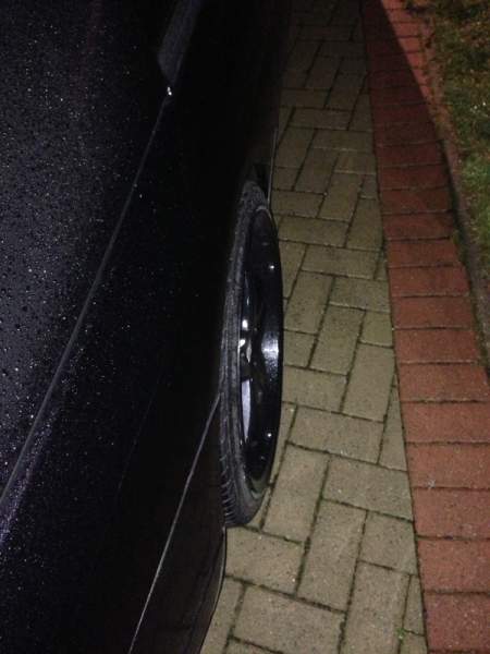

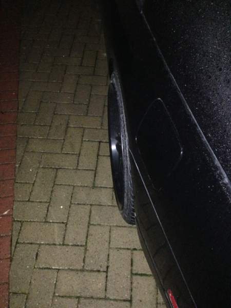

Just got the zed back from the garage and all was good, thoroughly enjoyed the brisk 5 min journey back to the work.
The alignment in the end cost me £160 as they had to fix a few extras on the way but i'm more than happy apart from
a small adjustment on the rears in that the ride height is way to low for the wheel arches.
About 1cm or close to it I would say so a tad rubbing when the average bump comes along.
Just need that fixed by raising it up a bit and I can move onto the bodywork.
I'll post up some pics shortly as I love the new profile I've got with the body of the zed.
You should have had that done at the alignment centre cos if you alter the ride height now it will change the camber and the toe in, thereby defeating the object of the exercise.
I realise that but i never noticed how low it was at the back until after i took it home.
I have the option to get the rear arches rolled for £80 but not sure.
What would it look like ?
Rolling the arches is invisible from the outside if done properly. Cos its the return lip that is rolled. Both my car and Bobgenies slicktop have rolled arches. Check out some pics.. Ive posted more than a few!!:yes:
