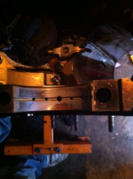

What do you think to the condition of the bearings?
All original part numbers can still be seen clearly also can't feel or see any scoring ect

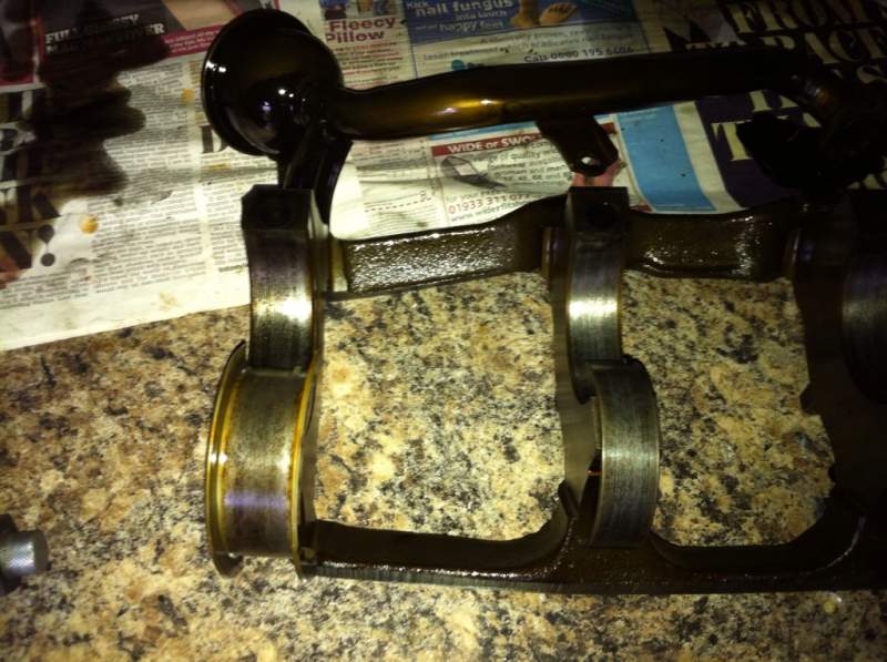

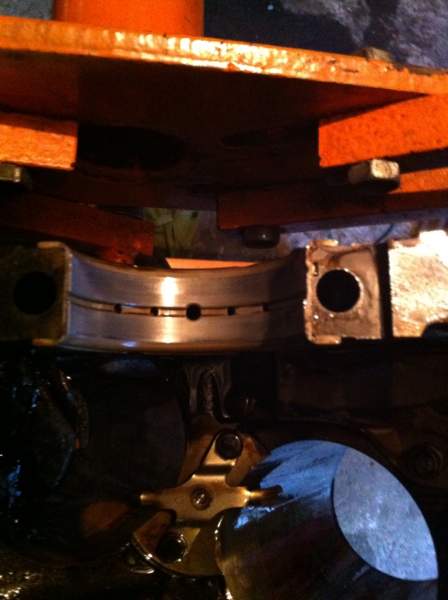

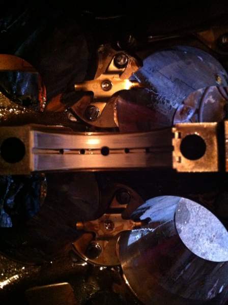

Main bearings
the main bearings are worn but nothing drastic ... 1st bearing looking the worst thats kinda strange as its the first one on the oil dist tree
crank looks to have little pick up specs ... but that can be polished out anyways

What do you think standard sized or reground?
if the cranks ok and dials up and your on std then ide re-shell with std...thats what ime doing with mine plus its pointless showing the cradle under the shells imho as they all seem to look the same marks from engine to engine
Edited by znut
there all fine no scoring marks ...
Just use std shells and clean/polish the crank
Post 8 pic1 ... thats worn few more thousand miles and that prob be knocking
