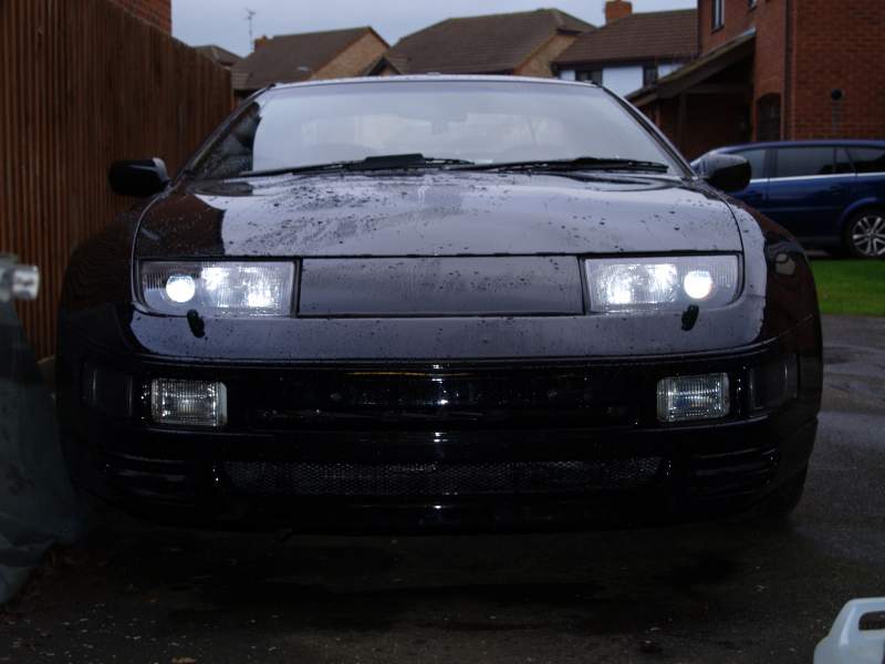

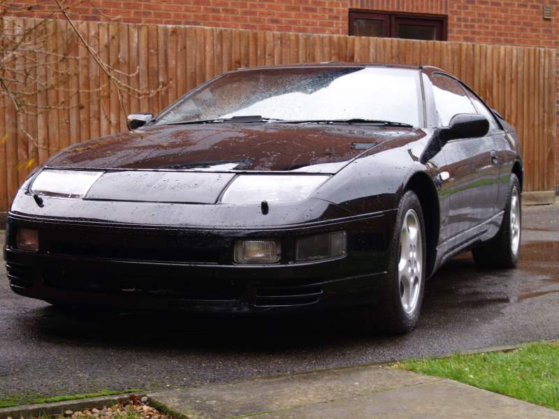

The bonnet should follow the curves of the wings all the way from the top to the headlights. Like the pics below
I can't give much advice on getting it right though as the body shop did mine.
HTH

your car looks like it is the same height, the bonnet and the wings. so hard to see in a pic.

lol, no problem bud. Yeah, the wings and bonnet are the same height, sorry about the pics. I'm crap at taking them..
Its not your pics, they look good just cant see it properly in a pic looked at every zx on google images and cant see what im looking for lol.
