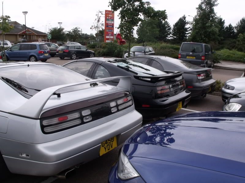

Check this out-I´m a bit confused about this; got this pic from ZNATIONALS, rear 99 spec lights,
Maybe is just my imagination but does anyone noticed that both upper and low are whites on the first Z? confuses me
cause on other rear 99 spec lights Z, upper is red and lower is white...like the green one.
attached you will see what I mean; take a look at the first Z and the second; don´t you see a difference
on the lights? first I thought maybe they also have the spec 99 lights in both white..but now I am lost or perhaps is just my imagination.

Im pretty sure the Top set are standard 99spec lights ands its just the lighting and angle of pic.
The version on tomomontana car are converted 89-98 stock lights. You take them apart and repalce the coloured lenses with the clear perspex strips.

MMmm now that you mentioned I am beggining to think they are the 99 spec lights, just from a different angle and light.
yeah, agreed...
but you can have a conversion done and put a clear lens over a red one giving you that look from any angle.

If you look carefully you can see the red in the top pic. Those boys like their neg camber and low dont they.

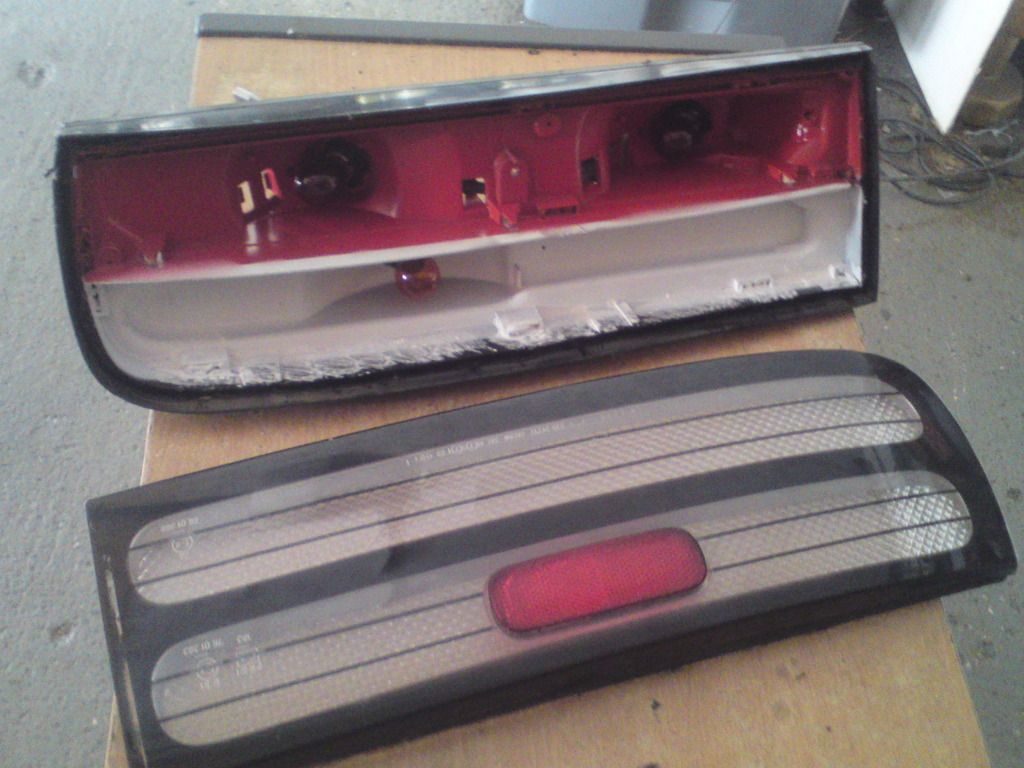

this is the set I'm currently doing for my car.. it will give it the look of the car at the top, with a clear looking finish at some angles...
I've put led strips in it to compliment the led bulbs that will go in the standard holders. (if it looks crap they'll be coming back out..lol..)
lenses held down while silicone hardens.
the red lens is to go in now.
Almost finished..
pic of lights pre-assembly but ready to go back together..
LED strips (without the normal bulbs)
so I'm king of happy with them and I'll be going ahead with them....

All ready for assembly, both lenses match this way.
And below the one nearest the camera is this different way, the other still as the original red lense in it with just the lower amber one replaced with a clear one :biggrin:
