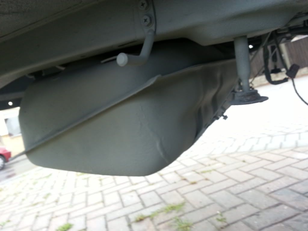

have everything from under car stripped off subframe, fuel tank the lot so thought I'd spray it all lol,
it's in my hair and everywhere so it had better be bloody worth it lol.

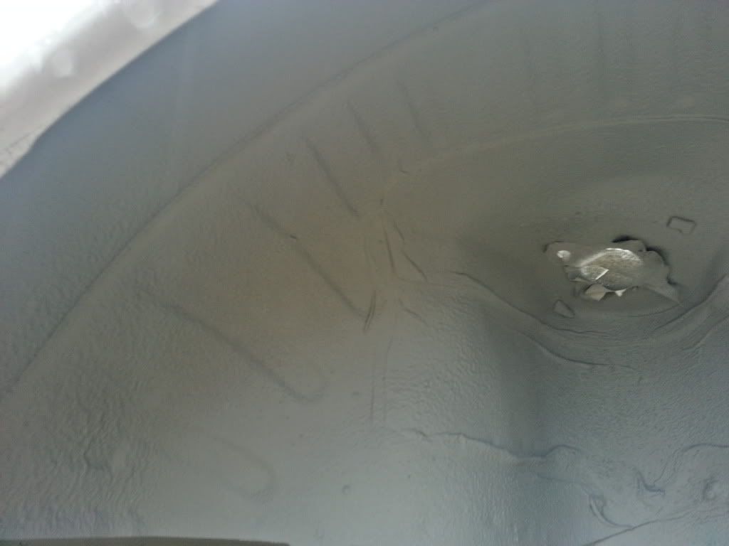

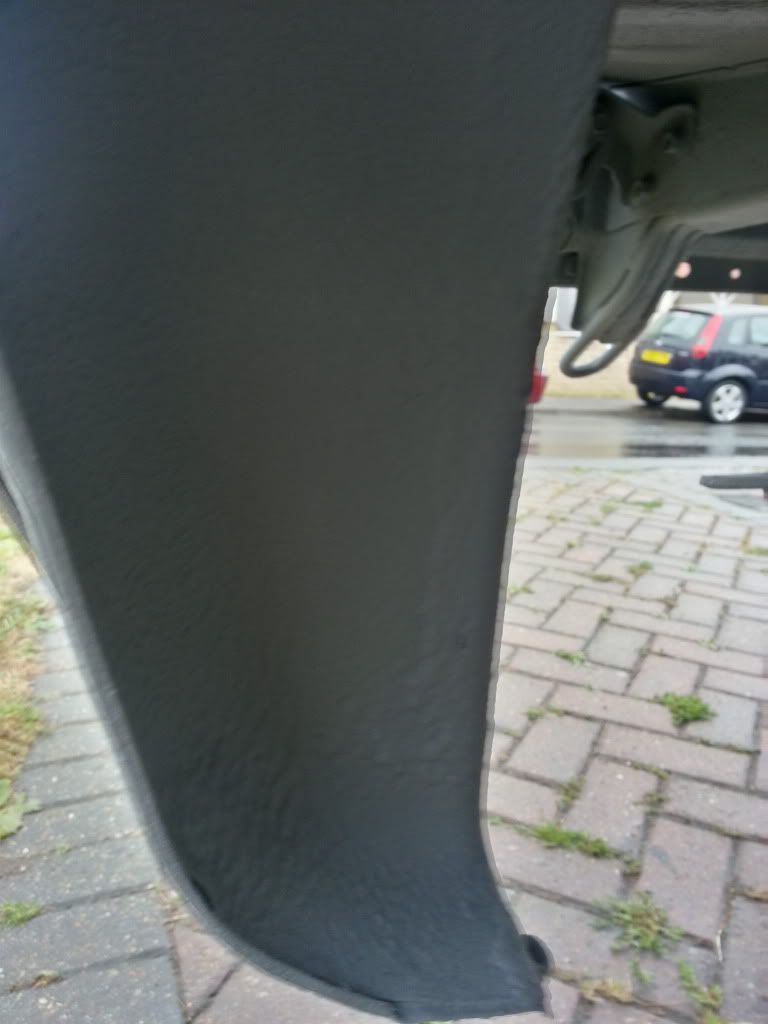

sprayed rear arches, back end of car fuel tank, tunnel either side of tunnel and have one can left of stonechip hoping it will do front arches and any little bits left or may have to buy one more can.
It's over paintable, but I have the grey and it looks really good, don't think u have to paint it wondering whether leave it grey,
do u think it will look bad in few weeks when it gets dirty.

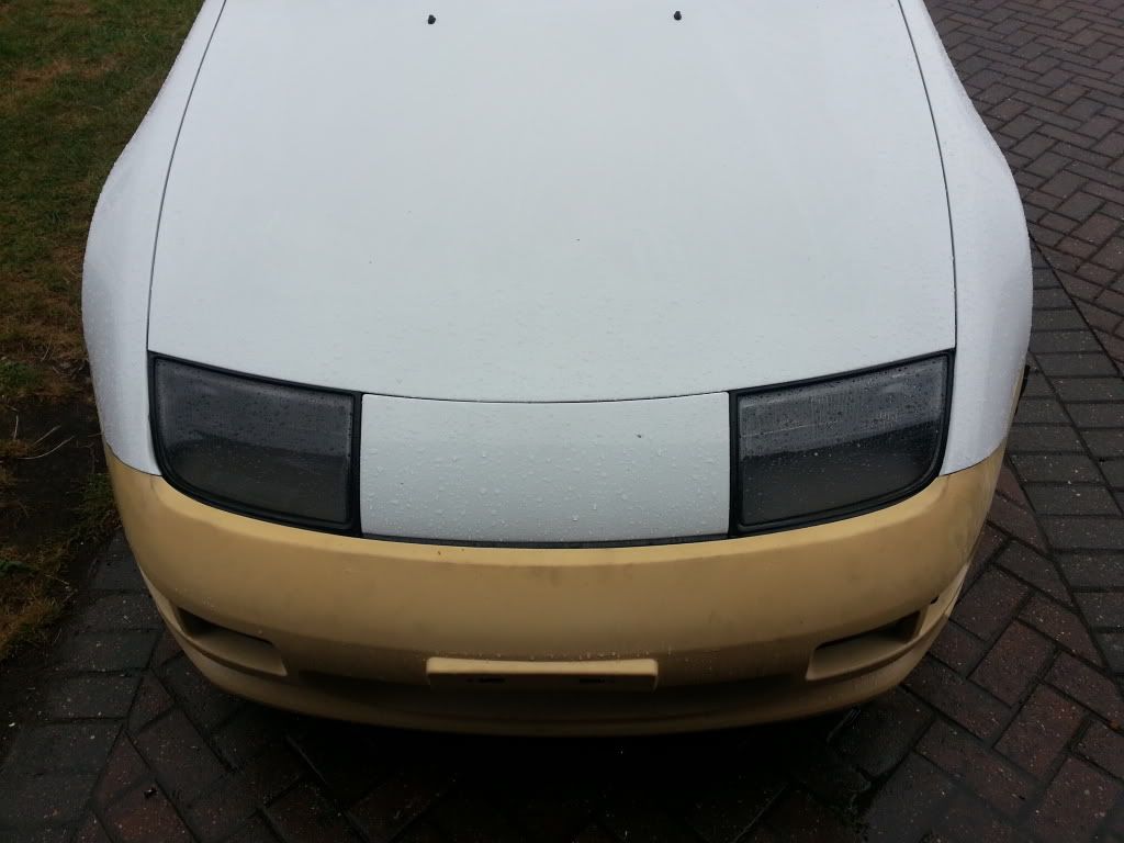

put my new 99spec bumper on not painted it yet, trying to get everything perfect fit before painting the whole car.

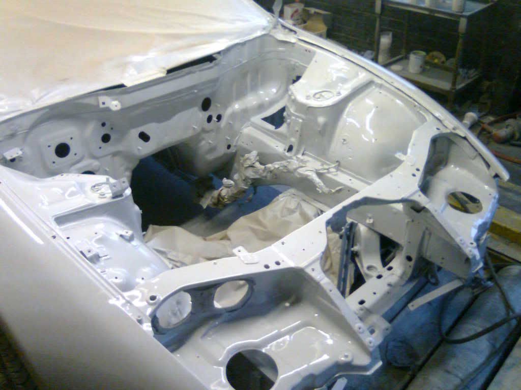

Still gotta take engine out to paint engine bay, reshelled my uk car couple yrs back painted the shell everywhere was like a new car and then master cylinder leaked and took all my new paint off.
Why engine is out gonna rebuild it and get new ball bearing tubs.

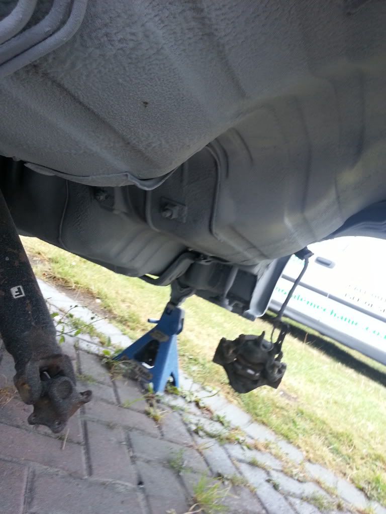

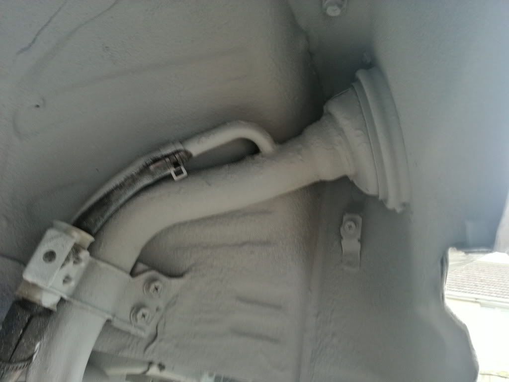

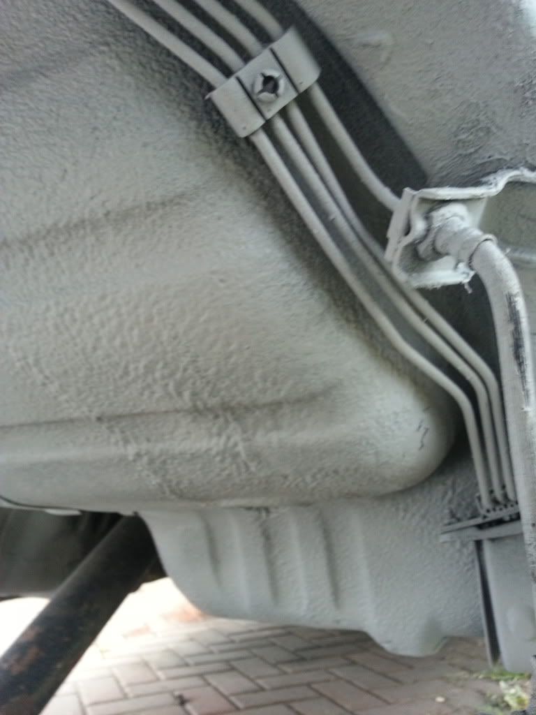

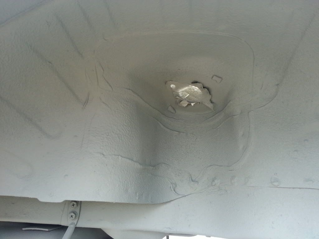

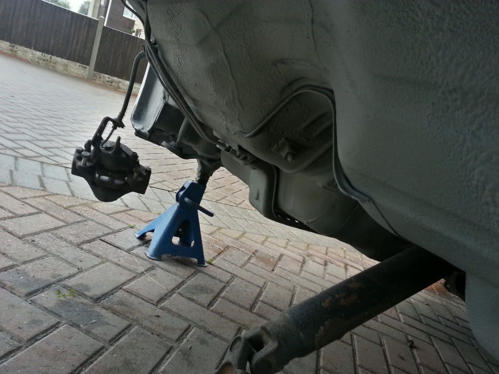

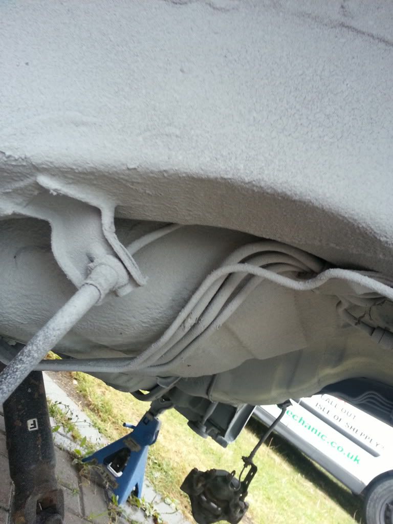

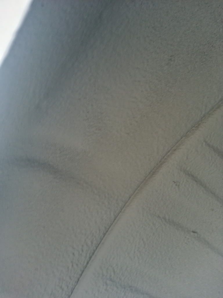

hi guys few pics of dinitrol stone chip,

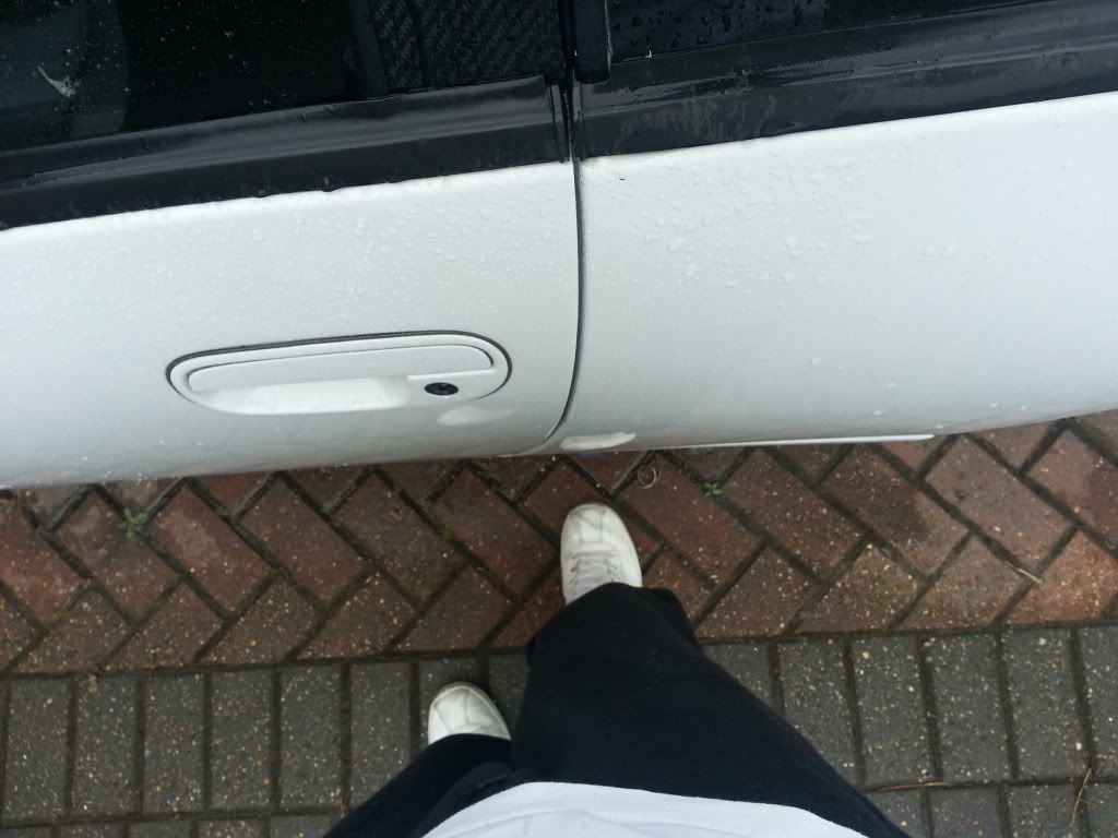

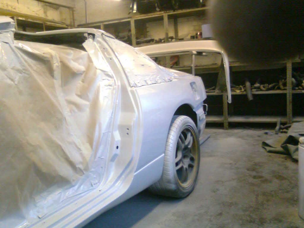

how the doors look after aligning the stupid things lol they were a bloody nightmare, i think they close better now flush and level. i know i have issues lol.

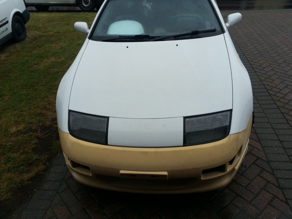

and my new 99spec bumper, its not painted just getting everything to fit right before taking everything apart to paint the car.

do u think it will be ok to leave stonechip this colour or would you spray the bottom black, let me know what use suggest im lost.

couple pics of how it looked before i played with it....

Stonechip looks really good and looks like you have been mega thorough! Did you do all around and above where the tank sits and was it a big deal to get the tank off? Does this stuff just stick to the old underseal?
just undone bolts that hold the straps holding tank up and lowered tank on a jack sprayed above put tank back up removed jack.
i had subframe off, which made it easy to get in everywhere subframe only takes about an hr to remove on mine anyhow.
yep over what was there jet washed bottom off, then in arches got a rag soaked in thinners gave it a quick wipe round and sprayed the rust remedy primer stuff what came wit kit, then spray stonechip everywhere it everywhere. if it was rusty i would wire brush off has much has possible first then treat it.
still what do u reckon on painting it guys, or leave it grey.
Leave it grey, waste of time and money painting it imo
