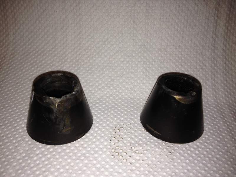

After having issues with my front wheels and the noise i decides to call driftworks and sent them an email picture of my setup.
Cleverly they spot the issue straight away and it turns out when fitting the new front and rear lower arms i never used the wee
tappered colar that apparently comes off the old oem arm - well nobody bloody told me did they !
Good news was the old arms were still lying out the back for the fronts.
Bad news is i chucked the back wishbones away over a month ago.

Well second attempt was today and i made it all the way to see Jim!
Found what i needed and with the help oh him we used a torch to cut at the bits required.
Got back just before 8pm tonight and set about the zed with a torch and some spanners with very succesfull results.
Only managed to work on the fronts tonight but i believe the backs are strong enough to get me through the mot then
tomorrow after work i can again insert the bits needed on the rear hubs.
In the end these two wee buggers below were the cause of all my troubles :
