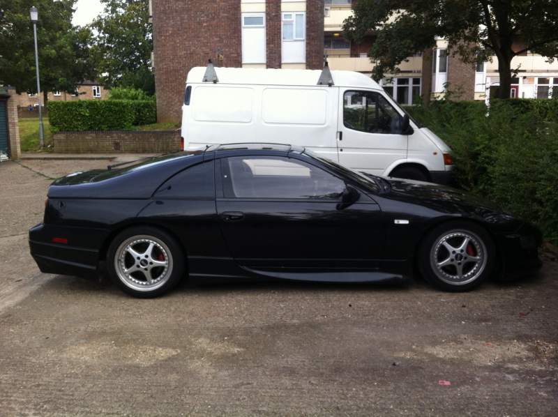

[sIGPIC][/sIGPIC]
And wher the pictures?
[sIGPIC][/sIGPIC]
