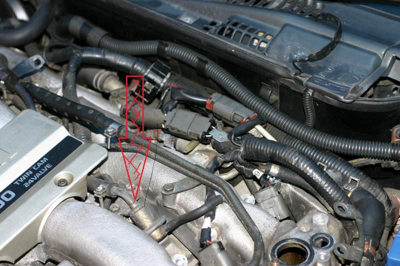

Ok bit of an update, and thanks for all the previous help :)
so, I`ve had a good luck round and can hear coming from the right hand fuel pressure regulator a swishing sound? when I tap it the swishing goes away and more of a hissing sound ,lol ..After tapping i tried to start the car and she fired straight away for a few seconds and then stalled? tapped again she fired and then stalled again, have I a goosed regulator?
Cheerz
Edited by daZvert
Just swapped the regulator from my TT and same thing so back to square 1 :(
