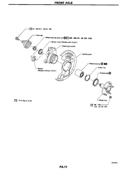

Probably go to 80 and see how that feels
Did mine at 88 when I fitteed the hubcentrics. Wanted them to be right.
Then you have over torqued them!
Most people over torque the wheel nuts by quite a large margin tbh, mainly because they can be tight to crack so people tend to use a breaker bar. Then understandably, to feel safe they want them done up tight so use the breaker bar to do them back up!
No lol upto 87 plus one for good luck. Or maybe cos my torque rench only does evens lol nm eh .

I’m just fitting my refurbed wheels and want to double check the 80ftlbs = 108nm? Bloody European wrench! :wink:
