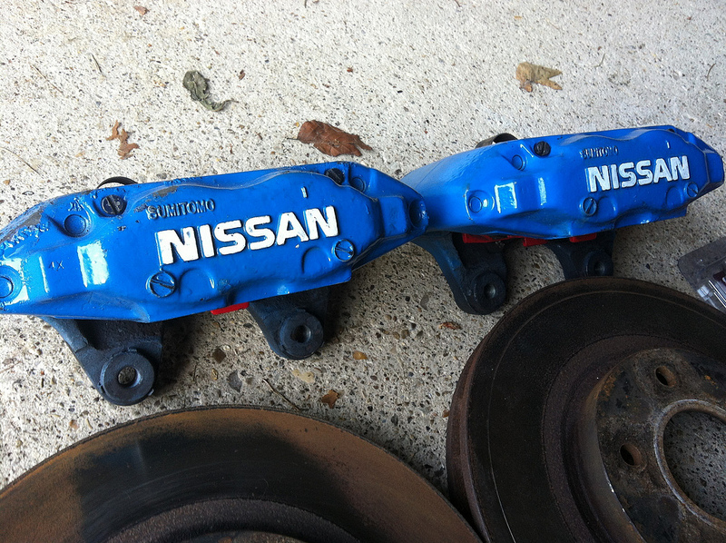

Is there any numbers identifing that they are r32 gtr cause the look very similar just want 2 be sure they are gtr ones
I'm not sure about the part numbers, if you post up a pic then I can see and tell
R32 and Z32 calipers look similar but they are easily distinguishable, these are my R32 GTR ones
