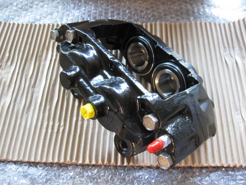

Anyway I recently decided to perhaps put the car back on the road and therefore overhaul the brakes. I removed the front calipers and indeed they were in a shocking state. At least 3 of the 4 pistons were seized. I had already purchased (2yrs ago:blush:) a rebuild kit so my intention was to rebuild them and fit new discs and pads. Despite my best efforts it proved impossible to remove the pistons despite using penetrating fluid, compressed air, various clamps and grips. Now I wanted to retain the stock caliper’s and I had already purchased the new discs and pads. My options were therefore to either purchase another set of calipers to refurb or send this set away.

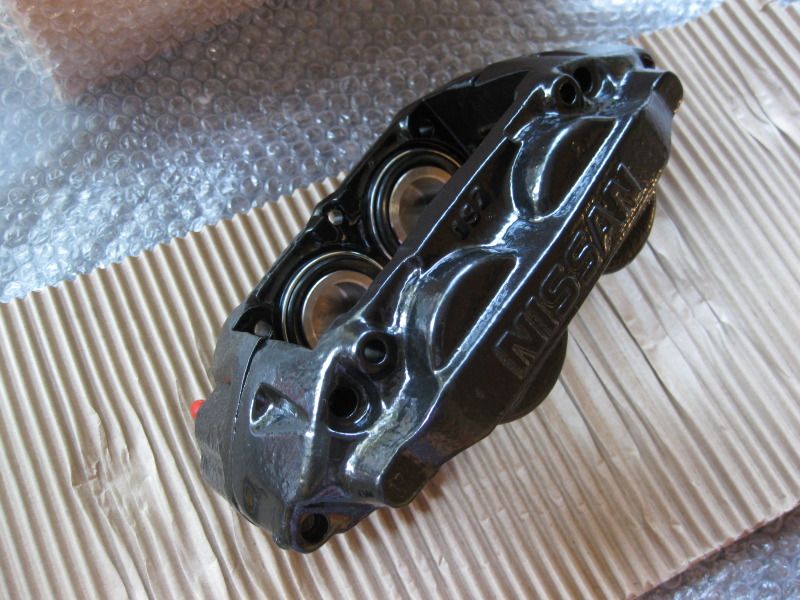

I decided to send my set to Bigg Red for re-manufacturing. They shot blast and completely refurbish the calipers using new seals, pistons, bleed nipples and then offer a variety of finishes to suit choice and budget. I opted for a polymer coating which is apparently resistant to rust, salt etc. They then pressure test them to ensure all is as it should be.
I received them back today. Unfortunately I didn't take any pics of them before they were sent away, but take my word they were awful. Look at them now.
Absolutely chuffed with them. So if anyone needs brake calipers re-manufacturing I can highly recommend Bigg Red :yes:

Bigg Red do the same but it is dependant on what stock they currently have. The 300zx pair they had in stock were finished in blue - I didn't fancy blue and as there was no rush I was happy to send mine off. For comparison thought they wanted £230 for those with £70 cashback.
Wow!!!! nice one Phil, they look like brand new :) nice to hear your getting your zed back on the road :)
Excellent job at a more than reasonable price IMO. Seems like a bargain in fact :thumbup1:

Word of warning on the Big Red kit - the outer retaining clips are useless and very flimsy compared to stock. I can see you have them in your pic - they are thicker but not as solid as the originals, I just cleaned up and reused the originals.
I actually emailed them about it and they asked what type it was (so there must be two outer retainers available) and they said they would look into it.
